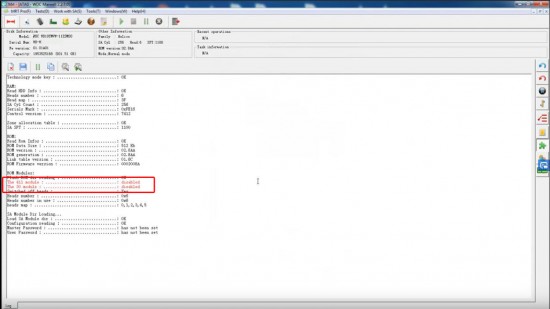

This bug consist of slow jumpings on bad sectors when cloning in DE with WD decryption turned on, even at very low timings set.
I made this video to be more clear:
https://youtu.be/GRM3hWcReC8
PC3000 behavies correctly when on fly decryption is turned on, MRT does jump bad sectors fastly only when decryption is off.
Please MRT, fix it soon as possible, i'm taking months for cloning this drive.

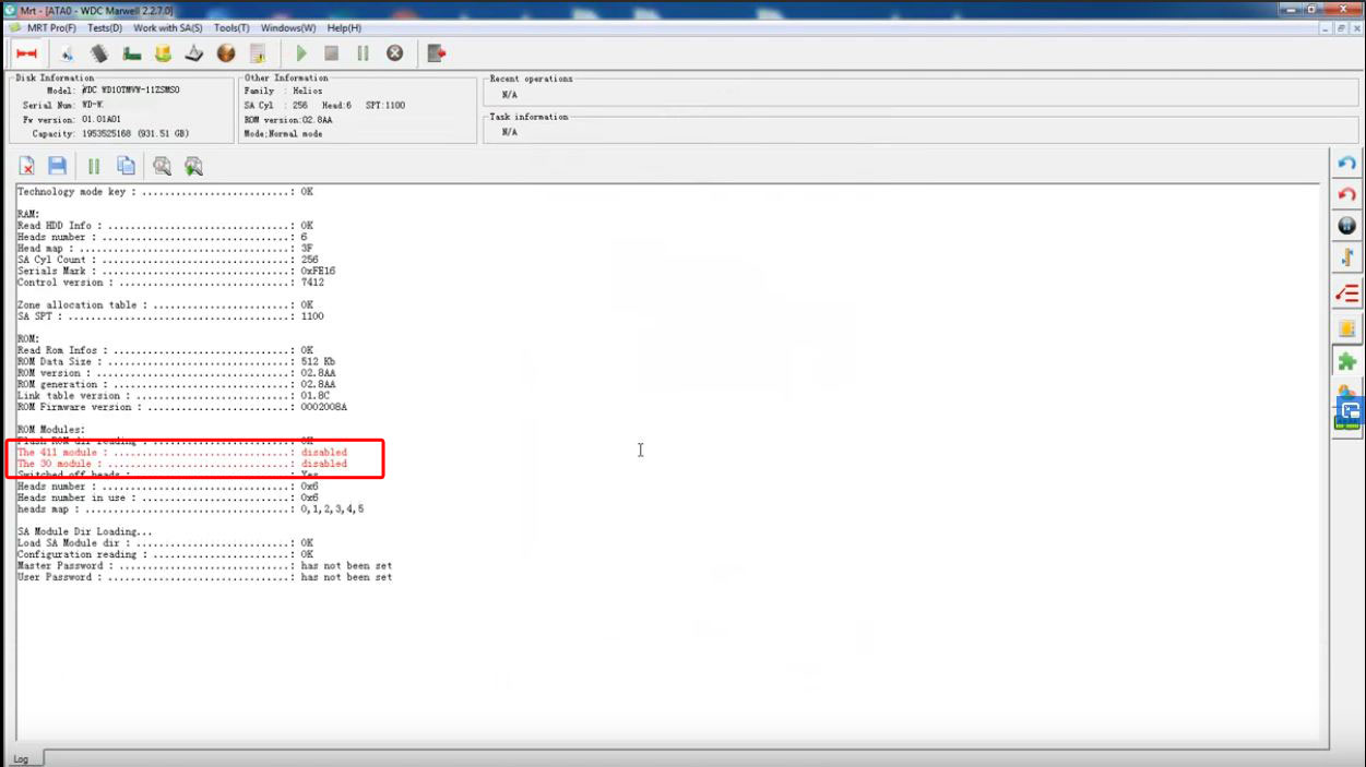

Why did you leave modules 30 and 411 disabled?

just testing
