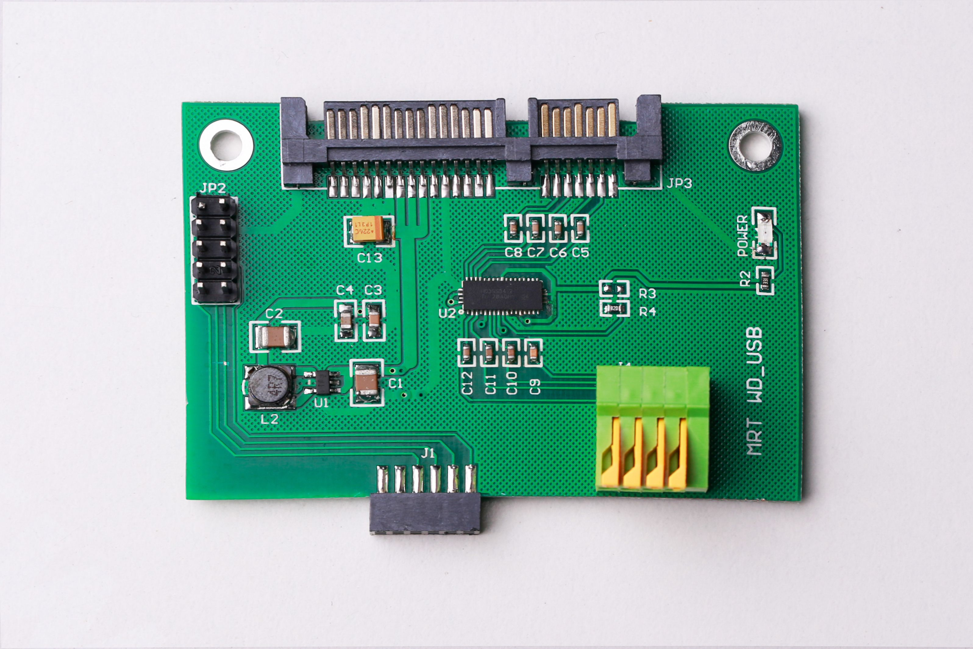

Hello There,
I Am New user of Mrt , Can any one post images or Video Tutorial for the connecting hdd's , when connecting my hdd to mrt ultra it shown unknown Device

i Saw That Basic Tutorials , but I have New special WD CARD Extra , but they not provide how to need connect that. so i Wanna know about that, and My Terminal Drivers also not installing in the System. Win 7 Ultimate X64 Bit

Could it be a card that interfaces to the 12-pin header on WD Passports?

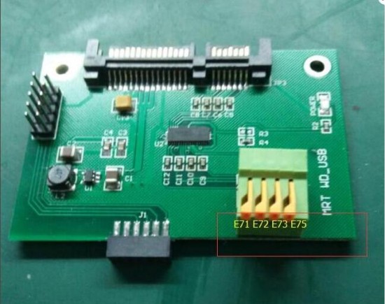

I want to know Wd Card Need To Connect Bottom Side of hard disk or Top SIde of Hdd becoz J1 Will connecting Both sides
but one side will work , another side will mismatch 5v and 12v then, 5v Diod Will Blow
that's why i am asking before trying ....

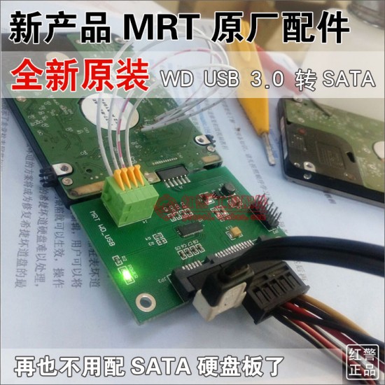

It does not seem to be provided by MRT Lab, right?
I found this:
https://www.aliexpress.com/item/MRT-WD- ... 45502.html

@applpp22, could you tell us the markings on ICs U1 and U2?

The way this card needs to be interfaced is here -> viewtopic.php?p=254892#p254892 .But tomorrow i am going to shoot a special video for you and post it on my youtube channel and link it in the post here .This is the technique i use for WD USB Drives Since Long Time

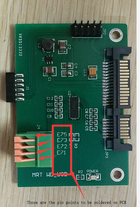

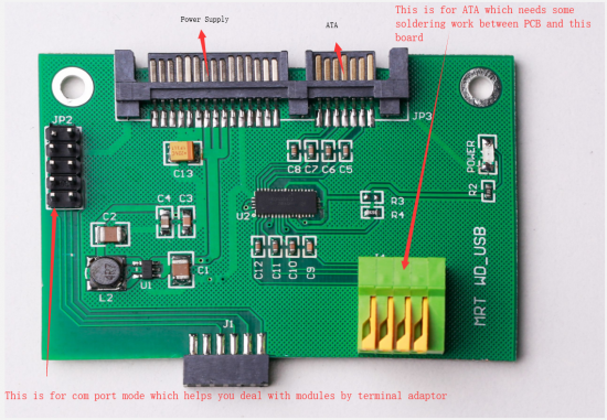

The adapter incorporates a differential switch IC (HD3SS3412). I confess that I don't understand the reason for this. I would have thought that a SATA redriver (eg MAX4952) would have been more appropriate.
MRT WD_USB adapter:
https://i.pinimg.com/originals/2a/3c/c2/2a3cc27565e94c0f529adcff23e69048.jpg
HD3SS3412, Texas Instruments, 4-Channel High-Performance Differential Switch, 3.3V, WQFN-42:
http://www.ti.com/lit/ds/symlink/hd3ss3412.pdf
MAX4952, Maxim, Quad Equalized 1.5/3.0/6.0GT/s SAS/SATA Redriver, 3.3V, TQFN-42:
https://datasheets.maximintegrated.com/en/ds/MAX4952.pdf

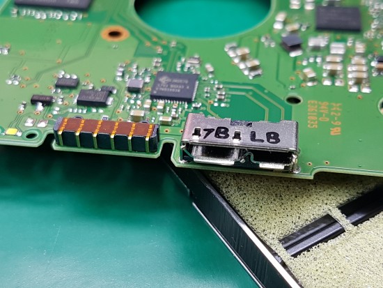

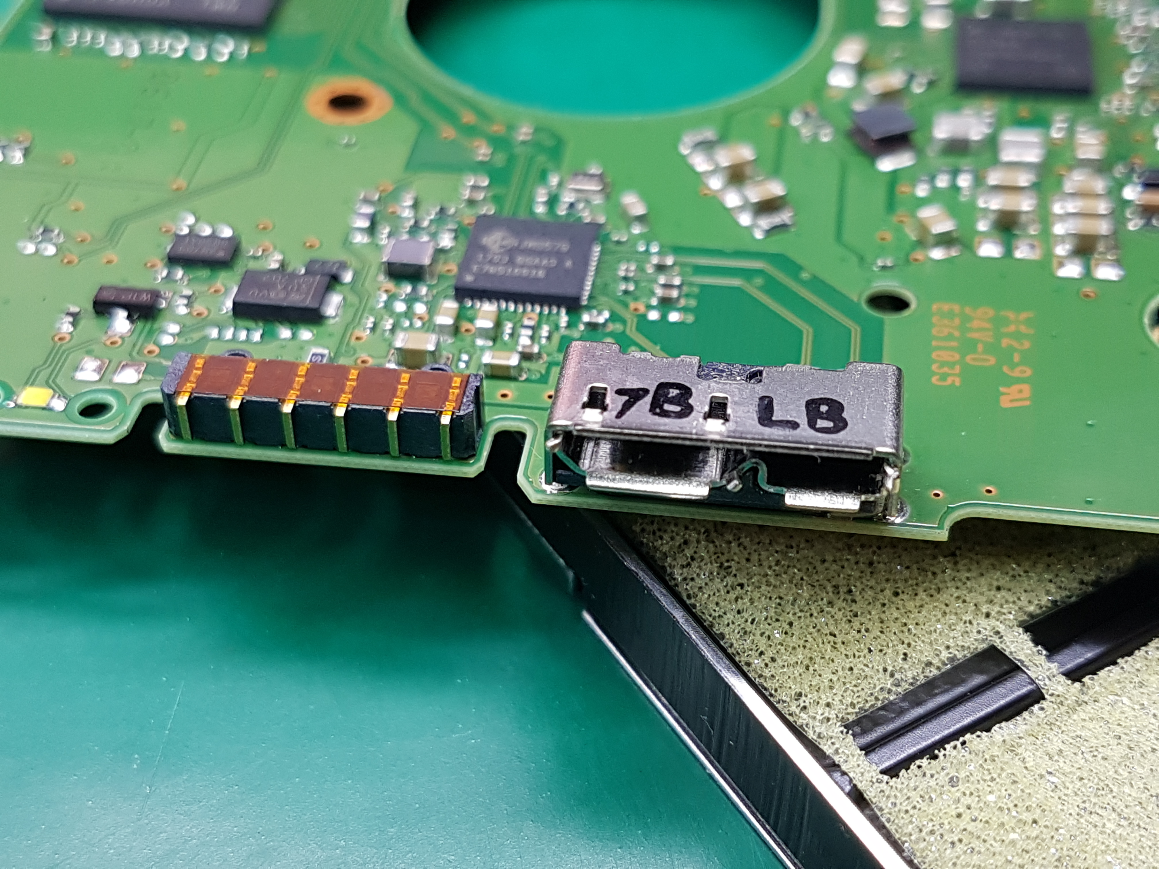

Usually the terminal port on the board would be enough for firmware repair.
Thanks for info, can you share terminal port pinout?
And another question, how to use MRT WD_USB board with new WD USB HDD?
We need data, we get it soldering points on bard
We need power, if we cant connet terminal port.... where to solder and from points????
We should need serial port data, where to solder and wichs pins form adapter board?
Thanks, sure you solve all my doubts
File comment: New Terminal Port on WD USB boards
