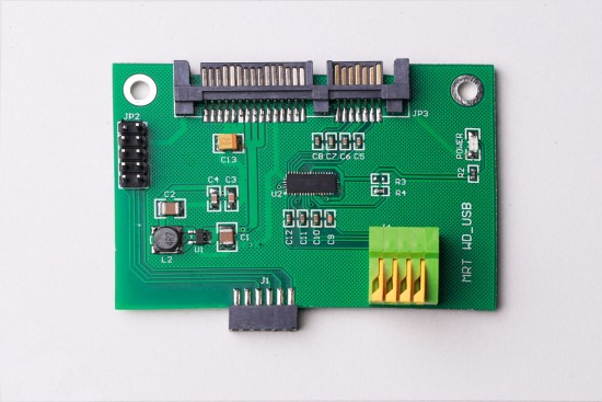

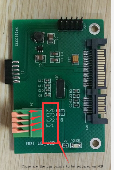

Post new topic Reply to topic  [ 45 posts ]  Go to page 1, 2, 3  Next
 Post subject: New Mrt User, please guide me How to Connect Wd Hard Disk
PostPosted: January 3rd, 2018, 3:42
Joined: August 20th, 2015, 9:00
Posts: 58
Hello There,
I Am New user of Mrt , Can any one post images or Video Tutorial for the connecting hdd's , when connecting my hdd to mrt ultra it shown unknown Device
 Post subject: Re: New Mrt User, please guide me How to Connect Wd Hard Dis
PostPosted: January 3rd, 2018, 10:09
I'm sure that many here are more than willing to assist. But, if you are a new MRT user, why not contact MRT for support?
 Post subject: Re: New Mrt User, please guide me How to Connect Wd Hard Dis
PostPosted: January 4th, 2018, 0:30
Joined: August 20th, 2015, 9:00
Posts: 58
i Saw That Basic Tutorials , but I have New special WD CARD Extra , but they not provide how to need connect that. so i Wanna know about that, and My Terminal Drivers also not installing in the System. Win 7 Ultimate X64 Bit
 Post subject: Re: New Mrt User, please guide me How to Connect Wd Hard Dis
PostPosted: January 4th, 2018, 16:08
Posts: 17335
Could it be a card that interfaces to the 12-pin header on WD Passports?
 Post subject: Re: New Mrt User, please guide me How to Connect Wd Hard Dis
PostPosted: January 8th, 2018, 16:38
Posts: 219
I believe this guy provide the best Data Recovery service for his customers...
 Post subject: Re: New Mrt User, please guide me How to Connect Wd Hard Dis
PostPosted: January 20th, 2018, 5:10
Joined: August 20th, 2015, 9:00
Posts: 58
Martin wrote:
I believe this guy provide the best Data Recovery service for his customers...
:shock: i think you have poorest mind for giving help others
every one should start from first step.
i am in first step ...
but i respect your words bcoz yes i am accepting i will not give accuracy result to customer but i will give best results in future .
To MRT
please make a tutorial for WD WD_USb Card installation in your website .
all Recovery agents not experts (That's why buying expensive kits and waiting for Tutorials )
 Post subject: Re: New Mrt User, please guide me How to Connect Wd Hard Dis
PostPosted: January 21st, 2018, 3:59
applpp22 wrote:
Martin wrote:
I believe this guy provide the best Data Recovery service for his customers...
:shock: i think you have poorest mind for giving help others
every one should start from first step.
i am in first step ...
but i respect your words bcoz yes i am accepting i will not give accuracy result to customer but i will give best results in future .
To MRT
please make a tutorial for WD WD_USb Card installation in your website .
all Recovery agents not experts (That's why buying expensive kits and waiting for Tutorials )
This is Amarbir From Chandigarh India ,I Have MRT Also ,Can You Show Us The Picture of The WDC Drive You Are Planning To Connect To MRT Tool .Were Are You From In India .I Also Have a Few Tutorials For MRT Here
1 : Unboxing Video -> https://www.youtube.com/watch?v=hC6T-c5owso
2 : Registering , Installation And Setup Part 1 - > https://www.youtube.com/watch?v=9W_8g9hxqeU
3 : Registering , Installation And Setup Part 2 -> https://www.youtube.com/watch?v=gAVRrmBYVTg
4 : Registering , Installation And Setup Part 3 -> https://www.youtube.com/watch?v=rzdgDDIs1qc
5 : Registering , Installation And Setup Part 3 -> https://www.youtube.com/watch?v=41zwRAQabno
 Post subject: Re: New Mrt User, please guide me How to Connect Wd Hard Dis
PostPosted: January 21st, 2018, 7:57
Joined: August 20th, 2015, 9:00
Posts: 58
Spildit wrote:
Still waiting to see that WD USB card ....
 Post subject: Re: New Mrt User, please guide me How to Connect Wd Hard Dis
PostPosted: January 21st, 2018, 8:26
Oh ,
So you want to connect a USB WDC Hard Drive To MRT Is That So What You Are Asking :D
 Post subject: Re: New Mrt User, please guide me How to Connect Wd Hard Dis
PostPosted: January 21st, 2018, 8:55
Joined: August 20th, 2015, 9:00
Posts: 58
Amarbir[CDR-Labs] wrote:
Oh ,
So you want to connect a USB WDC Hard Drive To MRT Is That So What You Are Asking :D
I want to know Wd Card Need To Connect Bottom Side of hard disk or Top SIde of Hdd becoz J1 Will connecting Both sides
but one side will work , another side will mismatch 5v and 12v then, 5v Diod Will Blow
that's why i am asking before trying ....
 Post subject: Re: New Mrt User, please guide me How to Connect Wd Hard Dis
PostPosted: January 21st, 2018, 15:08
Joined: November 5th, 2015, 18:00
Posts: 82
Location: in the lab
It does not seem to be provided by MRT Lab, right?
I found this:
https://www.aliexpress.com/item/MRT-WD- ... 45502.html
HTB1uxCUSFXXXXXPXpXXq6xXFXXX0.jpg [ 45.14 KiB | Viewed 46170 times ]
HTB1J0yISFXXXXamXFXXq6xXFXXXr.jpg [ 141.65 KiB | Viewed 46170 times ]
VEXUS Data Recovery
 Post subject: Re: New Mrt User, please guide me How to Connect Wd Hard Dis
PostPosted: January 21st, 2018, 16:00
Posts: 17335
@applpp22, could you tell us the markings on ICs U1 and U2?
 Post subject: Re: New Mrt User, please guide me How to Connect Wd Hard Dis
PostPosted: January 21st, 2018, 17:05
applpp22 wrote:
Amarbir[CDR-Labs] wrote:
Oh ,
So you want to connect a USB WDC Hard Drive To MRT Is That So What You Are Asking :D
I want to know Wd Card Need To Connect Bottom Side of hard disk or Top SIde of Hdd becoz J1 Will connecting Both sides
but one side will work , another side will mismatch 5v and 12v then, 5v Diod Will Blow
that's why i am asking before trying ....
The way this card needs to be interfaced is here -> viewtopic.php?p=254892#p254892 .But tomorrow i am going to shoot a special video for you and post it on my youtube channel and link it in the post here .This is the technique i use for WD USB Drives Since Long Time
 Post subject: Re: New Mrt User, please guide me How to Connect Wd Hard Dis
PostPosted: January 22nd, 2018, 3:11
Joined: August 20th, 2015, 9:00
Posts: 58
@vx1 Thankyou for Your Response ..
 Post subject: Re: New Mrt User, please guide me How to Connect Wd Hard Dis
PostPosted: February 14th, 2019, 4:02
Joined: March 17th, 2018, 13:52
Posts: 6
Location: Usa
Amabir, did you take video of MRT WD_USB interface? i cant find it and im interested, thanks for info and share
 Post subject: Re: New Mrt User, please guide me How to Connect Wd Hard Dis
PostPosted: February 14th, 2019, 4:04
Joined: March 17th, 2018, 13:52
Posts: 6
Location: Usa
applpp22 wrote:
@vx1 Thankyou for Your Response ..
Did you get manual or learnd to use and connect MRT WD_USB interface?
I get from Aliex.... and dont know how to use it :shock:
 Post subject: Re: New Mrt User, please guide me How to Connect Wd Hard Dis
PostPosted: February 14th, 2019, 18:30
Posts: 17335
The adapter incorporates a differential switch IC (HD3SS3412). I confess that I don't understand the reason for this. I would have thought that a SATA redriver (eg MAX4952) would have been more appropriate.
MRT WD_USB adapter:
https://i.pinimg.com/originals/2a/3c/c2/2a3cc27565e94c0f529adcff23e69048.jpg
HD3SS3412, Texas Instruments, 4-Channel High-Performance Differential Switch, 3.3V, WQFN-42:
http://www.ti.com/lit/ds/symlink/hd3ss3412.pdf
MAX4952, Maxim, Quad Equalized 1.5/3.0/6.0GT/s SAS/SATA Redriver, 3.3V, TQFN-42:
https://datasheets.maximintegrated.com/en/ds/MAX4952.pdf
MRT_WD_USB_8.jpg [ 608.67 KiB | Viewed 41861 times ]
 Post subject: Re: New Mrt User, please guide me How to Connect Wd Hard Dis
PostPosted: February 14th, 2019, 21:53
Joined: June 26th, 2014, 5:08
Posts: 135
Location: China
Usually the terminal port on the board would be enough for firmware repair.
2.png [ 1.28 MiB | Viewed 37514 times ]
1.png [ 575.53 KiB | Viewed 37514 times ]
Whatsup: +8615827155998
 Post subject: Re: New Mrt User, please guide me How to Connect Wd Hard Dis
PostPosted: February 15th, 2019, 2:34
Joined: March 17th, 2018, 13:52
Posts: 6
Location: Usa
The adapter incorporates a differential switch IC (HD3SS3412). I confess that I don't understand the reason for this. I would have thought that a SATA redriver (eg MAX4952) would have been more appropriate.
MRT WD_USB adapter:
https://i.pinimg.com/originals/2a/3c/c2/2a3cc27565e94c0f529adcff23e69048.jpg
HD3SS3412, Texas Instruments, 4-Channel High-Performance Differential Switch, 3.3V, WQFN-42:
http://www.ti.com/lit/ds/symlink/hd3ss3412.pdf
MAX4952, Maxim, Quad Equalized 1.5/3.0/6.0GT/s SAS/SATA Redriver, 3.3V, TQFN-42:
https://datasheets.maximintegrated.com/en/ds/MAX4952.pdf
Thanks, good info!!!
Do you know serial connector pinout?
Beautiful Girls in your city
 Post subject: Re: New Mrt User, please guide me How to Connect Wd Hard Dis
PostPosted: February 15th, 2019, 2:46
Joined: March 17th, 2018, 13:52
Posts: 6
Location: Usa
mrtpro wrote:
Usually the terminal port on the board would be enough for firmware repair.
Thanks for info, can you share terminal port pinout?
And another question, how to use MRT WD_USB board with new WD USB HDD?
We need data, we get it soldering points on bard
We need power, if we cant connet terminal port.... where to solder and from points????
We should need serial port data, where to solder and wichs pins form adapter board?
Thanks, sure you solve all my doubts
File comment: New Terminal Port on WD USB boards
20190213_211004 puerto serie nuevo.jpg
20190213_211004 puerto serie nuevo.jpg [ 3.03 MiB | Viewed 37499 times ]
Beautiful Girls in your city
Post new topic Reply to topic  [ 45 posts ]  Go to page 1, 2, 3  Next
