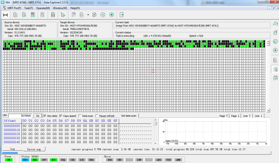

Head 0 - OK
Head 1 - OK
Head 2 - Ok
Head 3 - OK
While making Image made image with Head 1,2,3
Next made with Head 0 - error reading many sectors.
(see the Attach screen)
Any Help or suggestion "FAILED TO READ" Sector's
 Post subject: Re: WDC WD5000BEVT-60A0RT0 - 500 GB SATA
PostPosted: October 9th, 2020, 4:00
Posts: 4840
It looks like you are shooting in the dark... Why on earth you regenerated the translator if the drive was reading UA?
Anyway, H0 is apparently weak, MHA needs to be replaced.
