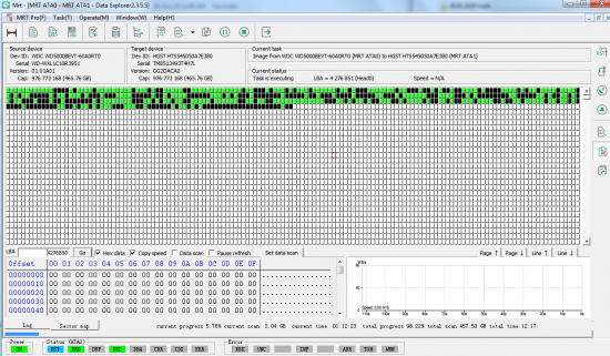

 Post subject: WDC WD5000BEVT-60A0RT0 - 500 GB SATA
PostPosted: October 9th, 2020, 2:05
Joined: July 10th, 2020, 7:34
Posts: 52
Head 0 - OK
Head 1 - OK
Head 2 - Ok
Head 3 - OK
While making Image made image with Head 1,2,3
Next made with Head 0 - error reading many sectors.
(see the Attach screen)
Any Help or suggestion "FAILED TO READ" Sector's
LOG:
Technology mode key : ..........................: OK
RAM:
Read HDD Info : ................................: OK
Heads number : .................................: 4
Head map : .....................................: F
SA Cyl Count : .................................: 256
Serials Mark : .................................: 0xD316
Control version : ..............................: 63B0
Zone allocation table : ........................: OK
SA SPT : .......................................: 899
ROM:
Read Rom Infos : ...............................: OK
ROM Data Size : ................................: 256 Kb
ROM version : ..................................: 14.DHQ
ROM generation : ...............................: 14.DHQ
Link table version : ...........................: 05.CP
ROM Firmware version : .........................: 001400DH
ROM Modules:
Flash ROM dir reading : ........................: OK
Switched off heads : ...........................: Yes
Heads number : .................................: 0x4
Heads number in use : ..........................: 0x4
heads map : ....................................: 0,1,2,3
Load SA translator : ...........................: OK
SA Module Dir Loading...
Load SA Module dir : ...........................: OK
Configuration reading : ........................: OK
Master Password : ..............................: has not been set
User Password : ................................: has not been set
BTW : Translator Generation done : successfully.
Thanks in Advance for help/suggestion.
MRT-WD-Head0-reading-problem.png [ 94.33 KiB | Viewed 11488 times ]
 Post subject: Re: WDC WD5000BEVT-60A0RT0 - 500 GB SATA
PostPosted: October 9th, 2020, 4:00
Posts: 4840
It looks like you are shooting in the dark... Why on earth you regenerated the translator if the drive was reading UA?
Anyway, H0 is apparently weak, MHA needs to be replaced.
 Post subject: Re: WDC WD5000BEVT-60A0RT0 - 500 GB SATA
PostPosted: October 9th, 2020, 11:26
Joined: July 10th, 2020, 7:34
Posts: 52
thanks for the reply.
Users browsing this forum: Google [Bot] and 8 guests
