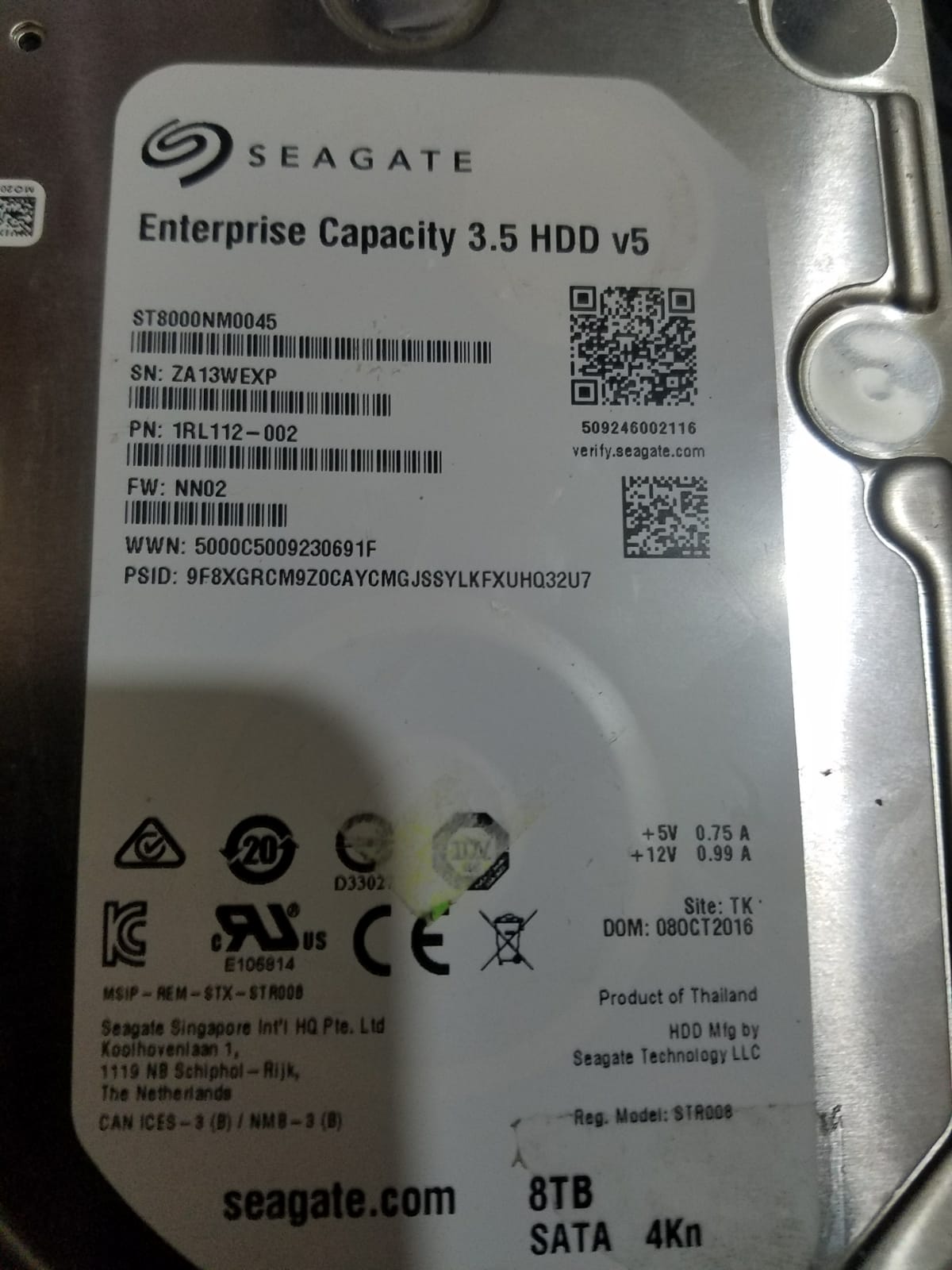

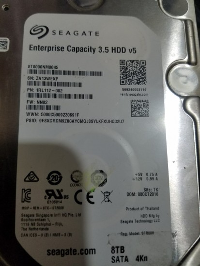

 Post subject: Re: I NEED FIRMWARE
PostPosted: September 14th, 2021, 3:14
Posts: 184
Location: pakistan
please now

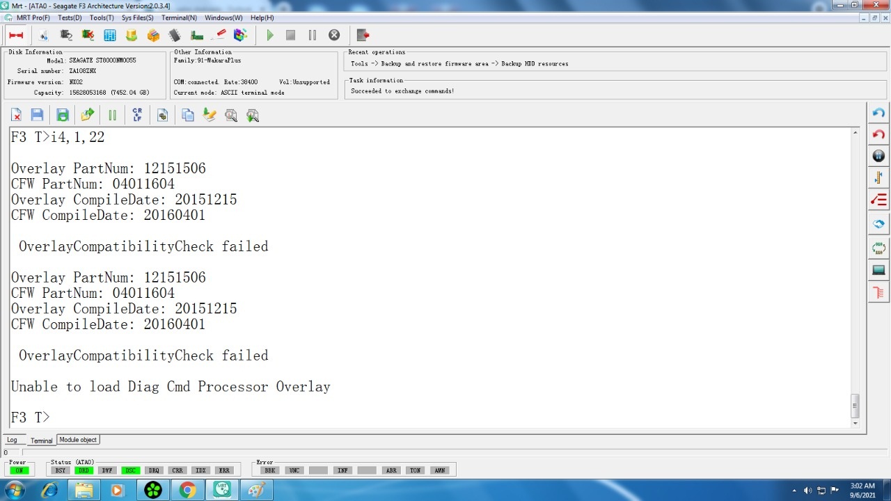

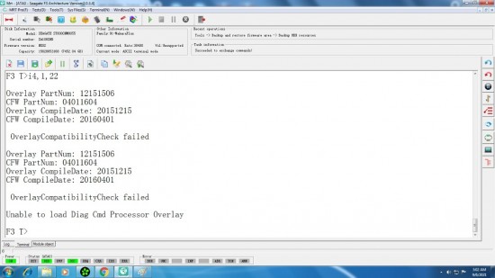

PostPosted: September 18th, 2021, 2:01
Posts: 184
Location: pakistan
please
i think i need LDR
PostPosted: September 18th, 2021, 4:01
Posts: 17381
This could be the result of a failed or improper firmware update.
Can you upload your ROM? It may be possible to revert to a backup copy of the original firmware.
PostPosted: September 18th, 2021, 14:09
Posts: 1324
RAP and CAP are bad amongst other bits and the serial number in the SAP doesn't match the label you posted (but does match your MRT screenshot). Above my paid grade I'm afraid.
PostPosted: September 18th, 2021, 14:36
Posts: 17381
That's only half the ROM.
Following up Lardman's observation ...
https://www.seagate.com/au/en/support/warranty-and-replacements/
Your Product -- Exos 7E
Model Number -- ST8000NM0055
SerialNumber -- ZA108ZNX
Your Product -- Enterprise Capacity 3.5 Hard Drives
Model Number -- ST8000NM0045
SerialNumber -- ZA13WEXP
PostPosted: September 18th, 2021, 16:37
Posts: 17381
Could we see both sides of the PCB?
Could we see the markings on the chips, especially the ROM?
PostPosted: October 1st, 2021, 16:08
Posts: 17381
Why does your drive have two different serial numbers from two different models?
Why have you only uploaded half of the ROM?
Is the drive a fake?
The "Overlay ..." messages in your terminal log would suggest that your drive can reach the SA, so the adaptives would seem to be native, or am I misunderstanding something?
