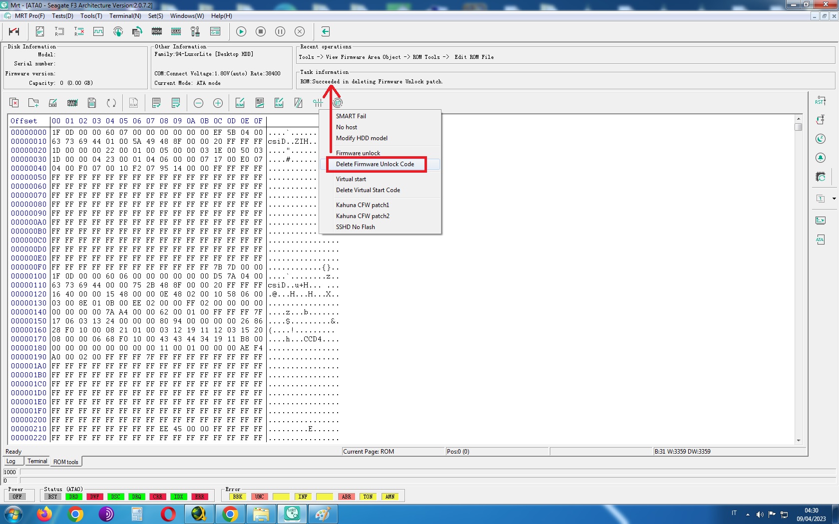

I got ST500DM009 and in terminal: ---Mrt UnLock--- it seems the customer took it to another lab that used MRT
Can someone help me remove the Unlock and restore the original ROM so i can use PC3000

What about using this ROM to restore it?
https://firmware.hddsurgery.com/dl.php?file=20714&filename=ST500DM009-2F110A-CC43-ZA49BKZA.zip
You could patch your drive's adaptives into the donor. Hopefully the code is compatible with the SA.

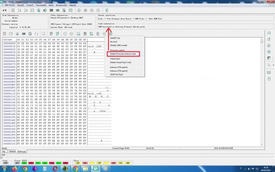

I deleted the fw unlock code with my mrt.
Here's the file:
MRT ROMChange.zip [399.35 KiB]
Downloaded 623 times
MRT SCREEN

thanks
