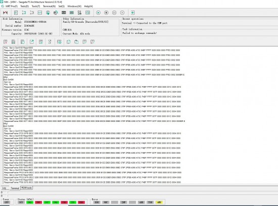

 Post subject: ST2000DM001 – Head 0 Dead, SA Backed Up, Data Access Options
PostPosted: January 21st, 2026, 4:02
Joined: February 12th, 2021, 1:27
Posts: 76

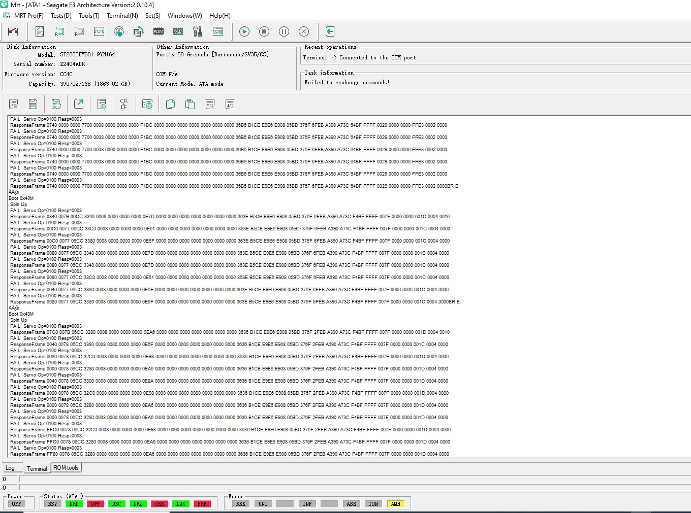

I’m working on a Seagate ST2000DM001 (Grenada) with Head 0 dead. Before the failure, the drive could identify but the heads were weak, so I backed up all resources, including ROM, SA modules, and system files. After that, Head 0 failed, and now the drive does not identify / does not go ready.
Is there any way to access user data using the existing SA backup, and imaging H1, H2, H3...etc without performing a head swap?
Any advice would be appreciated.
