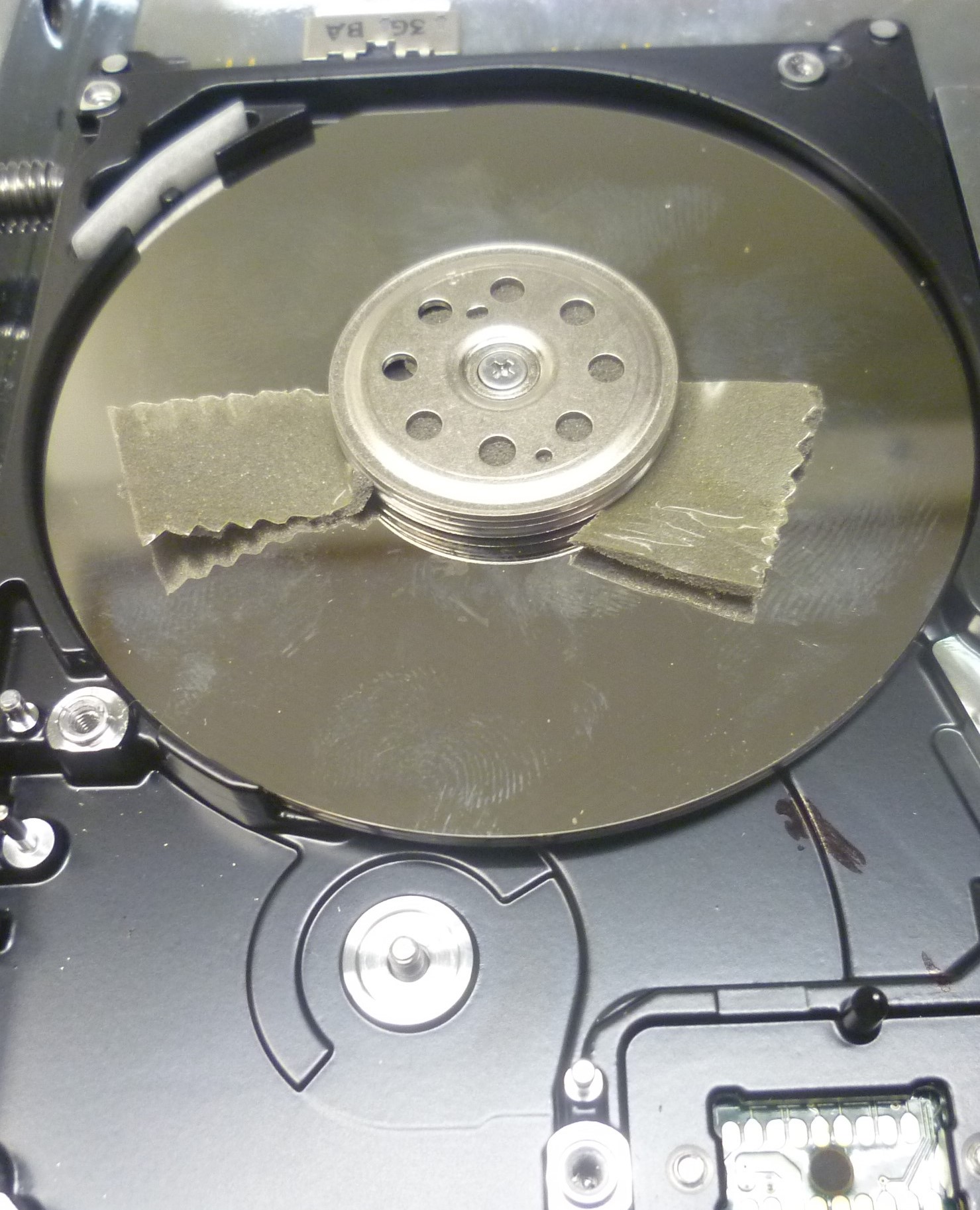

Allegedly done by a local "PC expert guy" (Not UK) ...
Exactly as we received it.
So many issues it's almost laughable :-(

Top platter also has radial "slipped screwdriver" scratches on it too :-(
Who knows the order and what way up the platters are meant to be, and what damage caused by the platters being pressed against each other.

50% chance!!! are you crazy, I'd give that a 2% chance of getting so much as a single sector read. Anyone who's dumb enough to have messed around with the platters like that has also tried every DIY hack technique in the book. I'm sure it's already spent a night and a day in the freezer, been brutalized with Spinrite, left clicking for a couple of days, etc.
Quote $1000 + parts with no guarantees of getting any data back. That's what I would do.

No, they are marker pen marks.
Haven't checked this one, but the last two drives we had in from this dealer (who says they came in from another "data recovery company") had the same marks on the base along with similar marks on the platter edges, presumably a futile attempt at platter alignment.
One of the last ones had so much ink splodged on it that it had seeped onto the platter and had coloured the head sliders purple when looked at under a microscope! It was a Samsung HM100UI that shows an "unpack error" in terminal with no spin. Any half decent pro would recognise this fault and know that this guy almost certainly had no business switching the 3 platters to another chassis and getting fingerprints on all 6 surfaces :-(

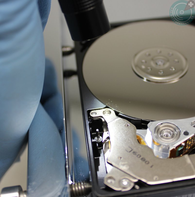

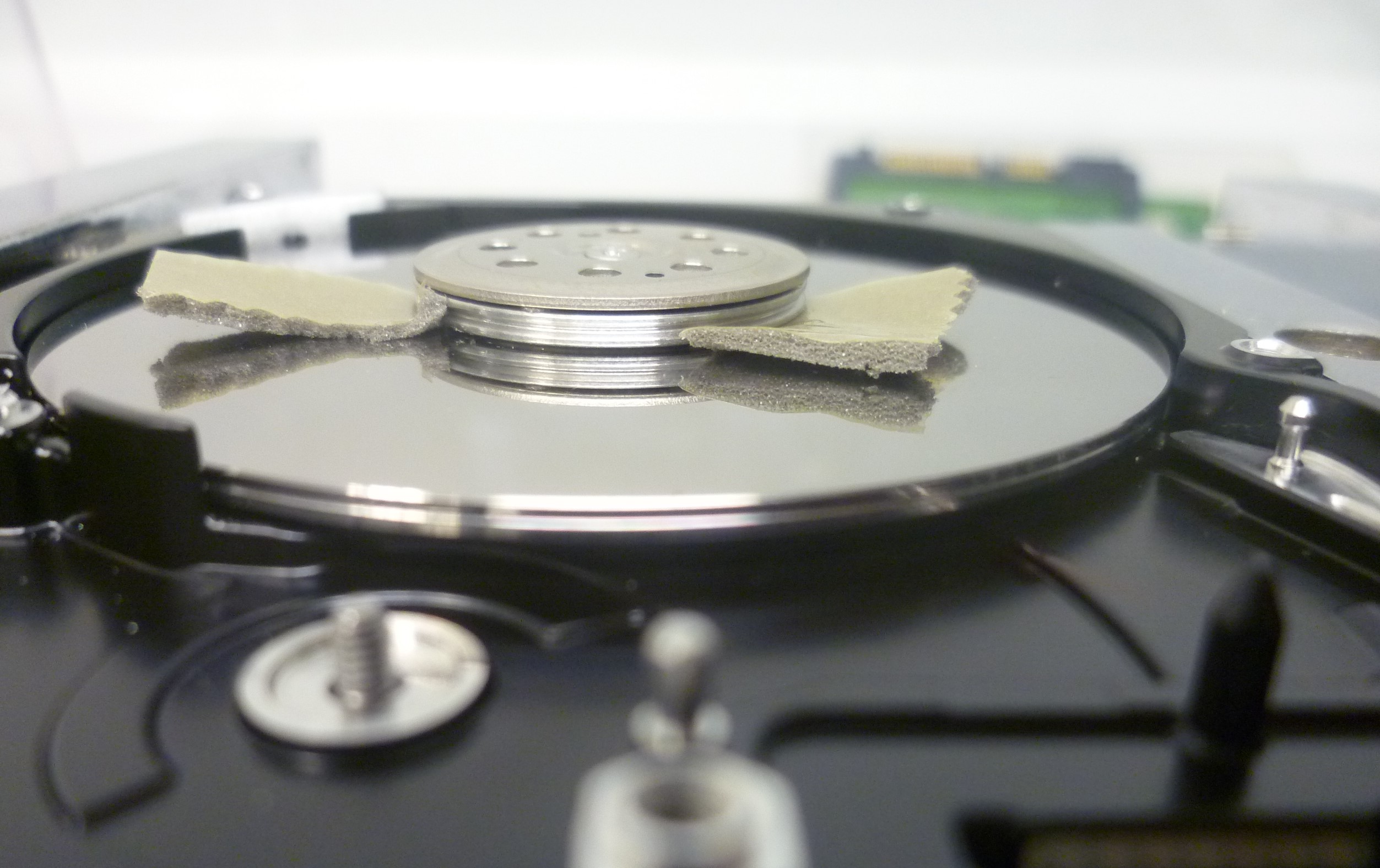

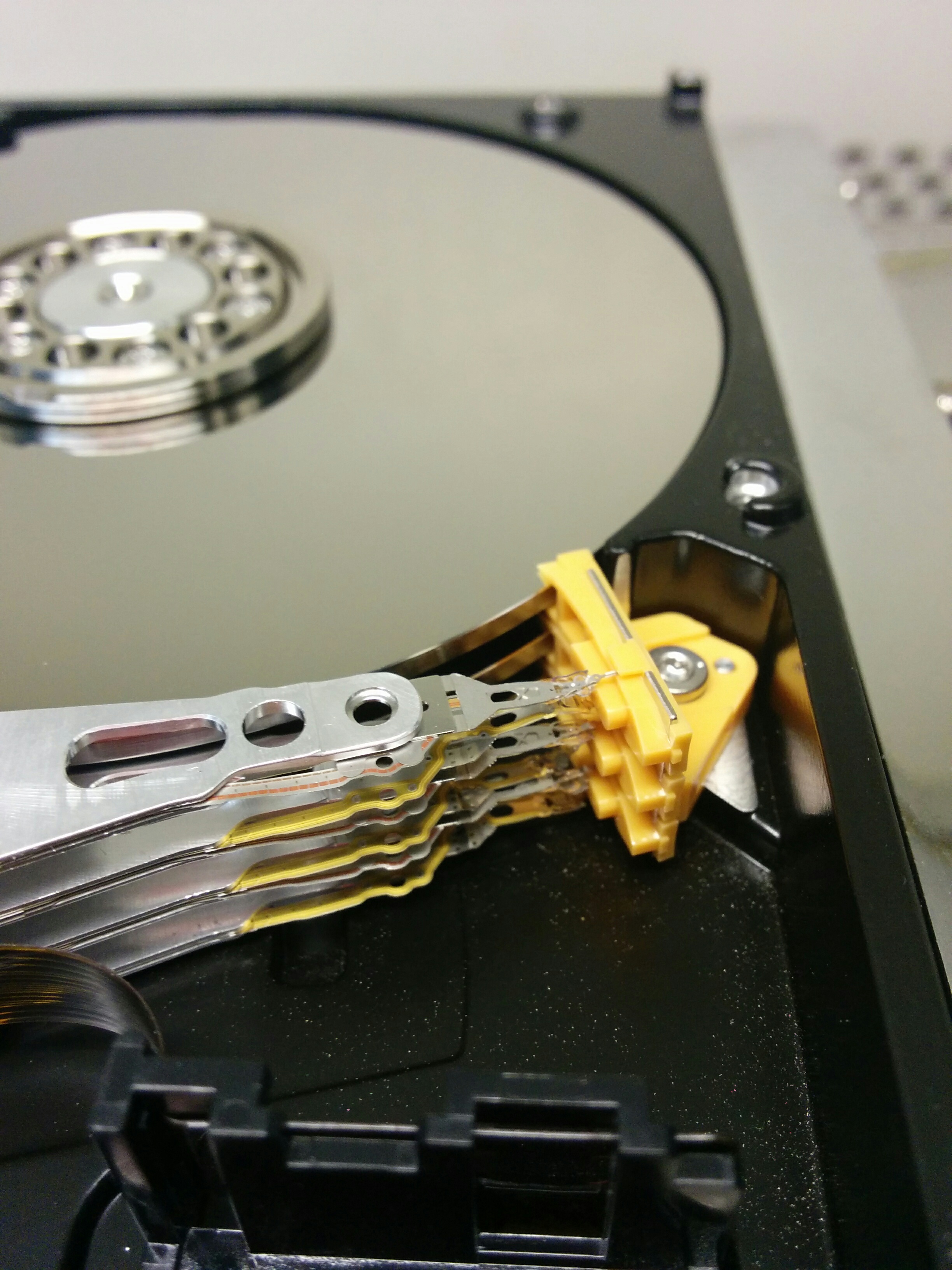

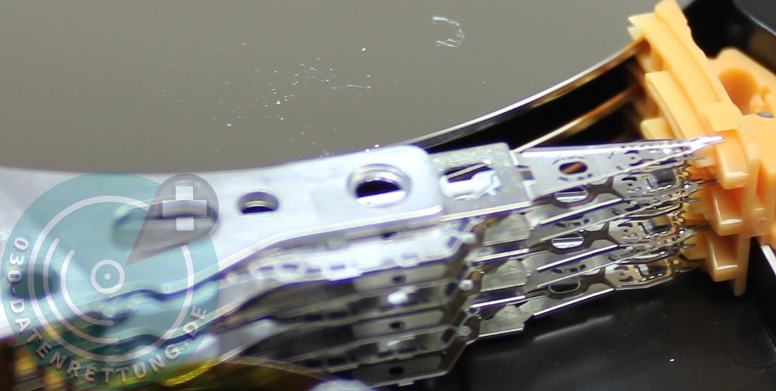

Its not only DIY that goes wrong, I got two drives in from two different DR companies that claim to offer clean-room labs in Germany: "device has been handled under appropriate clean-room conditions".
Opened one drive today and there was a mess, not only limiter & filter missing but fingerprints & dust everywhere :evil: . And what was really sad, they did not even checked pcb contacts first - might have been the problem the drive had in the first place ...
