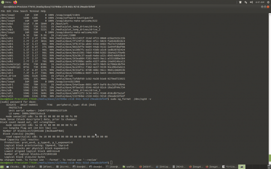

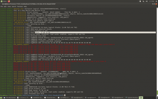

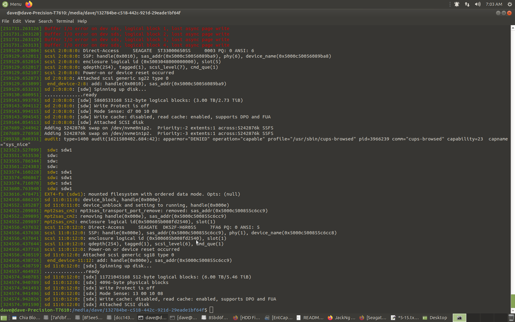

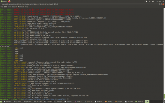

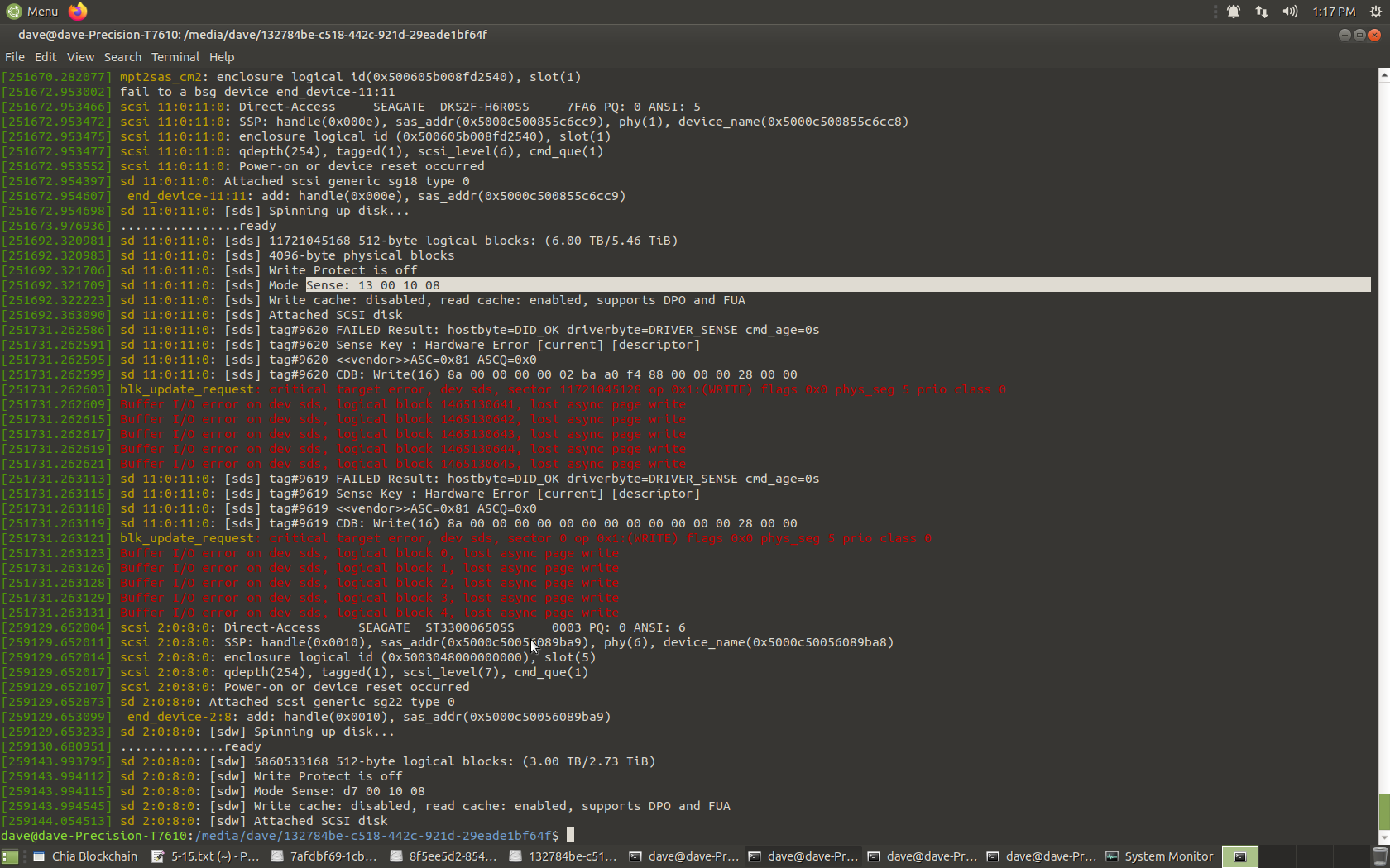

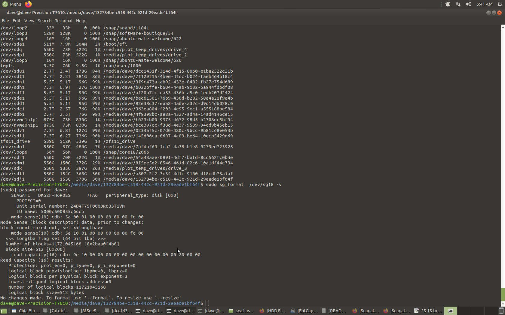

I have the same problem, Can the 7FA6 bios be hex edited, to change the vendor code to match the other one link here https://forum.hddguru.com/viewtopic.php?f=13&t=20868 or can this script help https://forum.hddguru.com/viewtopic.php?f=13&t=28252, and I also found this but no info how to flash it in Linux https://www.dell.com/support/home/en-us/drivers/driversdetails?driverid=vd3rj. I know how to use a spi flasher can i dump the firmware with that, I found donor boards with right flash chip but cost around 50$ but that kind a lot but i have 2 drive. I have formatted one to 512, with sg_format but it doesnt work, i can right the partition table.
