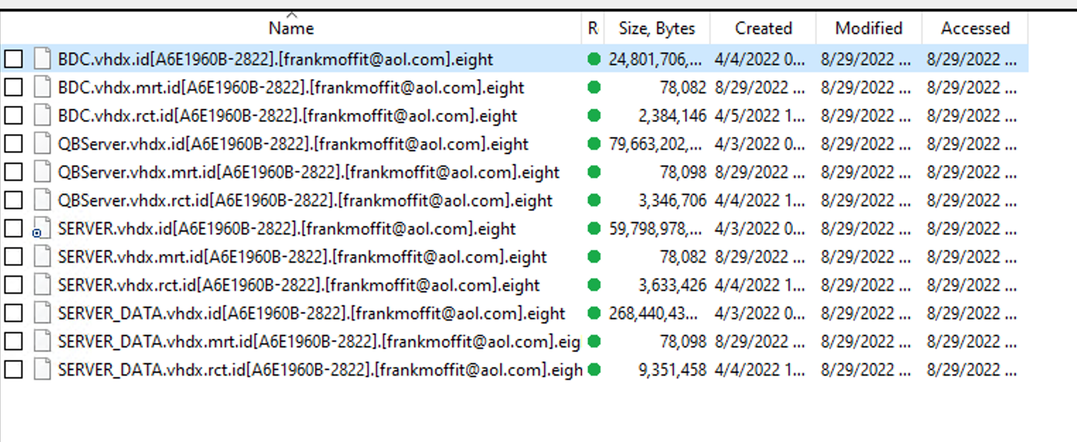

I have an urgent matter :( I have several ransomware-encrypted .vhdx files that contain critical data that unfortunately doesn't exist in a fresh backup somewhere :(
https://do-it-rmm.s3.us-west-1.amazonaws.com/encrypted+vhdx+files.png
A colleague told me that it's likely that only the only the catalog or $MFT might be encrypted so it won't mount... I should be able to get the data?
He told me you guys are the best and will likely have recommendations.
Please help! I'll be up all night waiting for a reply.
Thank you!

your data got effected with 3 different ransomware hackers i dont think it can be recover without key.

Where is this conclusion coming from?
No.
You got infected with Phobos Ransomware which, after studying and researching it for several years, I found that it has no weaknesses.
HOWEVER,
depending on what kind of files these virtual drives contain, I might be able to help. But it won't be cheap.

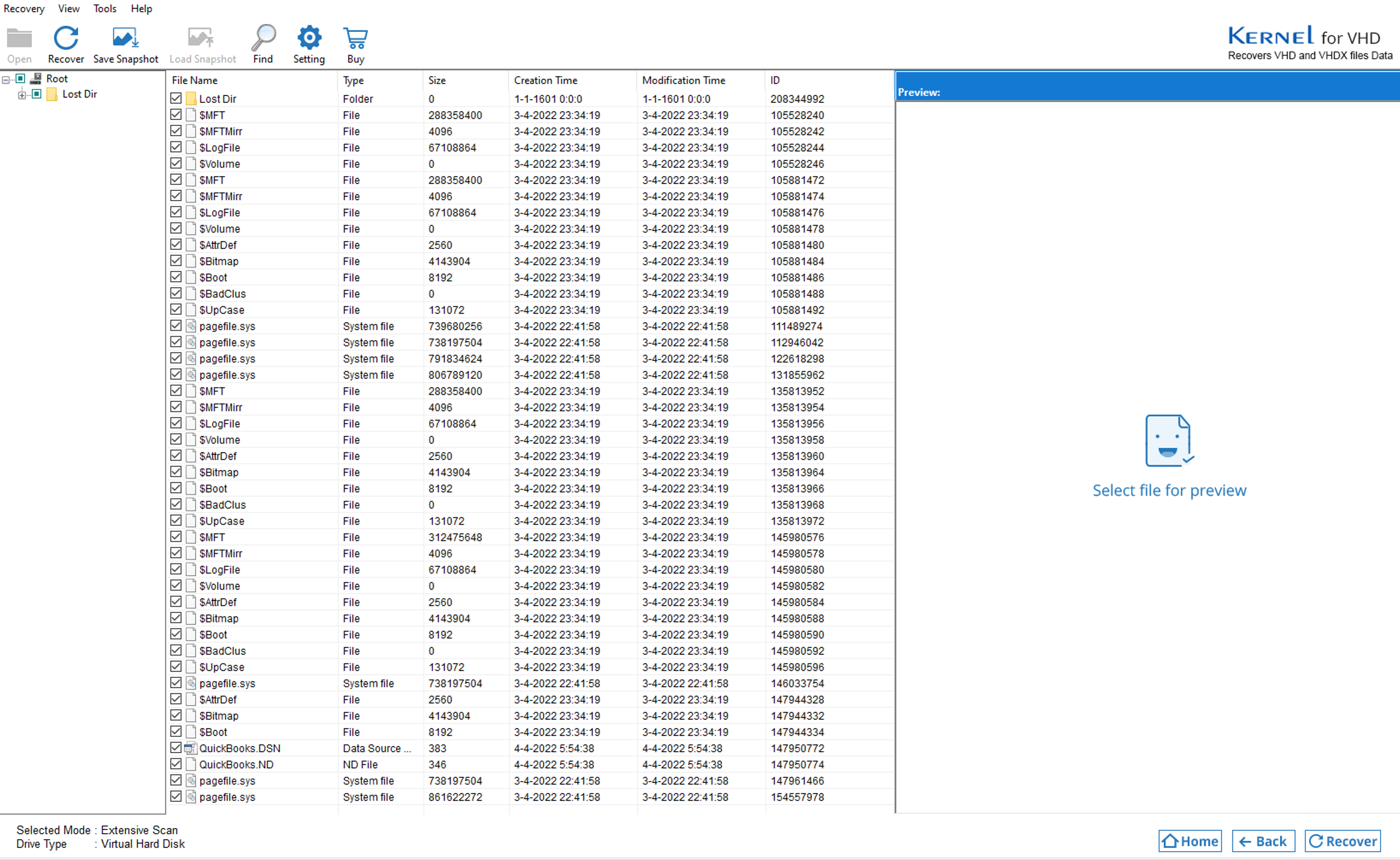

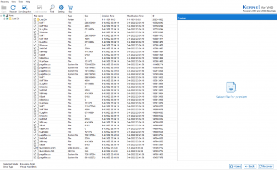

Kernel for VHD only shows me tons of NTFS filesystem chunks with similar useless files in them...

 Post subject: Re: Ransomware encrypted .vhdx files. What software can moun
PostPosted: September 12th, 2022, 13:42
Joined: May 13th, 2019, 7:50
Posts: 1214
Location: Nederland
Maybe get 2nd opinion using UFS.

I'd take Arch Stanton's last advice: Use UFS, scan and mount the vhdx files you have and then select "scan for lost data" on them.
Obviously, expect partial recovery results at the very best scenario.
