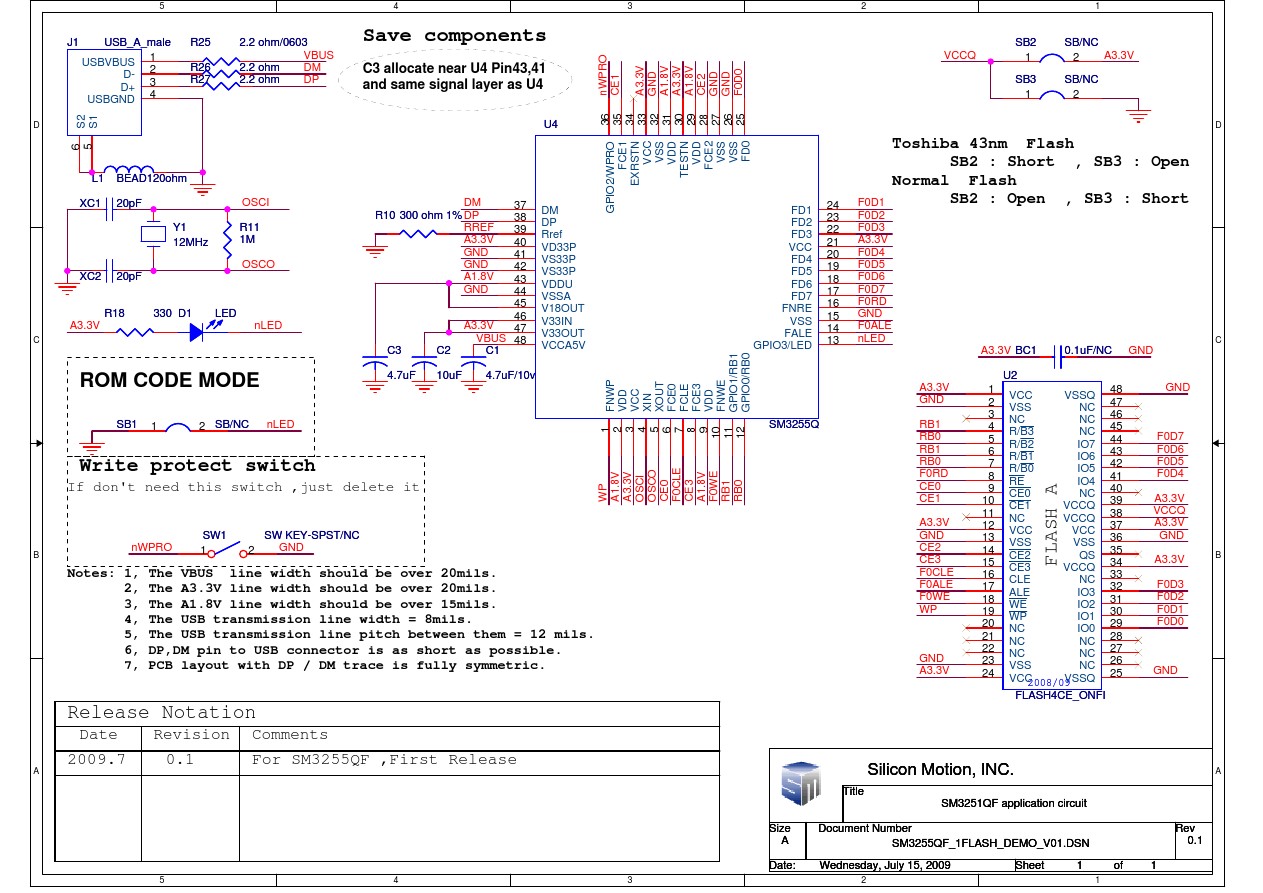

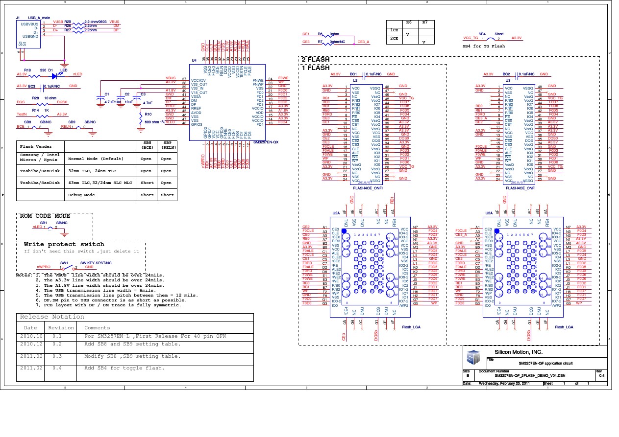

Option 3 is to buy any cheap flash drive, locate the controller's Write Protect pin, and then add your own switch. If you intend to use your flash drive as a permanent read-only archive, then you could solder a permanent link to ground.
See the following Silicon Motion reference circuits:
download/file.php?id=8221&mode=view (SM3257EN_application_circuit.jpg)
download/file.php?id=8220&mode=view (SM3255QF_application_circuit.jpg)
The nWPRO pin is the one you would need to hack.
