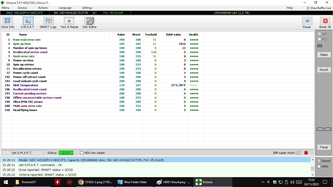

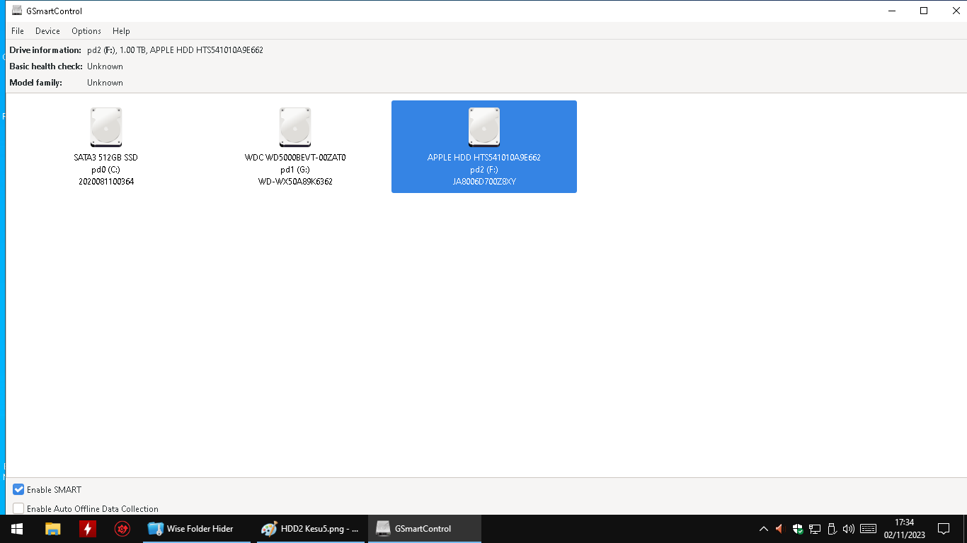

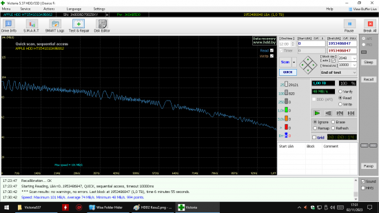

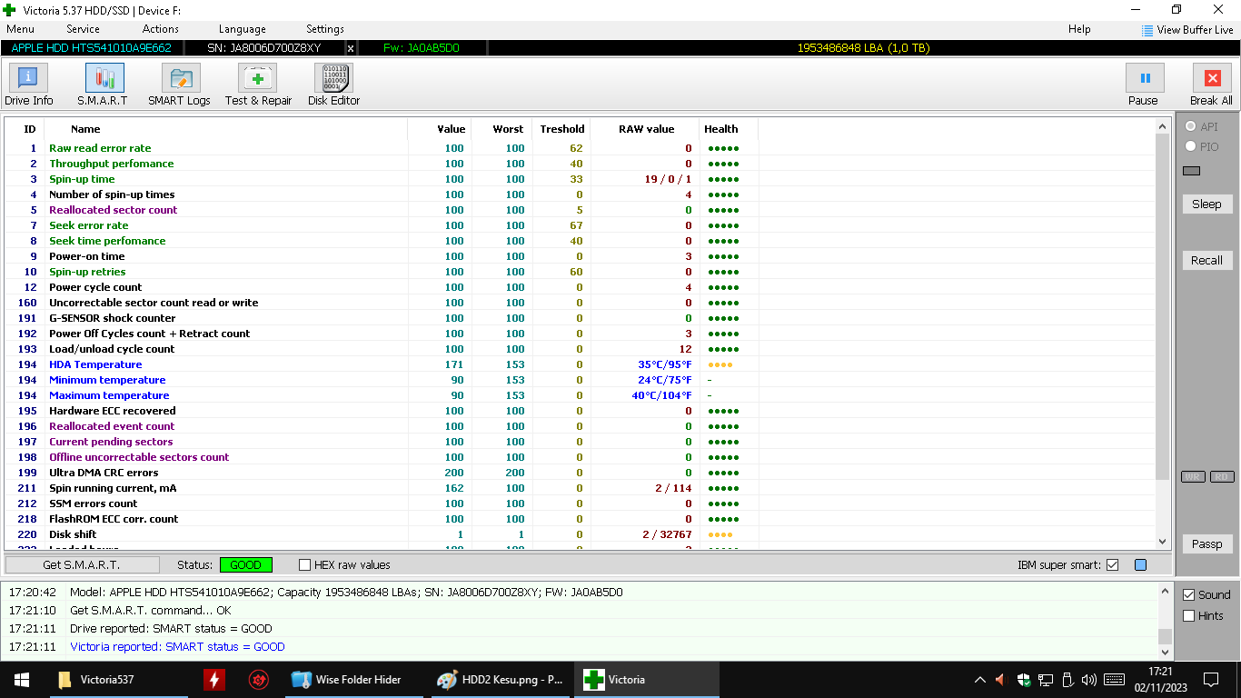

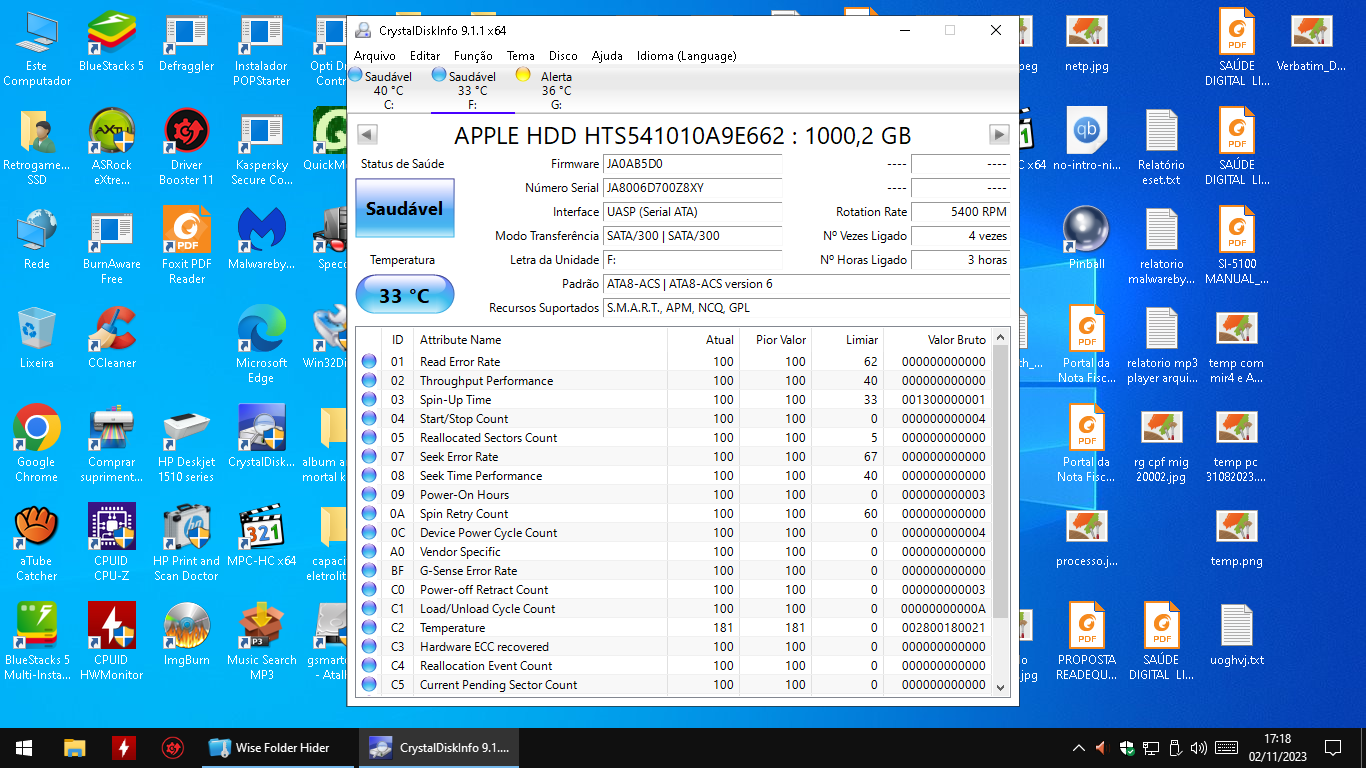

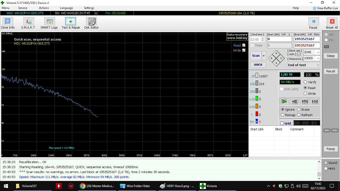

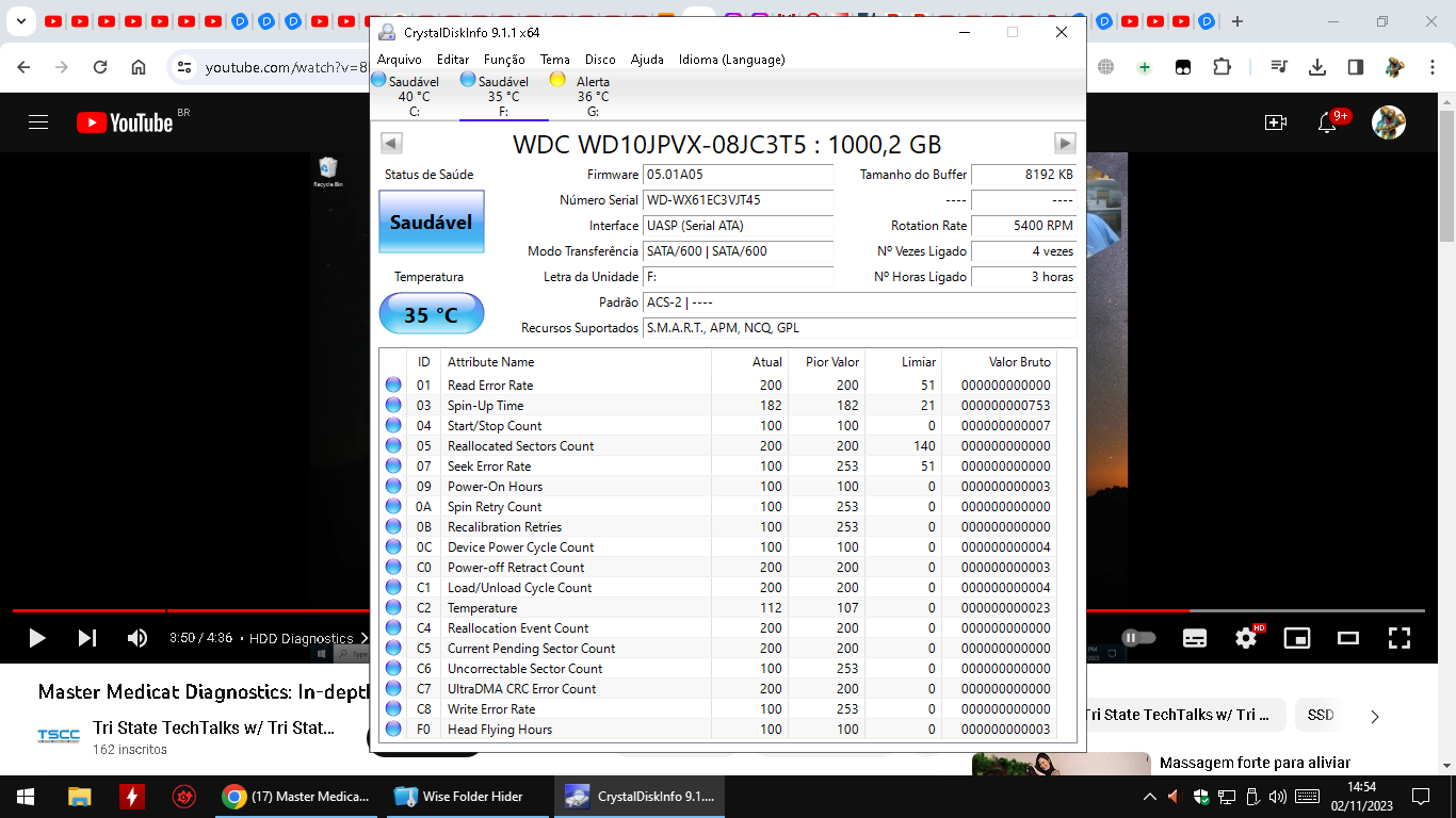

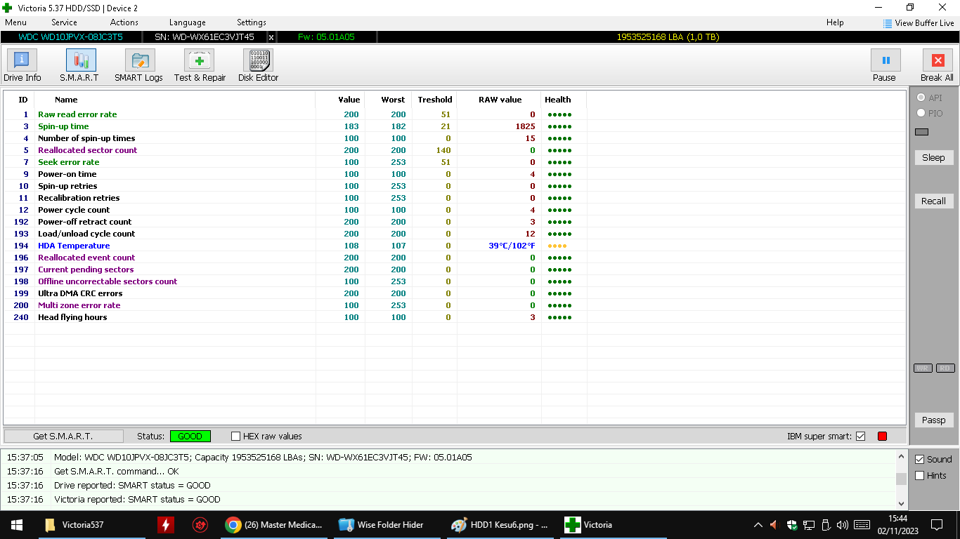

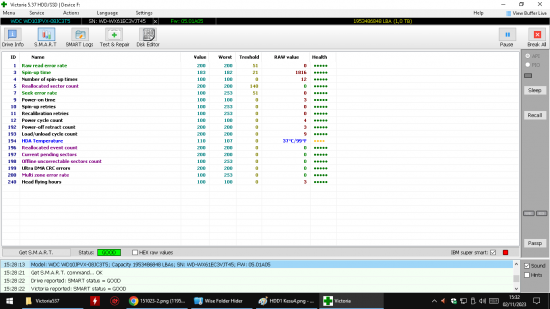

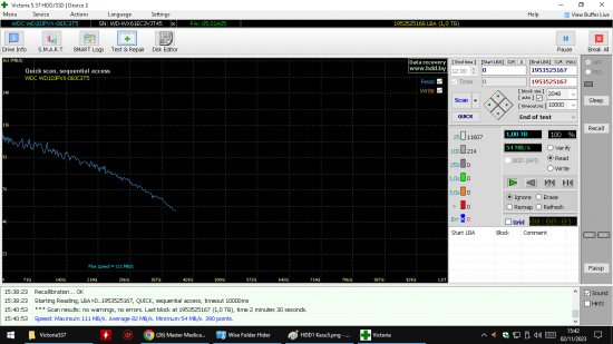

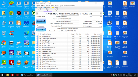

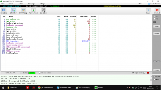

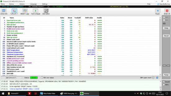

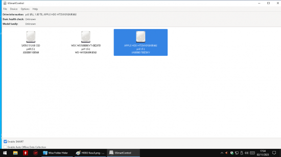

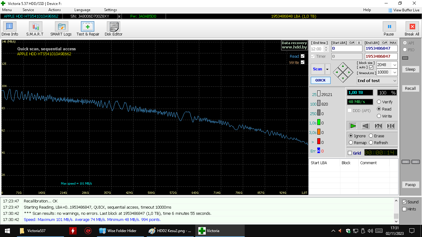

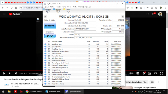

I tested my HDDs Victoria Are these HDDs only good for storing files? two hdds 1TB

Did you analyze the photos? Are both two HDDs good for storing files or no?
Another question, one of the HDDs the test graph does not go up to 1TB it stops before 1TB and the test is two minutes shorter, is this normal?

if you want to make sure hdd is realiable, do a full scan. Quick scan gives a fast idea how the health is.
Smart for both hdd seems to be ok (if nobody made a smart reset).
Second hdd should be tested til the end.

Is a new test on HDD2 really necessary or are the tests that have already finished on both HDDs enough for both HDDs to be good for storing data? I posted photos of all the tests, Smart etc. What opinions this tests completed?
