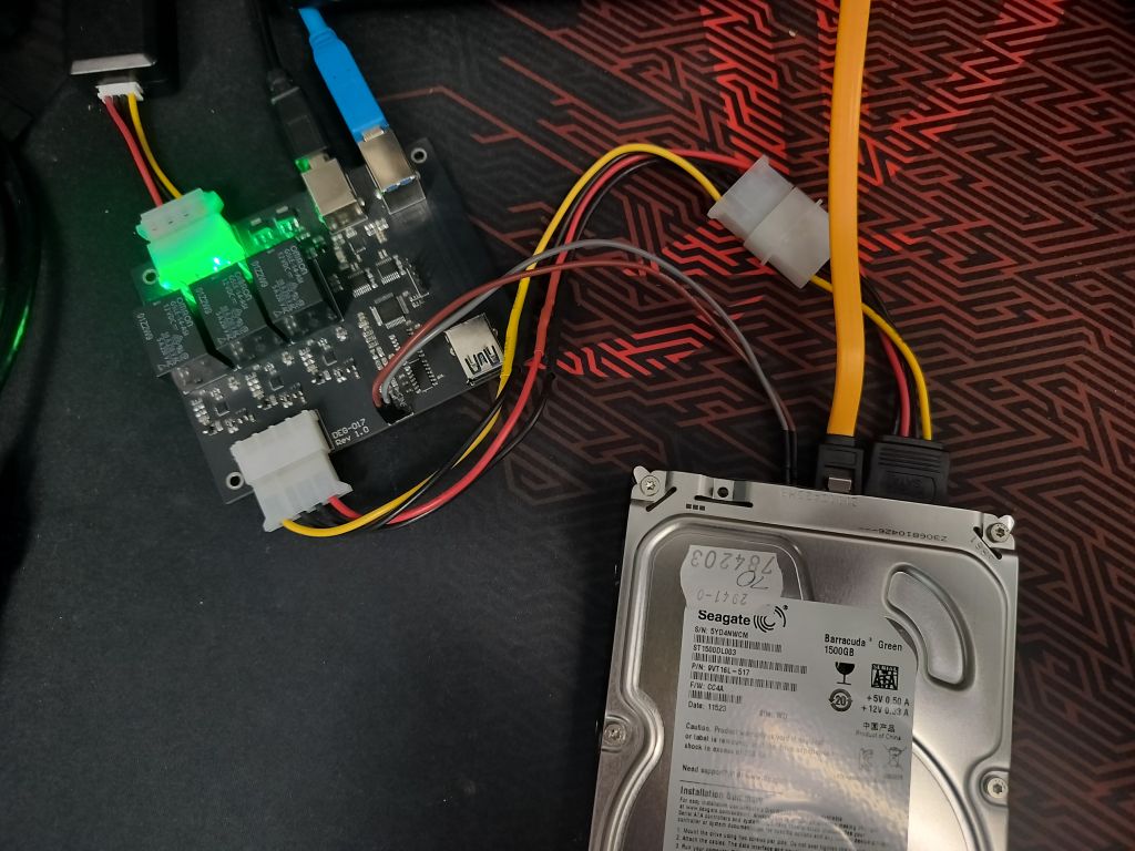

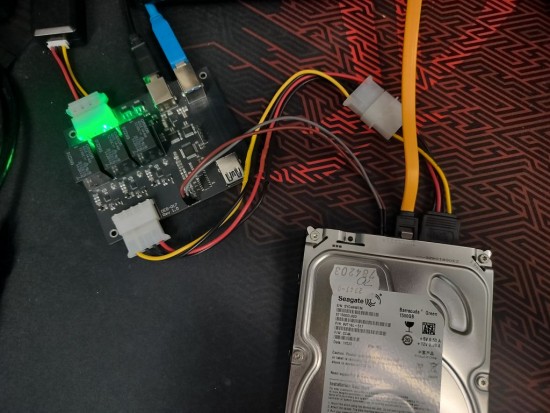

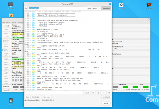

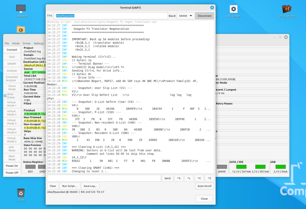

Adding some interesting new features to OpenSuperClone. The program will soon support serial commands both through the UI and script engine
with any UART adapter. I've added some scripts for Seagate F3 drives (some obviously quite dangerous).
Also in the process of building some companion hardware that combines relays, current monitoriong (and overcurrent protection), and an integrated
serial port. Hardware is proprietary but the software implementation is obviously open source so people will be able to build their own (if they want to
waste as much time on this as I have).
Sometimes I build stuff - https://github.com/ISpillMyDrink

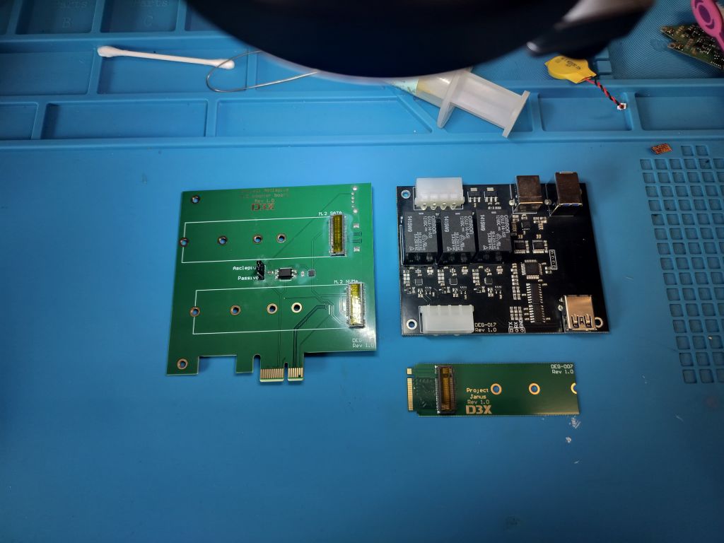

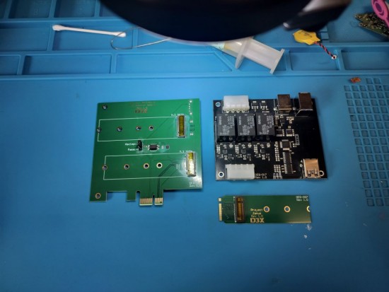

Yes, I'm working on a little kit consisting of the main power cycling board, an expansion card for M.2 drives (working on native NVMe support in OSC aswell),
and H10/H20 adapter for Optane drives.
