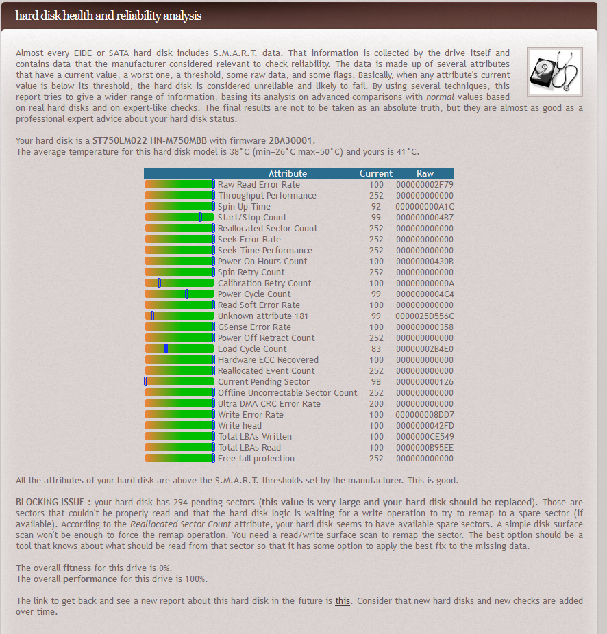

I have inspiron 7737 and diagnostic tools seem to say the hard drive is bad.

Yes, began failing.
Do you need data from it?

Hi ,
Copy your Imp Data ,Erase This Drive Get A New One Install os and dump data back to that ,You can also go in for a 250/500 GB SSD or if money is not a issue 1TB SSD
