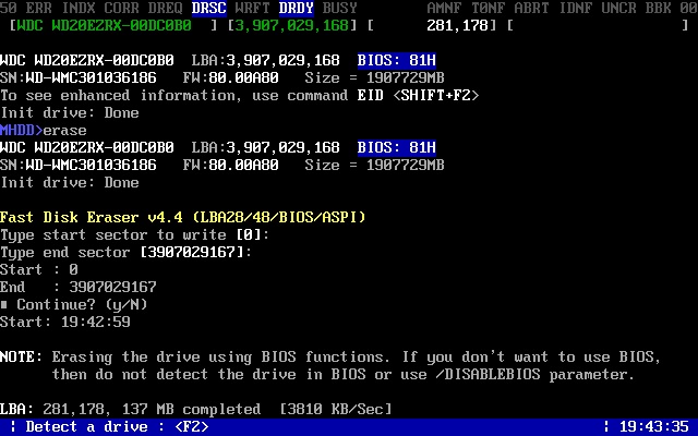

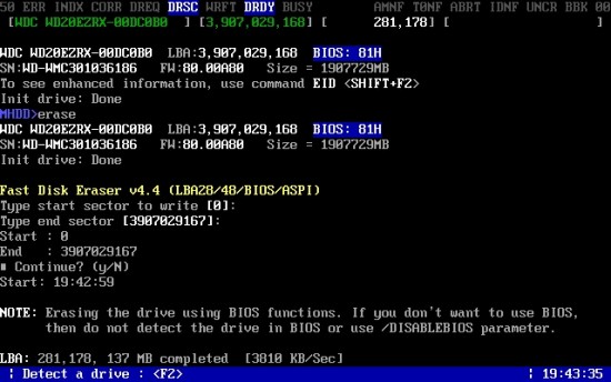

I tried a different motherboard in my PC and and I get extremely slow write speed in MHDD.
Also checked Data Lifeguard Diagnostics' full erase and from the remaining time shown I gather that the speed is normal, so the problem is encountered in MHDD only. Read scan (verify using F4) runs at normal speed. Erasing in Windows goes without speed issues either.
The motheboard has Intel G31 + ICH7 chipset. What do you think the problem is?

Thanks for your reply, but the solution was different.
It is really funny, but after I loaded optimized defaults, the issue got fixed. But which settings were incorrect is still a mystery.
Unfortunately MHDD, not being developed further, is getting more and more outdated. Lately I experimented with 2 new mobos, MHDD couldn't see the controller the hdd was attached to.

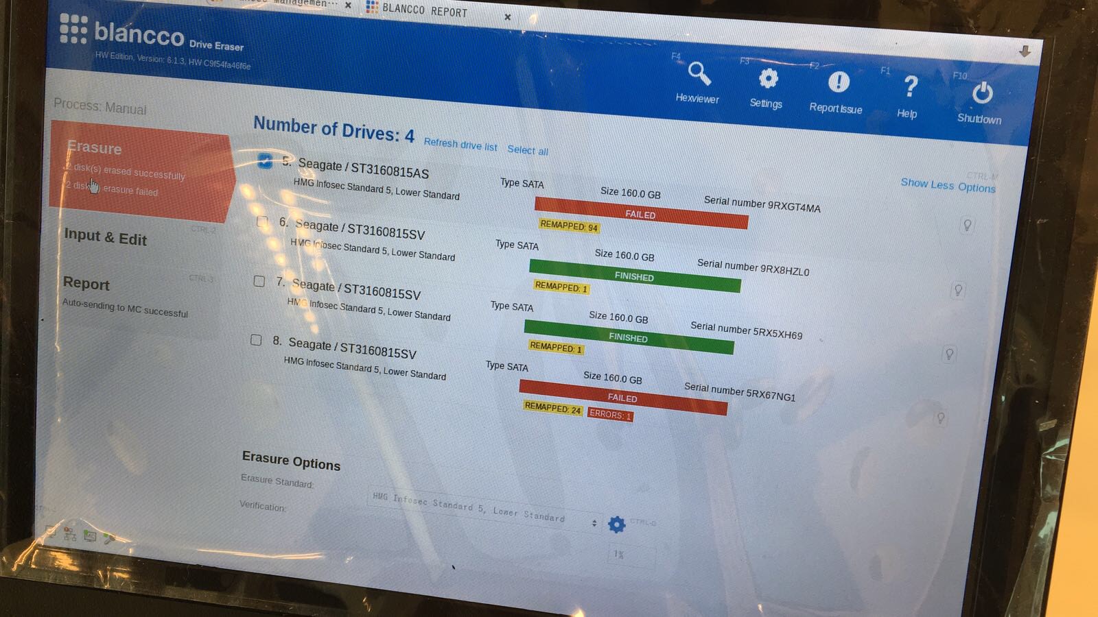

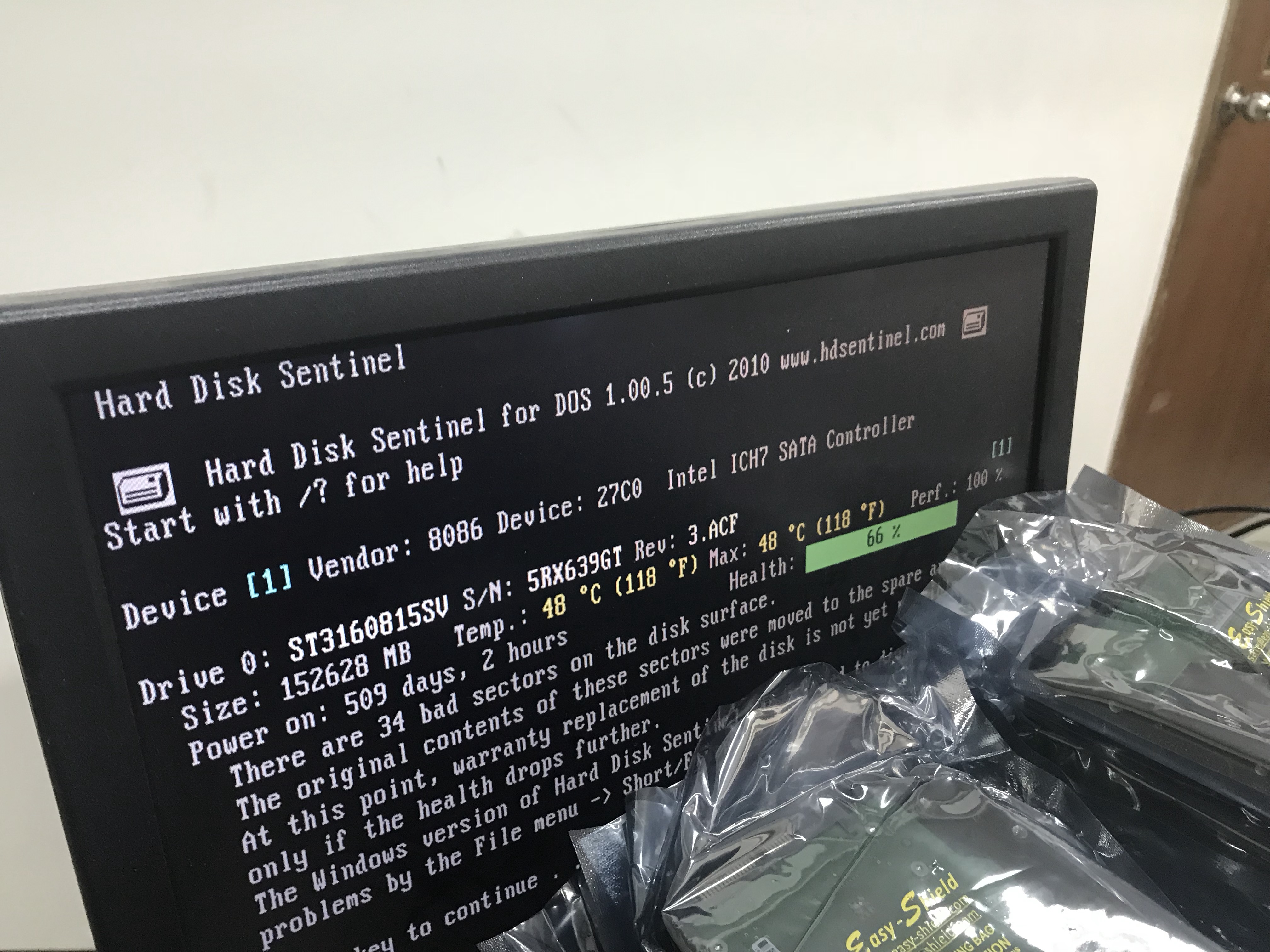

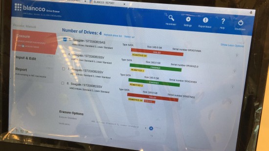

I have 20,000pcs and will use in game consul (not in pc) but still must be pass Sentinel software,
I used Blanco to remap the sector and it show all pass and good,but when i test with Seitial software show low health and bad sector.
File comment: After the test with BlNCCO.
