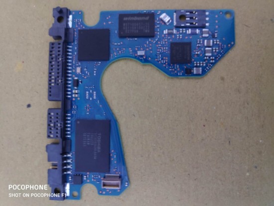

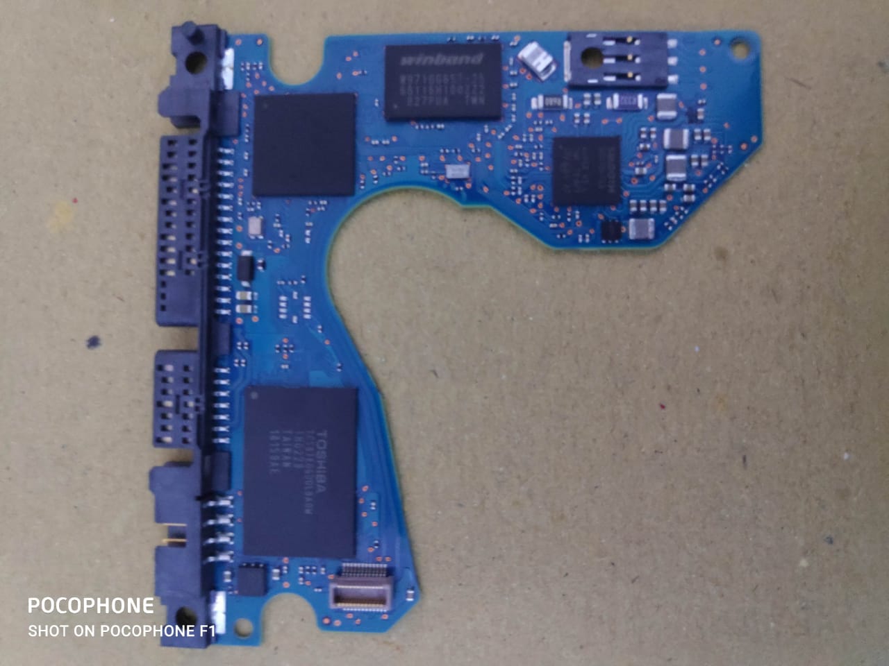

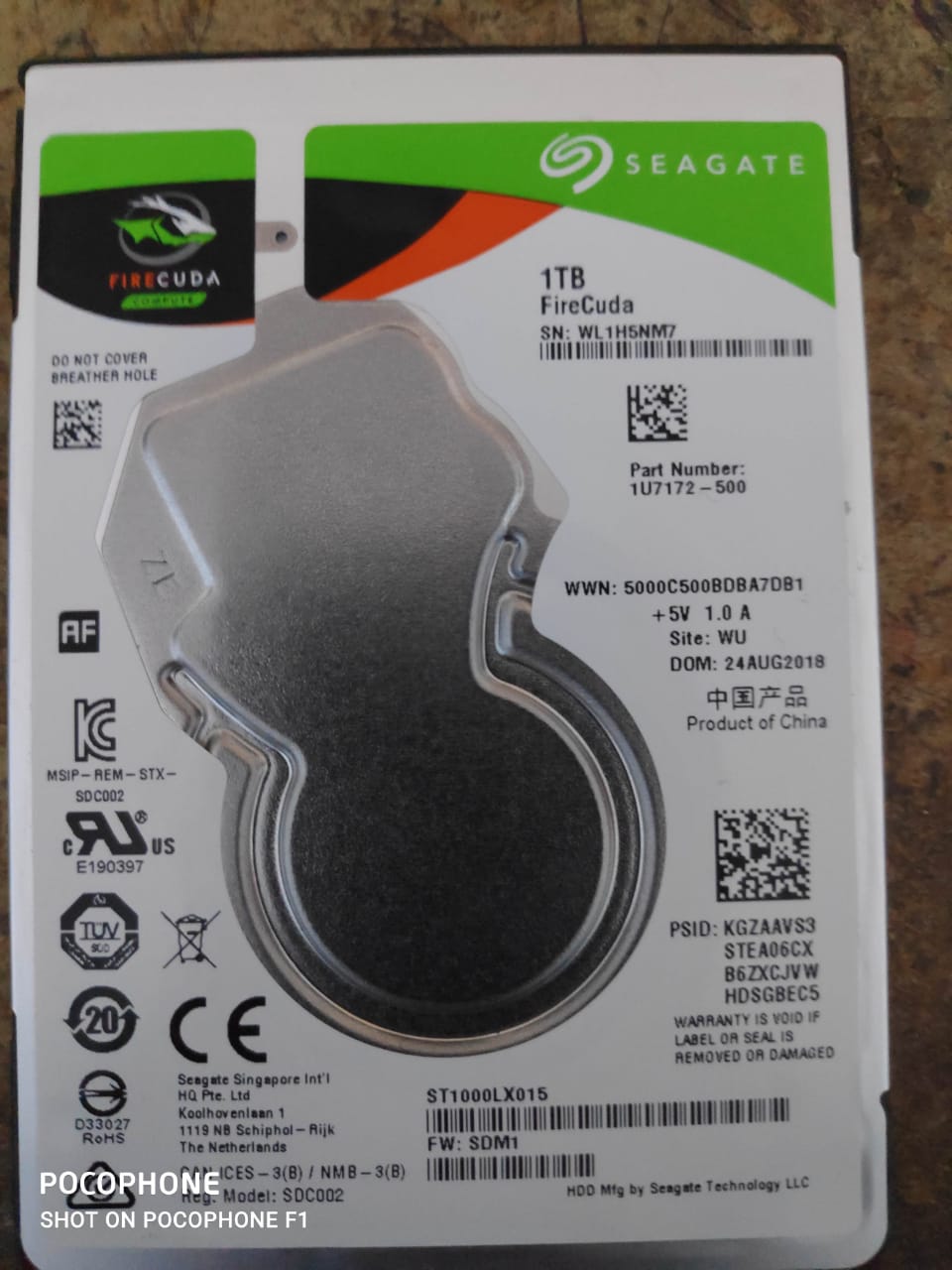

Hey guys, i want to ask some questions
I have HDD Segate Firecuda 1TB, but this hdd don't detect on computer. I want to try change the PCB, my question is what is the requirement for the donor hdd? (e.g it must have the same firmware or something like that).
And after i get the donor what should i exchange from hdd patient to donor? Maybe i should change the ROM? And where is the location of the ROM?
File comment: The PCB

File comment: The label

Well,
This has a NAND Chip And Replacing This is Not a Easy TASK ,Give This Job To Some Person Who Knows This Its Not a Replace ROM Kinda Job

what if the PCB is not a problem ?
need to diagnose properly before doing anything, NAND part is mostly a problem on SSHD drives.
better to send someone with proper tool and knowledge.
