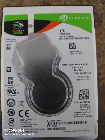

 Post subject: Donor HDD Seagate ST1000LX015
PostPosted: May 1st, 2020, 8:26
Joined: April 19th, 2006, 7:12
Posts: 63
Hey guys, i want to ask some questions
I have HDD Segate Firecuda 1TB, but this hdd don't detect on computer. I want to try change the PCB, my question is what is the requirement for the donor hdd? (e.g it must have the same firmware or something like that).
And after i get the donor what should i exchange from hdd patient to donor? Maybe i should change the ROM? And where is the location of the ROM?
File comment: The PCB
WhatsApp Image 2020-05-01 at 18.59.57.jpeg
WhatsApp Image 2020-05-01 at 18.59.57.jpeg [ 95.7 KiB | Viewed 10387 times ]
File comment: The label
WhatsApp Image 2020-05-01 at 18.59.58.jpeg
WhatsApp Image 2020-05-01 at 18.59.58.jpeg [ 104.69 KiB | Viewed 10387 times ]
 Post subject: Re: Donor HDD Seagate ST1000LX015
PostPosted: May 1st, 2020, 8:57
Well,
This has a NAND Chip And Replacing This is Not a Easy TASK ,Give This Job To Some Person Who Knows This Its Not a Replace ROM Kinda Job
 Post subject: Re: Donor HDD Seagate ST1000LX015
PostPosted: May 1st, 2020, 10:19
Joined: April 19th, 2006, 7:12
Posts: 63
Mr. Amarbir[CDR-Labs]
Thank you very much for the information
 Post subject: Re: Donor HDD Seagate ST1000LX015
PostPosted: May 1st, 2020, 11:34
Posts: 848
Location: Pakistan
what if the PCB is not a problem ?
need to diagnose properly before doing anything, NAND part is mostly a problem on SSHD drives.
better to send someone with proper tool and knowledge.
Data Recovery Pakistan
Users browsing this forum: No registered users and 30 guests
