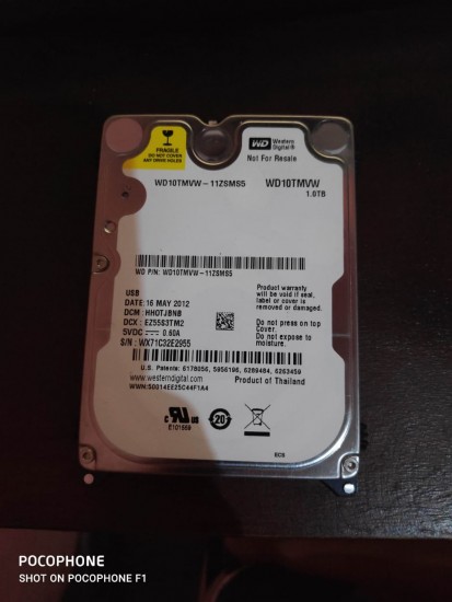

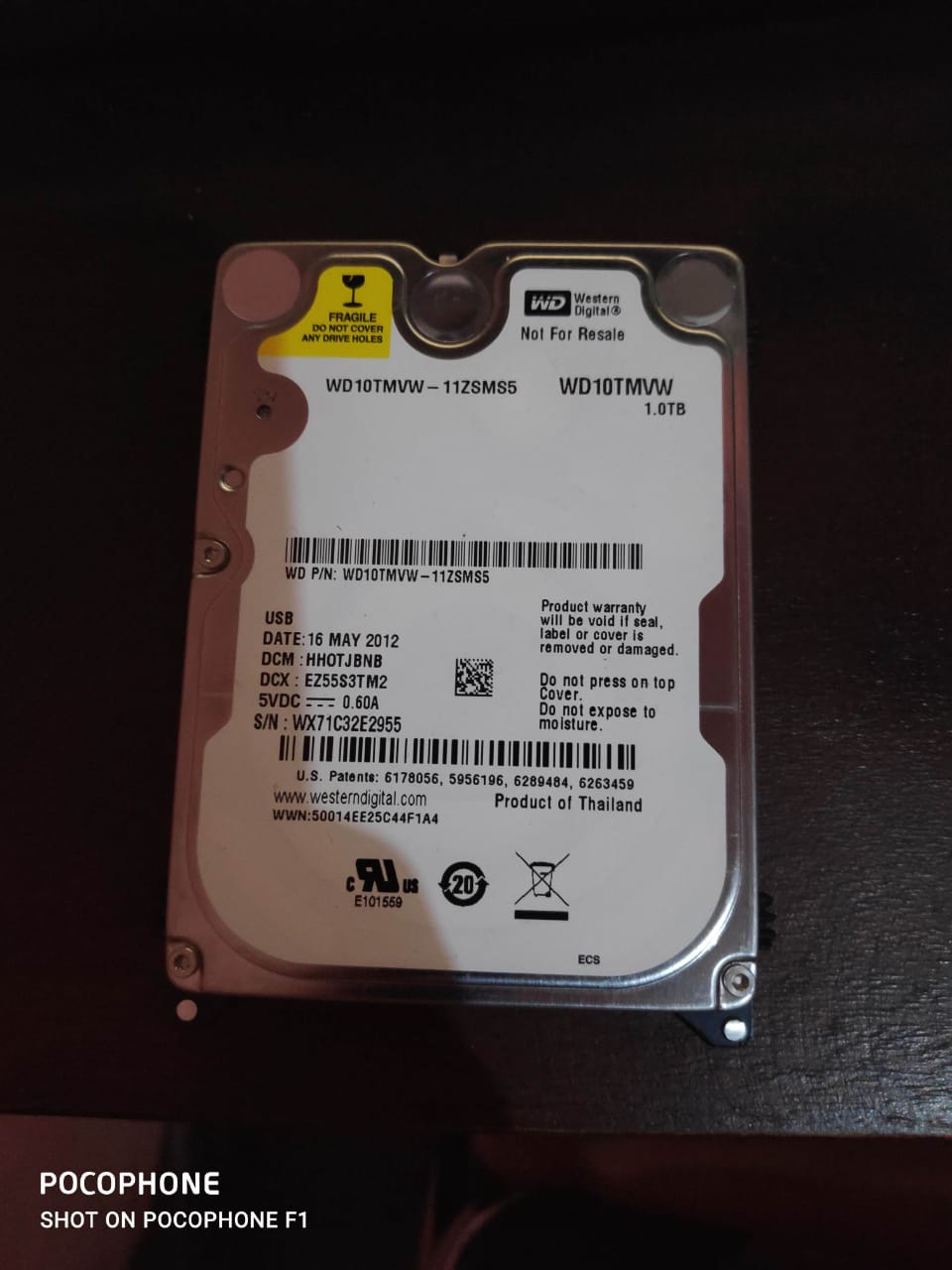

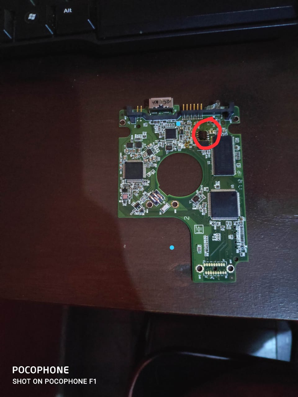

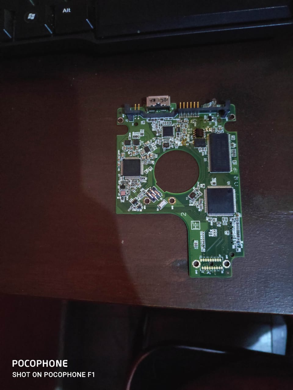

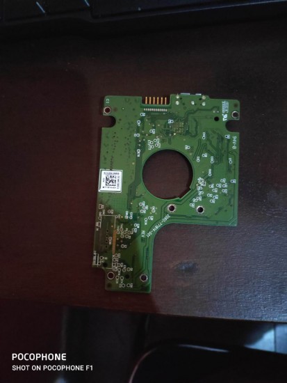

I have a locked WD My Passport 1TB. It's not purposely locked and i'm trying to open it with a software WD Marvel. But it has to be SATA. How can i change USB to SATA?
Thank you

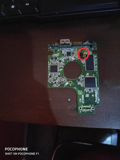

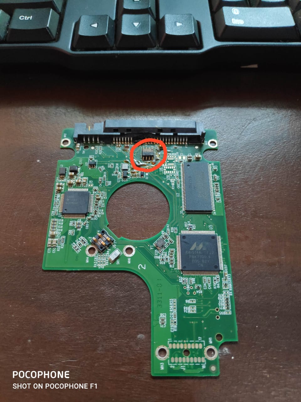

I already tried change the ROM USB (in the circle) to ROM SATA, but it stil doesn't detect. What should i do?
File comment: I changed the ROM to this
File comment: The ROM USB

Not the chip was removed.
Below U12
 Post subject: Re: WD My Passport WD10TMVW
PostPosted: May 21st, 2020, 1:01
Joined: April 19th, 2006, 7:12
Posts: 63
I tried that, but it's still not working
PostPosted: May 21st, 2020, 1:09
Posts: 396
Location: slovenija

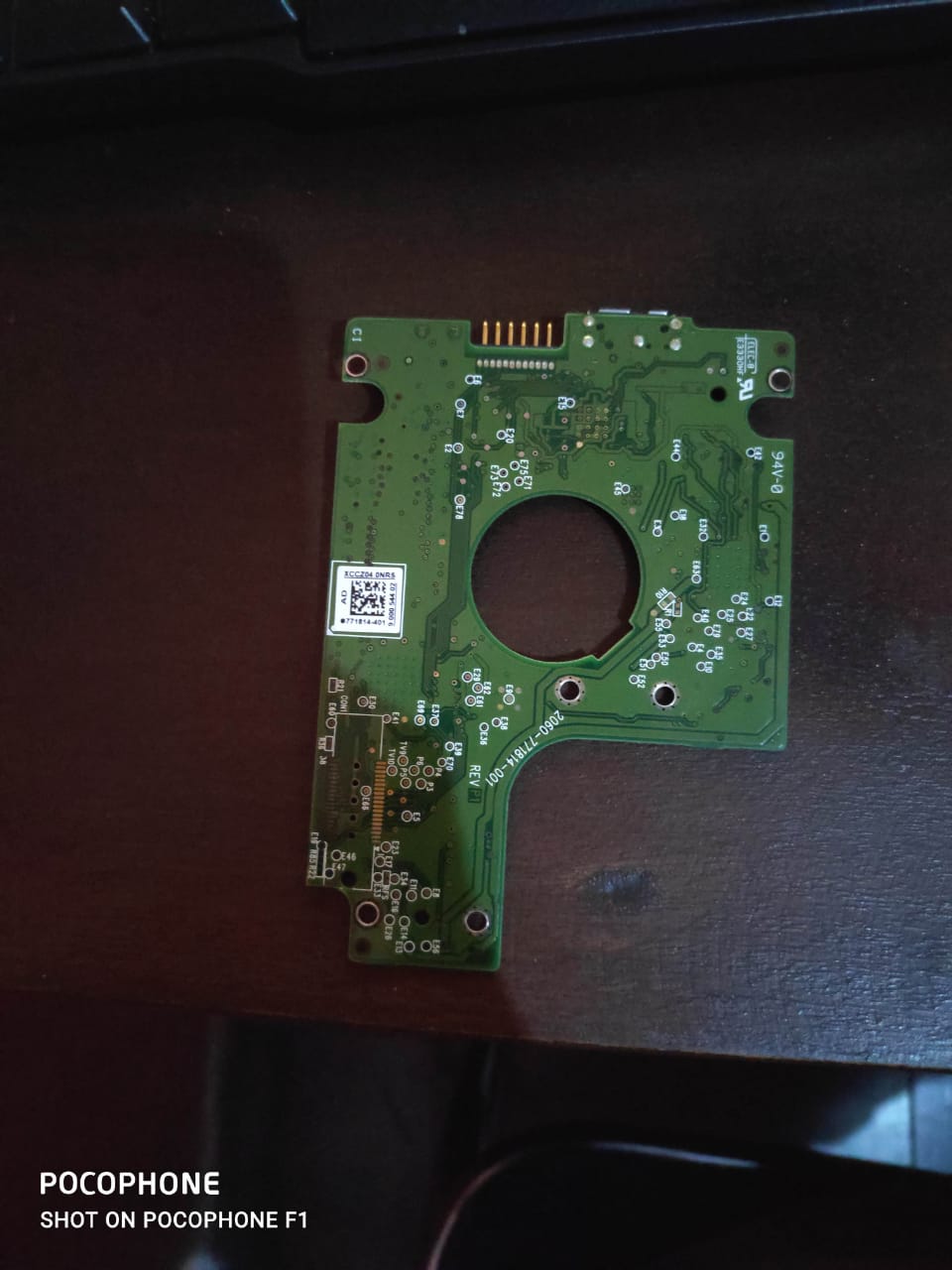

you need sata pcb 2060-771820
PostPosted: May 22nd, 2020, 23:26
Posts: 63
Yes, thank you. I successed open the password with WDMarvel software
