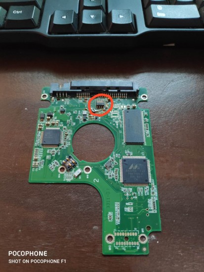

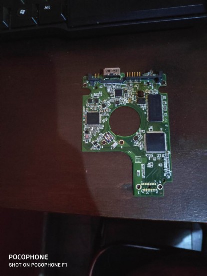

I have a locked WD My Passport 1TB. It's not purposely locked and i'm trying to open it with a software WD Marvel. But it has to be SATA. How can i change USB to SATA?
Thank you

I already tried change the ROM USB (in the circle) to ROM SATA, but it stil doesn't detect. What should i do?
File comment: I changed the ROM to this
File comment: The ROM USB

Not the chip was removed.
Below U12

I tried that, but it's still not working

you need sata pcb 2060-771820

Yes, thank you. I successed open the password with WDMarvel software
