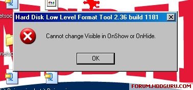

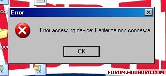

Hi, I have problem with run of this program on Windows 2000 .
Installation is correct (....i downloaded some old versions too ) , but after run this program write - "Error Acessing Device: Bad function" and "Cannot change Visible in OnShow or OnHide" - After this i look only on clear page in program window . What be missing in my system ? ...

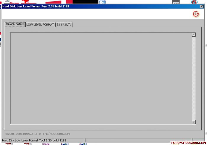

Edit:
I just start the program... the first error:
After Press "OK"... second error:
And Finally... The Empty Windows of the programs:
If you are need more information about my PC... please Ask Me.
