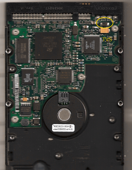

I am having problems with my Seagate 60 GB hard drive, and I would appreciate any help and answers to my questions below. Thank you.

I contacted a data recovery company called Datahounds, and had an e-mail exchange with an employee there named Cliff. He said that based on my description (reproduced above) and a photo that I sent him that it sounded like the TVS chip on the drive's PCB had gone bad. He sent the photo back with the TVS chip circled and said, "simply pry it off (with a small flathead screwdriver) and try to use the drive." If that doesn't work he recommended buying another drive of the same model and "simply remove the circuit board and place it on your drive."

- Based on the symptoms my drive is exhibiting does it sound correct that the issue is likely the TVS chip?
- Is it safe to just pry the TVS chip off with a screwdriver as recommended? Or should I try to cut through the metal/solder on the sides, or even try to de-solder it?
- The TVS chip has a fancy letter F on it (Fairchild Semiconductor logo?) followed by the letters "T133" then in the second line is "LC" or "LG" (probably LG). If I remove the chip, then should I try to find a replacement one before powering up the drive? I have googled extensively but can not seem to find info on this chip anywhere on-line. Does anyone know where to find this chip? Should I just remove it from another drive of the same model?

File comment: Picture of drive's PCB with TVS chip "T133" circled

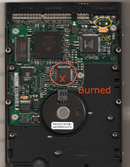

I went ahead and removed the TVS chip from the PCB board on the drive. Then I tried powering up the drive (in an external case) and heard no signs of the drive spinning. After 15-20 seconds of the power being on I saw a small amount of smoke and immediately turned the drive off. Upon inspection I saw one of the other ICs on the board was now slightly burned. I'm attaching the same picture with the chip that is now burned circled.
My same questions above still stand. Specifically on locating a replacement PCB, whether the exact same firmware is needed, and requests for recommendations of a drive repair company.

A catastrophical sequence of errors.
Now the 1st step is to check the drive excluding the PCB for internal damage, then....
the worst idea was to leave the drive unprotected AND not checking the power.

The damaged chip is the motor controller.
I'm not sure, but I believe in this model series you only need to match the firmware version. I don't believe there are any adaptive data in the parallel flash. Also, the boards must be similar in layout, ie same ST MCU and same Agere read channel IC.
BTW, the TVS diode is a 12V part. The "T133" marking is a YWW date code, ie week 33 of 2001. I would examine the output voltage of your power supply, particularly its +12V rail.
Thanks. I ordered a replacement drive with 5.05 firmware. It costs a $100, but if it works it will be well worth it. Thanks.

Watch out for your drive you ordered and paid for. If you go replacing the PCB and you have a preamp problem well guess what up in smoke on the new PCB you have ordered. Maybe it is time to have this drive tested by someone who knows what to look for and can fix it correctly. You drive, your money, and your experience on this one. There was a reason the Motor controll chip burned on this one. You have to correct this problems first before moving on to the other problem that is at hand.
