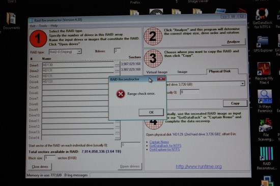

Hi Forum,

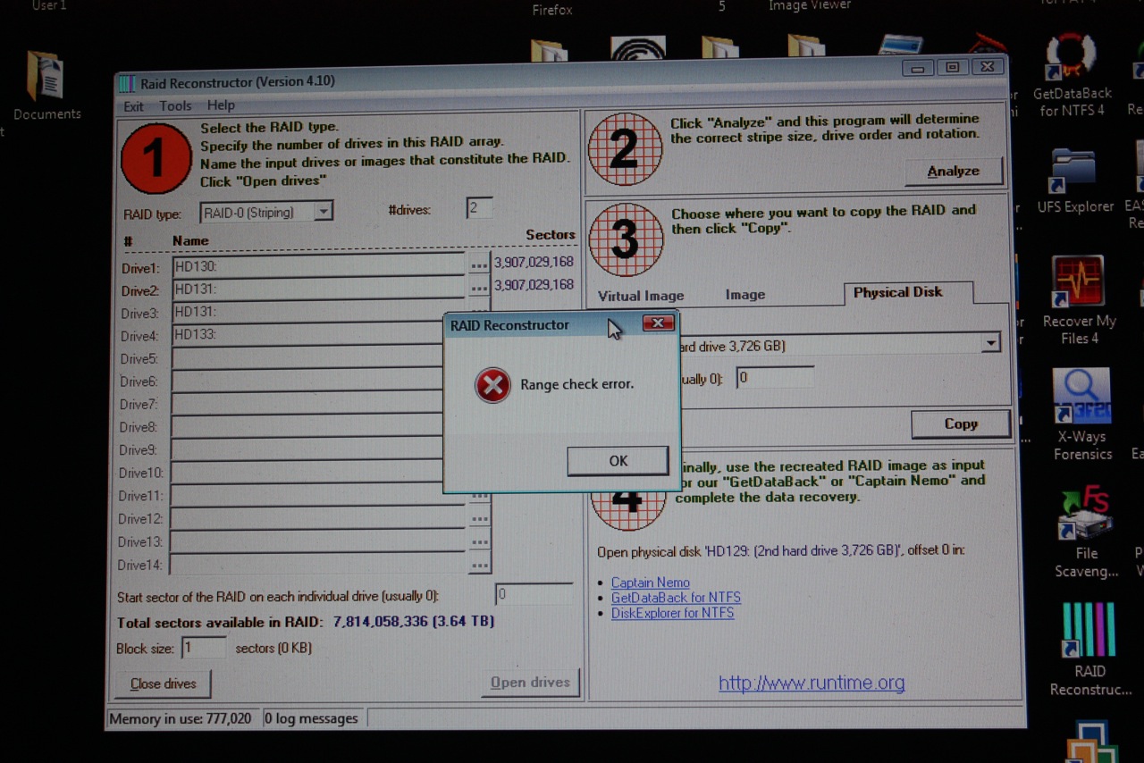

I've used Raid Reconstructor quite a few times to re-stripe 1 sector RAIDs. Right now, I have two 2x2tb RAIDs (Mac formatted) with 1 sector stripes. I'm having problems re-striping them to a WD My Book 4tb drive.

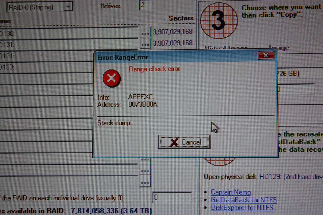

I've tried the first job 4 times, the second job twice, they are both stopping at around 55% everytime. I've tried various connection methods to my computer (USB, FireWire, and eSata). Crashed using all methods. The program usually gives an error message, like this:
File comment: error: "range check error"
I'm running the latest version of RR (4.10) and I'm on Vista (32bit). I'm sure the suspect drives aren't the problem because I've already cloned them and there are no issues.
Does anyone know if this is a Vista 32 bit issue? I'm not sure I've re-striped to a 4tb drive before, but I thought so.
Or is this a Raid Reconstructor issue (Runtime doesn't think so, but their support will get back to me)? Is there another program that does what Raid Reconstructor can do (1 sector stripe)?

It appears that you're hitting a 1 TiB limit.
1 TiB / 2 TB = (2^40) / (2 x (10^12)) = 0.5498

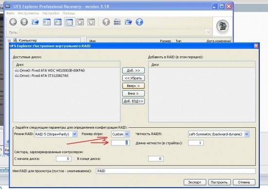

Use UFS explorer Pro( it could 1 sector block-size too)

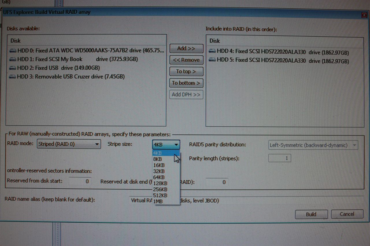

I'm not seeing it, any help?

bcometa wrote:
Realy ? :D

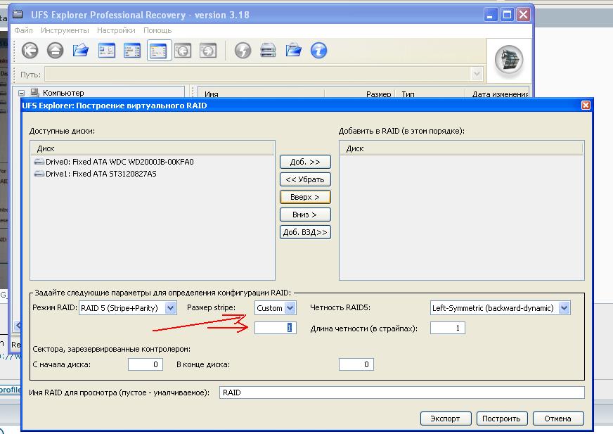

DR-Kiev wrote:
Realy ? :D
Woh! Thanks for that. I don't have "custom" but I'm running an older version. Getting 3.18 now, hopefully that's a new feature. Thanks again.

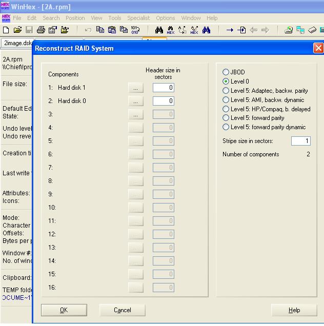

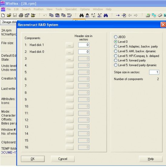

bcometa wrote:
I tried X-Ways Forensics but it doesn't allow 1 sector stripe either.
Your programs from stone age ? :)

:) I find one that works and stick with it. Buying new 4.x upgrade for UFS now, looks like a good chance! Thanks again for your help.
Wait , for 4.6.3 and higher you need Raid plugin which need buy too.
Help this: UFS Explorer Professional 3.18.2 ,( not UFS Explorer Standart 4.x.x)

Yep -- Got it, but it's pretty cool because they also have a VIM import plugin so that should save me about 2 DAYS!

One more time: THANK YOU DR-Kiev! The VIM import worked perfectly and now moving files directly to WD4tb. You rock!!!!!!!!!!!!
