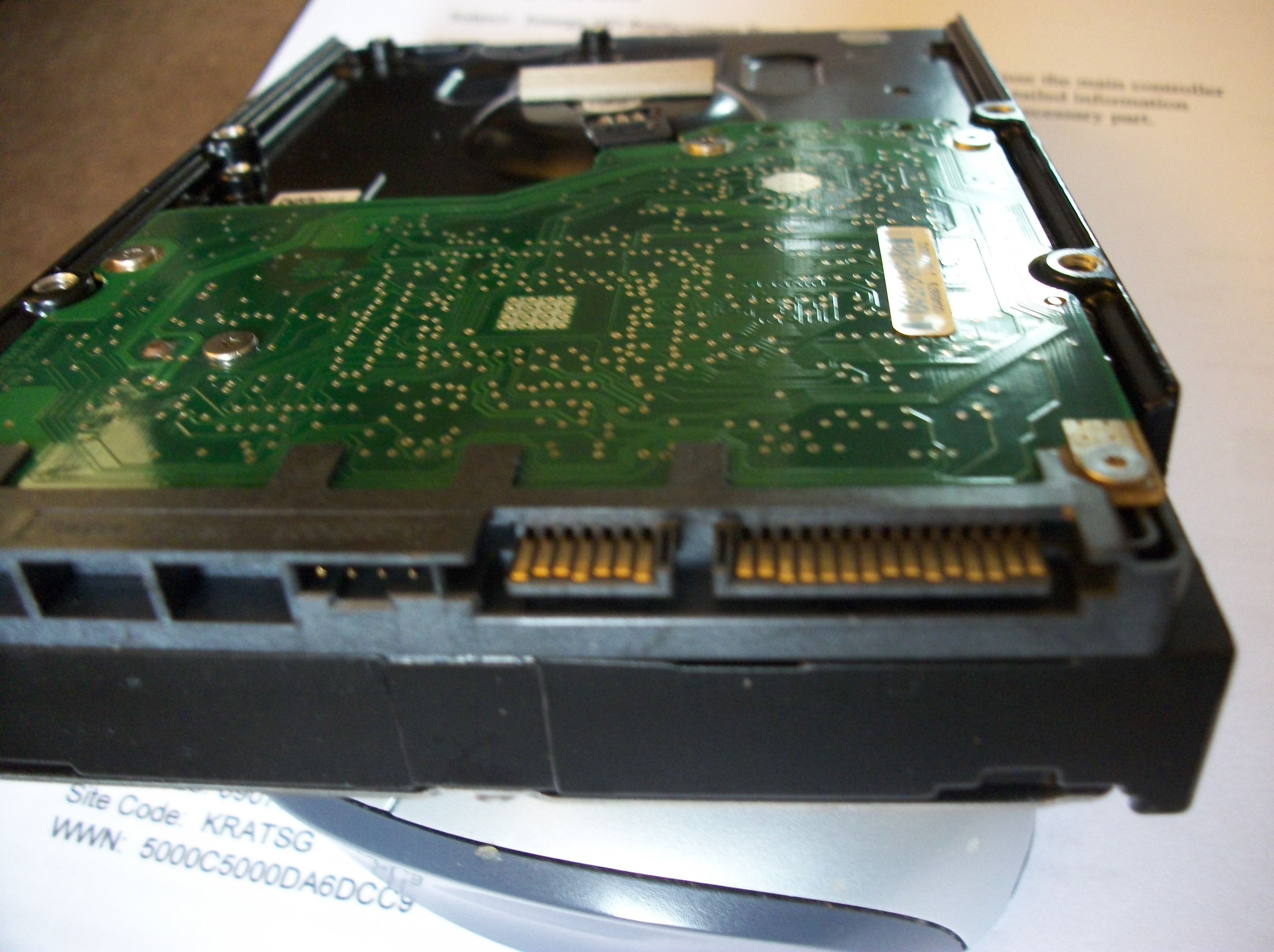

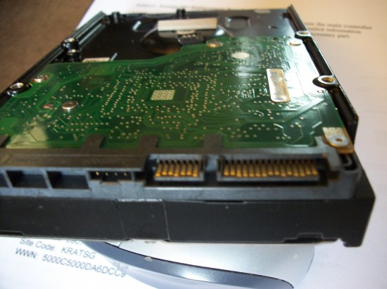

After removing the external controller I discovered that the internal Seagate Barracuda 7200.11 HD does not have the standard HD internal EIDE connections. So that option is out. What now?

What connection is it? Post pic if you do not know.

That would be SATA rather than IDE.
Your Iomega unit is probably not the problem. If it still spins up the drive, it has most likely not "burned out".
The attached pictures show the HD connections. While the external description shows this to be an IOMEGA LDHD-UP 1TB HD, the internal drive shows it to be a Seagate HD Drive, Barracuda 7200.11.
