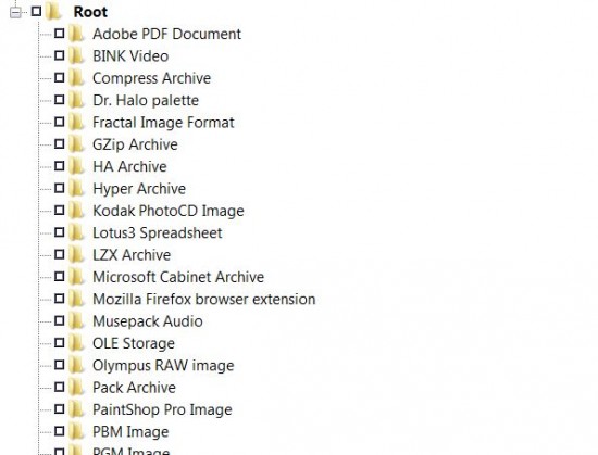

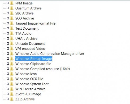

 Post subject: WD Smartware drive formatted . Data ?
PostPosted: May 6th, 2012, 15:30
Joined: May 19th, 2010, 13:31
Posts: 78
Hello.
Is is possible to recover the pre existed data from WD Smartware locked drive after formatting it.
Drive was locked by the password. and it a was then formatted. Can i recover the original contents.
I only need pictures (i guess .jpg) out of it.
I ran Rstudio but couldnt got my files, instead i got other type of files. Have a look on the attached files and guide me the possibilities.
Thank you.
File comment: 2
Untitled1.jpg [ 41.29 KiB | Viewed 4656 times ]
File comment: 1
Untitled.jpg [ 37.03 KiB | Viewed 4656 times ]
 Post subject: Re: WD Smartware drive formatted . Data ?
PostPosted: May 6th, 2012, 15:31
Joined: May 19th, 2010, 13:31
Posts: 78
Are files encrypted into some other file type?
 Post subject: Re: WD Smartware drive formatted . Data ?
PostPosted: May 6th, 2012, 15:54
Joined: July 7th, 2010, 4:45
Posts: 924
Depends on how it was formatted?
The data is encrypted via a chip on a pcb and as far as i understand it the encryption/decryption key is overwritten with a new one when you use wd smartware to format it thus making recovery impossible.
If the drive was already unlocked & then formatted via my computer then possibly if it was a quick format. If a standard/long format in vista or win7 then no as it overwites the sectors.
Loki
 Post subject: Re: WD Smartware drive formatted . Data ?
PostPosted: May 13th, 2012, 15:54
Joined: May 19th, 2010, 13:31
Posts: 78
Thx loki.
I got some backup from my other pc and usb.
As far as i researched, its very hard on DIY base to recover.
Again thx for replying.
Users browsing this forum: mecrazzy243 and 75 guests
