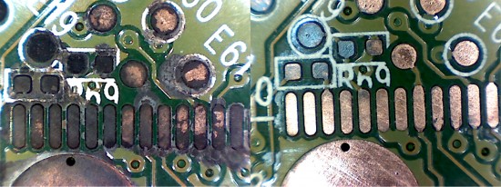

Hello.
I want to recover this disk (WD10EADX with 2060-771640-003 REV A PCB).
I found some spots on PCB, maybe it's corrosion. Photos for more info.
This disk was used in external box and exactly same spots are on USB bus in external box.
My plan is to buy another 2060-771640-003 REV A PCB and try to replace original PCB. I found 1050 number on IC, so that's probably PCB's date of manufacture.
I'm able to switch BIOS IC (U12?) by myself (I have all needed hardware and friend skilled in electronics - soldering).
I want to ask first before I buy some PCB if anyone can help me to decide what happened and if PCB change can help.
Thanks for any ideas.
Josef

What is the symptom?
The discolouration is oxidisation. You can clean it up by gently rubbing it with a soft white pencil eraser.
FWIW, I can see a "5110" number on the PCB. Probably a WWYY date code, ie week 51 of 2010.

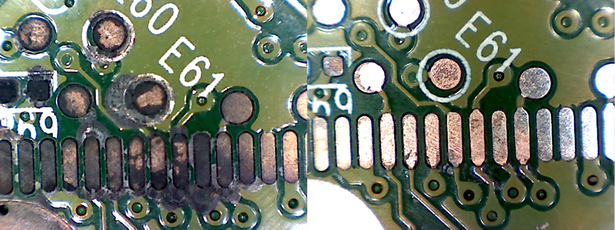

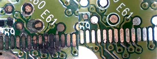

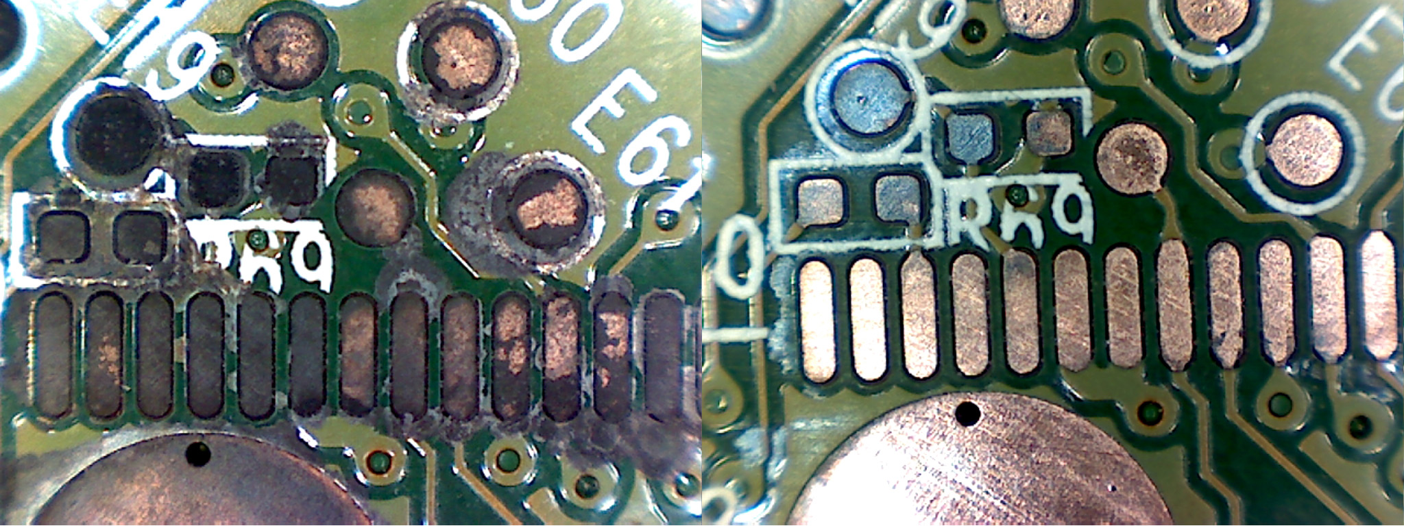

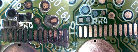

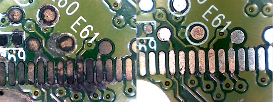

I want to share end of my story with you guys.
Today I cleaned PCB using wooden pick, microscope and pencil rubber where it was possible. I tried to plug it into PC vie external USB bus.
System found a drive, but didn't find any partition. So I used brilliant SW TestDisk (http://www.cgsecurity.org/wiki/TestDisk - it saved my life many times) to get all my important data from disk (quick search was enough). They were copied successfully. I also let it write actual partition table back to disk and after reconnect it showed in system properly. I'm not going to use that disk anymore, since it is not reliable anymore. But I'm really happy.
Thanks for all your help. Mainly for ideas about PCB changing. You were true. It definitely wasn't case for PCB change.

I have results before and after cleaning if someone is interested.
