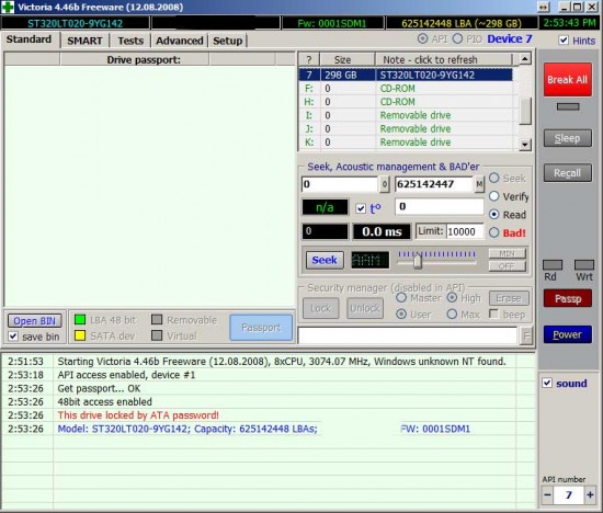

Post new topic Reply to topic  [ 25 posts ]  Go to page Previous  1, 2
 Post subject: Re: Seagate Momentus Thin ATA Unlock Possible?
PostPosted: December 8th, 2013, 17:15
Joined: October 24th, 2005, 17:04
Posts: 242
dick
Job done and many thanks to Moltke!
many thanks :oops:
 Post subject: Re: Seagate Momentus Thin ATA Unlock Possible?
PostPosted: December 8th, 2013, 18:51
Joined: July 23rd, 2013, 13:23
Posts: 17
Location: los angeles
Does Victoria work on Windows 7, 64-bit? I keep getting portIO errors and I can't enter the password to unlock it.
 Post subject: Re: Seagate Momentus Thin ATA Unlock Possible?
PostPosted: December 8th, 2013, 19:32
Joined: July 23rd, 2013, 13:23
Posts: 17
Location: los angeles
This is what I see on my Victoria:
File comment: This is my Victoria Screen, after ignoring all those error messages.
victoriamainscreena.jpg [ 73.38 KiB | Viewed 8546 times ]
error3.PNG [ 3.33 KiB | Viewed 8546 times ]
error2.PNG [ 2.24 KiB | Viewed 8546 times ]
error1.PNG [ 2.72 KiB | Viewed 8546 times ]
 Post subject: Re: Seagate Momentus Thin ATA Unlock Possible?
PostPosted: December 9th, 2013, 14:23
Joined: July 23rd, 2013, 13:23
Posts: 17
Location: los angeles
Spildit wrote:
n0fx wrote:
Does Victoria work on Windows 7, 64-bit? I keep getting portIO errors and I can't enter the password to unlock it.
I don't think that the PortTalk driver will work on 64 bit machines. At any rate try to copy the drive to the system32 folder.
Again i don't think it will work because the requirments of 64 bit OS regarding drivers....
You will need to use another machine or boot from a Hirens Boot mini windows XP.
Ok, thanks. I'll use a Windows XP machine.
 Post subject: Re: Seagate Momentus Thin ATA Unlock Possible?
PostPosted: December 10th, 2014, 9:46
Posts: 347
Location: india
Seagate Momentus Thin 320GB
Date: 12437
Site: WU
Model: ST320LT020
PN: 9YG142-071
FW: 0003LVM1
The script finished and it created a c:\_dumps\__PWD.BIN file with content
1E 1E 1E 00 00 00 00 00 00 00 00 00 00 00 00 00
00 00 00 00 00 00 00 00 00 00 00 00 00 00 00 00
Next what i have to do?
Please Advice
Post new topic Reply to topic  [ 25 posts ]  Go to page Previous  1, 2
Users browsing this forum: No registered users and 165 guests
