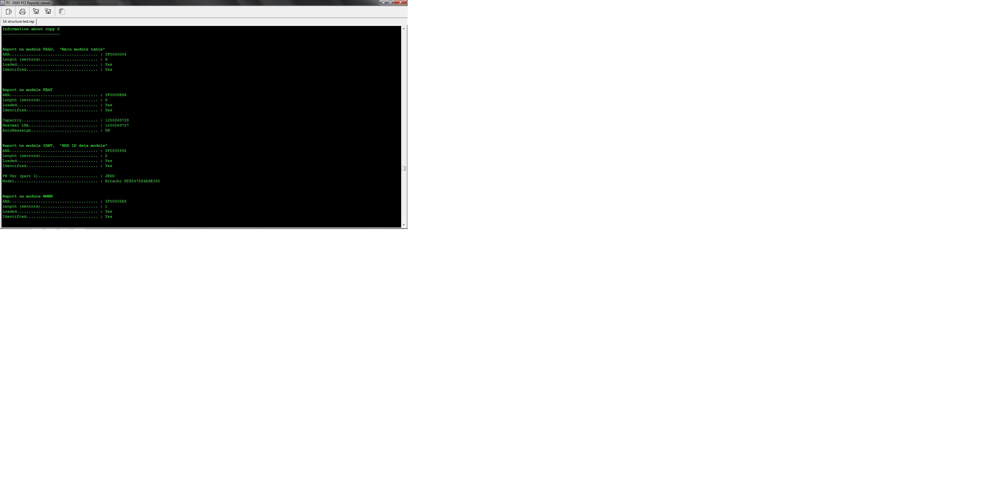

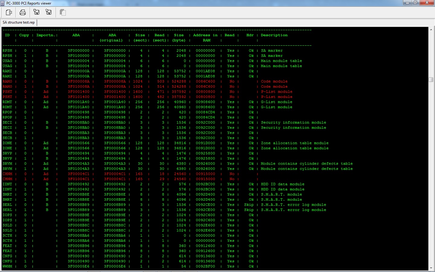

 Post subject: Hitachi HTS547564A9E384 Recovery
PostPosted: November 16th, 2014, 11:47
Joined: February 13th, 2014, 12:13
Posts: 166
Location: Isfahan
Hello All,
I have a Hitachi HTS547564A9E384 hdd and want to recovery.
This hdd falling down when turn on.
Still detect it and no clicking sound.
All sectors have an UNC error and can not image it.
Atola report PCB and Firmware are pass.
PC3k report some of modules have an error and can not clear G-list and P-list.
Upload PC3k report.
I think this hdd need hea surgery.
What you think?
Thanks.
rep2.jpg [ 366.13 KiB | Viewed 8935 times ]
rep1.jpg [ 407.93 KiB | Viewed 8935 times ]
Phoenix Computer Forensic Laboratory
http://www.databack.ir
 Post subject: Re: Hitachi HTS547564A9E384 Recovery
PostPosted: November 17th, 2014, 6:31
Joined: July 6th, 2013, 15:13
Posts: 311
Location: ISLAMABAD
By seeing picture,
RAMO module is damaged, it is a overlay module.
P-list module is also damaged, and its backup modules which is PDM1 and PDM2 are also damaged.
CHNM = Adaptive module .
You are lucky that your hdd is still in detection.
Try use pc3k utility and import p and g list in program, then start data extractor. I hope it will help you.
Waqas Ali
 Post subject: Re: Hitachi HTS547564A9E384 Recovery
PostPosted: November 17th, 2014, 7:05
Posts: 842
Location: Pakistan
also read here
http://acelaboratory.ru/forum/viewtopic ... f886783fc6
Data Recovery Pakistan
 Post subject: Re: Hitachi HTS547564A9E384 Recovery
PostPosted: November 17th, 2014, 10:45
Joined: February 13th, 2014, 12:13
Posts: 166
Location: Isfahan
waqas_ali766 wrote:
By seeing picture,
RAMO module is damaged, it is a overlay module.
P-list module is also damaged, and its backup modules which is PDM1 and PDM2 are also damaged.
CHNM = Adaptive module .
You are lucky that your hdd is still in detection.
Try use pc3k utility and import p and g list in program, then start data extractor. I hope it will help you.
Waqas Ali
Hi Waqas,
With PC3k can not import g-list and p-list!!!
Phoenix Computer Forensic Laboratory
http://www.databack.ir
 Post subject: Re: Hitachi HTS547564A9E384 Recovery
PostPosted: November 17th, 2014, 11:35
Without the P-List, I think you're in trouble.
 Post subject: Re: Hitachi HTS547564A9E384 Recovery
PostPosted: November 17th, 2014, 12:04
Joined: February 13th, 2014, 12:13
Posts: 166
Location: Isfahan
data-medics wrote:
Without the P-List, I think you're in trouble.
I think need head replacement, because can not create head map with Atola & PC3k.
I have not test to repair P-List Module because have a risk!!!
Phoenix Computer Forensic Laboratory
http://www.databack.ir
 Post subject: Re: Hitachi HTS547564A9E384 Recovery
PostPosted: November 17th, 2014, 13:59
Posts: 842
Location: Pakistan
there are bad sectors in SA, so changing head will not help am afraid
is there factory copy available other than Copy 0 and Copy 1 ?
Data Recovery Pakistan
 Post subject: Re: Hitachi HTS547564A9E384 Recovery
PostPosted: November 17th, 2014, 14:59
Joined: February 13th, 2014, 12:13
Posts: 166
Location: Isfahan
Here other reports
rep4.jpg [ 210.13 KiB | Viewed 8822 times ]
rep3.jpg [ 208.83 KiB | Viewed 8822 times ]
Phoenix Computer Forensic Laboratory
http://www.databack.ir
cron
