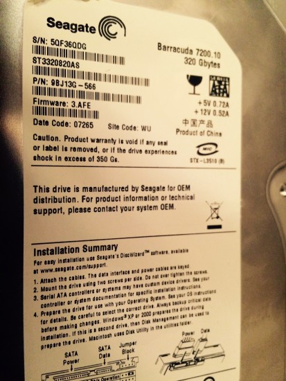

 Post subject: Seagate ST3320820AS head damage
PostPosted: March 28th, 2015, 19:24
Joined: March 28th, 2015, 19:13
Location: Scottsdale
I dropped the drive. It stopped booting and started making a clicking noise. I opened it and noted that the head looks damaged.
How do I find a replacement head? How do I find the exact same drive and head? Picture of drive label attached.
I am going to take the risk and do the replacement at home. Any advice appreciated.
FullSizeRender.jpg [ 666.77 KiB | Viewed 5725 times ]
 Post subject: Re: Seagate ST3320820AS head damage
PostPosted: March 28th, 2015, 20:29
Posts: 1388
Location: isreal
katven wrote:
Any advice appreciated.
my advice: don't do this
 Post subject: Re: Seagate ST3320820AS head damage
PostPosted: March 29th, 2015, 3:52
Joined: March 8th, 2015, 21:02
Posts: 17
Location: Philippines
It's more trouble than its worth, especially if you have a lot of important stuff in your drive.
 Post subject: Re: Seagate ST3320820AS head damage
PostPosted: March 29th, 2015, 12:05
Joined: June 8th, 2006, 19:44
Posts: 3144
Location: Atlanta, GA
Knowing that you will not succeed, what is your "Plan B"?
http://www.datasaversllc.com
 Post subject: Re: Seagate ST3320820AS head damage
PostPosted: March 30th, 2015, 5:05
Posts: 3551
katven wrote:
I opened it and noted that the head looks damaged.
Given the fact that these drives do not have a parking ramp, but a parking zone on the platters, how did you inspect the heads and decided they are damaged?
jermy wrote:
katven wrote:
Any advice appreciated.
my advice: don't do this
Mine too.
 Post subject: Re: Seagate ST3320820AS head damage
PostPosted: March 30th, 2015, 10:29
Posts: 1419
My question is also, How do you know heads are damaged?
www.datarecoveryne.com
Users browsing this forum: mima85 and 70 guests
