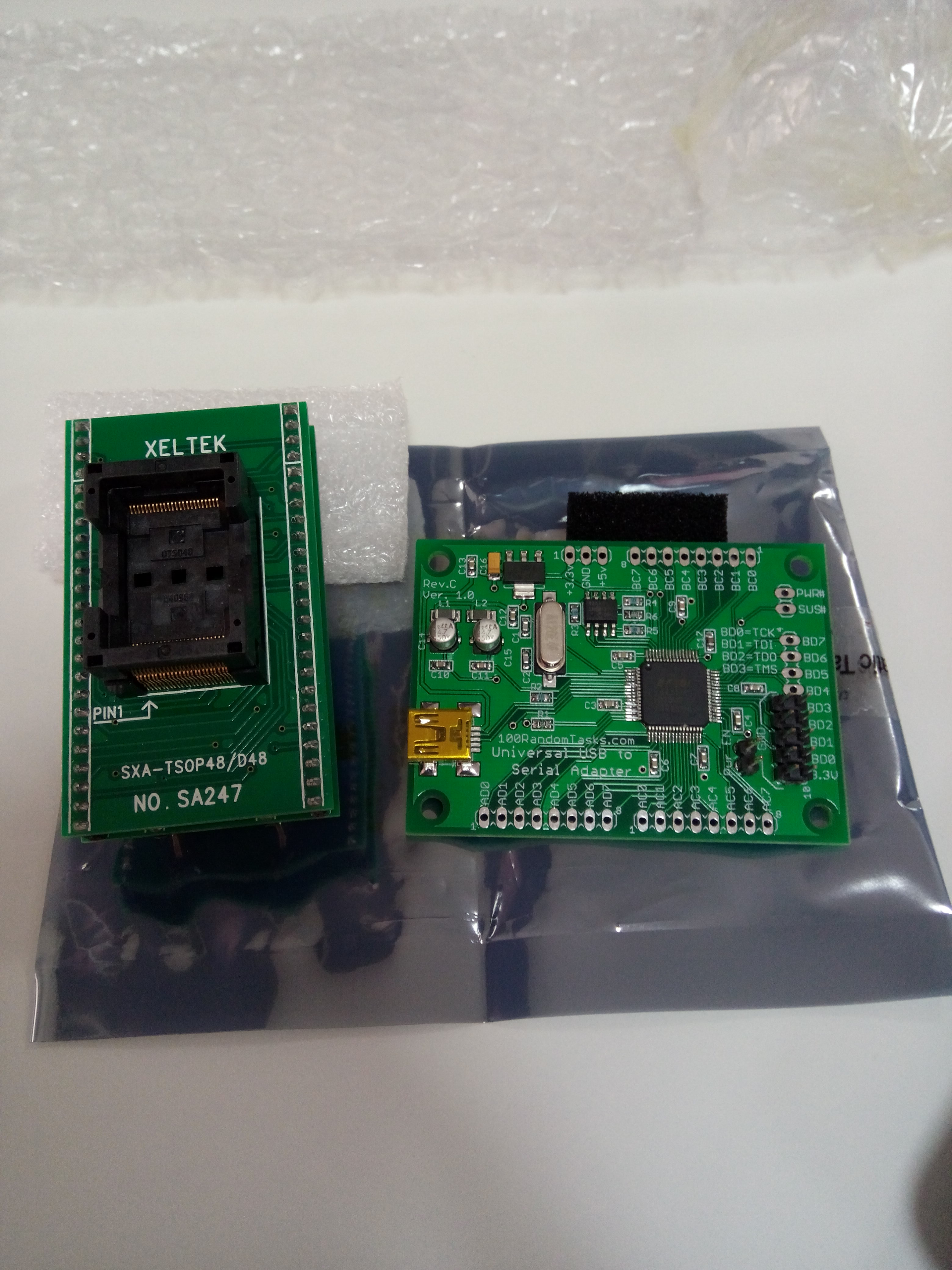

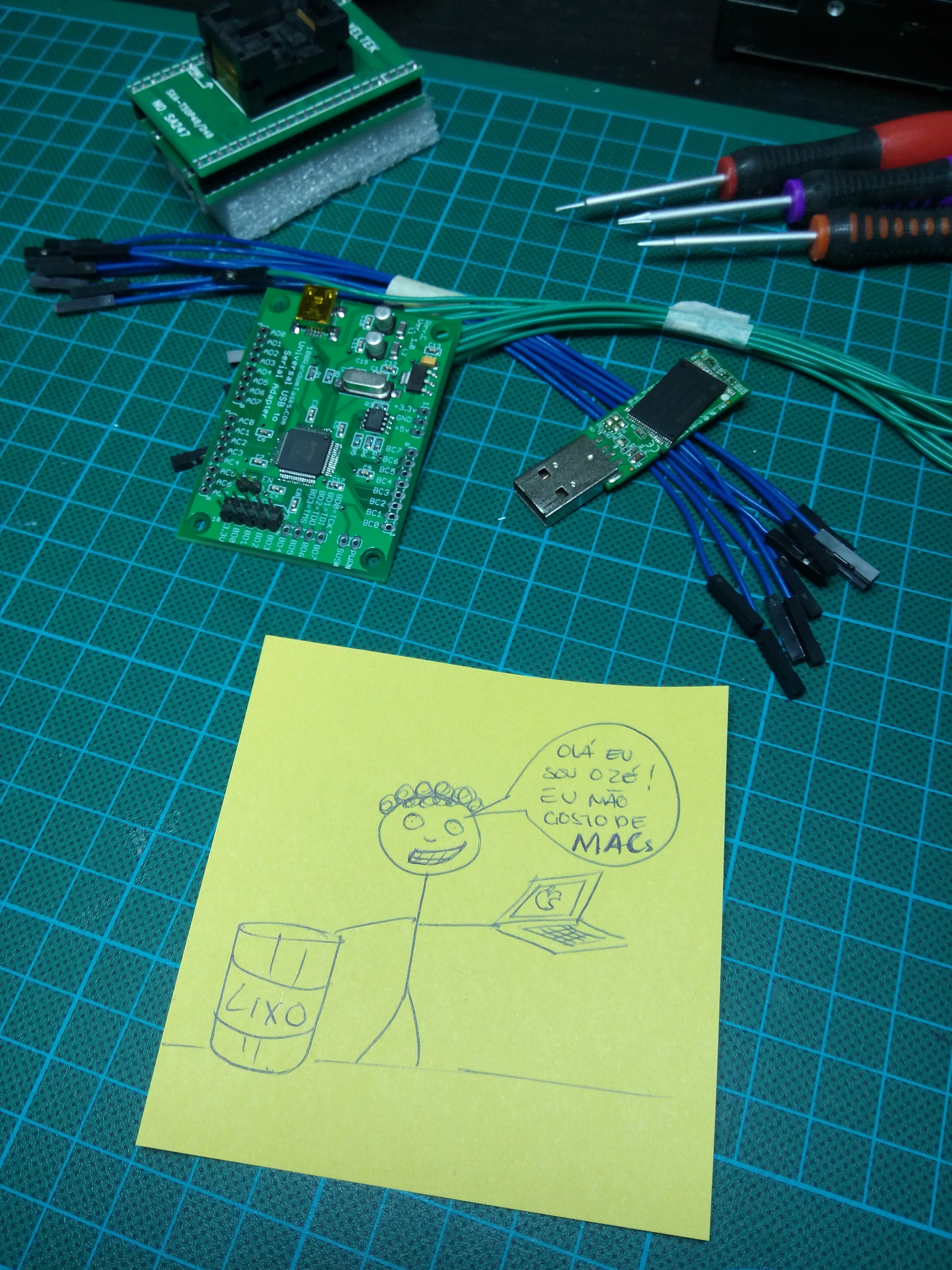

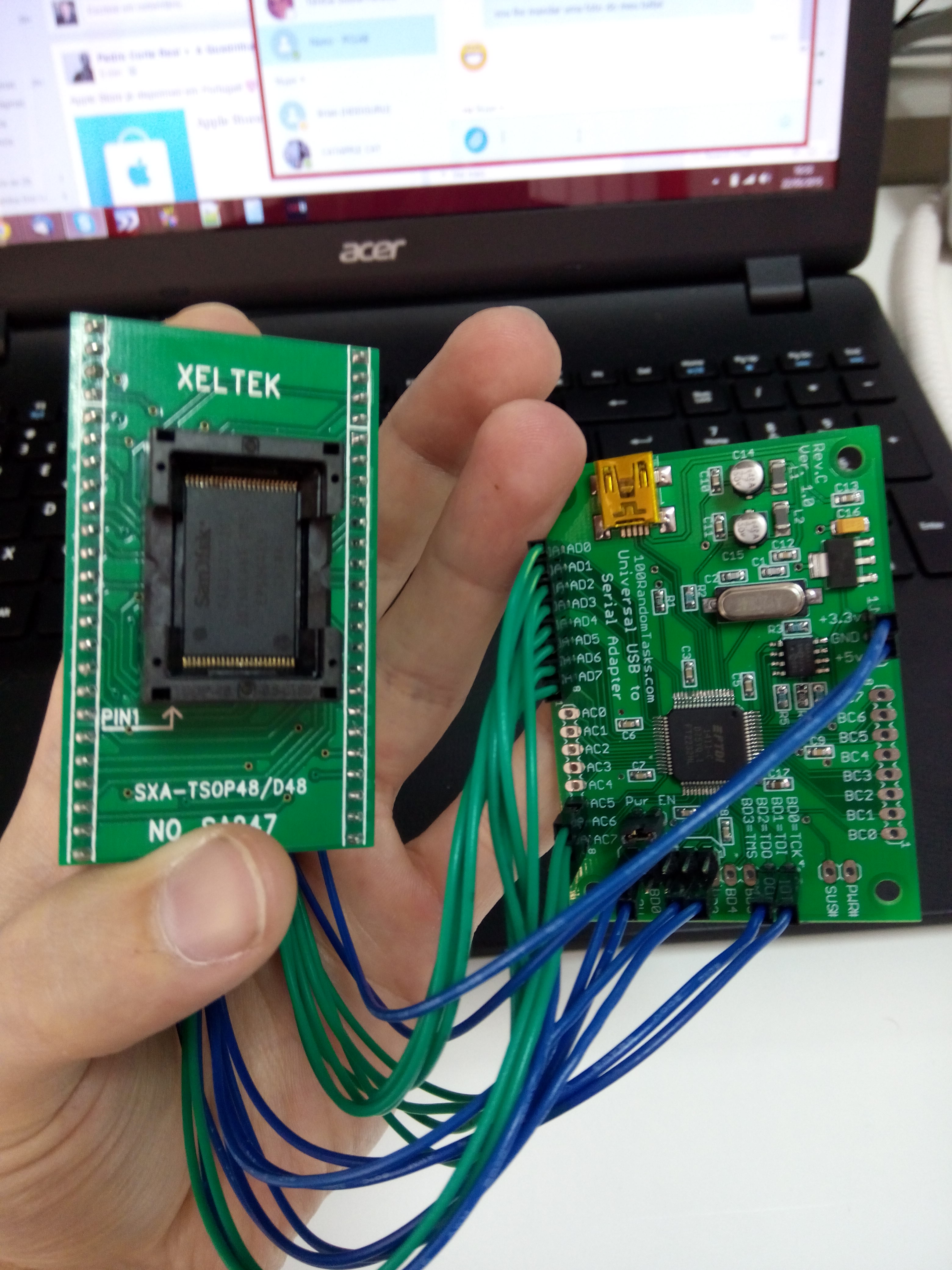

I managed to grab some photos that I took earlier:

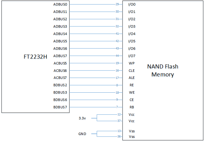

The schematics talk about a 2x 3.3v and 2x Ground, I'm using the ones on the FTDI board, am I correct?

ok, check the grounds and the vcc. I think these are actually connected internally, so you only need 1 supply of each. example, on the bare chip, check with continuity meter both vcc, and if beeps you only need a vcc on one of them
I cant see the back of ftdi board, but looks like connections are fine in any case.

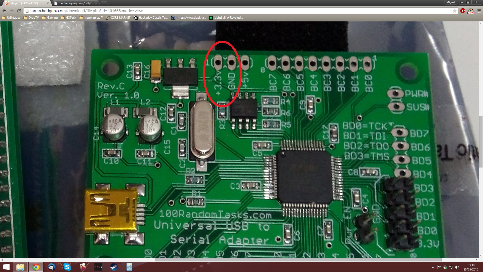

So you would say I only need this 2 pins ?
Having them on 12-13 or 36-37 makes any diference ?

Posts: 413
Nevermind, only 2 pins needed, already found a image showing that. It's a little bit weird since in the article they state 2x 3.3v and 2x GND.
I would obtain a datasheet before proceeding. You can't simply assume that your chip follows the same pinout and voltage spec as the Samsung chip in the Blackhat article.
I would also connect all the supply and ground pins. I wouldn't rely on the chip's internal connections to make up for your wiring shortcuts. Some chips have separate Vcc and Vccq pins, and separate Vss and Vssq. The "Q" rail is for the IO section. Even when these voltages are the same, the two sections of the NAND might still require separate supply rails (although this doesn't appear to apply in your case).

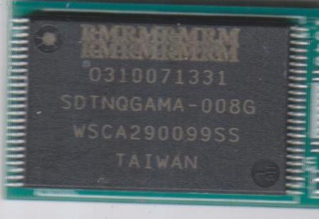

Other comments:
1. ONFI support.. Just because a company like SanDisk is heavily involved with ONFI, doesn't mean all their chips are 100% support. SanDisk do some weird-ass things sometimes.
2. Refurbished chips: Micron and Spectek. It has been reported that Spectek chips are "The ones that john west rejects" "john west" in this case is Micron. The chips from Spectek are often rebadged/ refurbished Micron chips. Some even have the Spectek clearly lasered over the micron Logo. The chips may be a Micron 2 bank 16GB chip with a faulty bank, and rebadged as a single bank Spectek 8GB.
SanDisk sell a lot of chips with faults as well, and you can tell these as there is 2 rows of RMRMRM over the Brand.
They have been remanufactured to either map out the bad blocks or lower capacity. They should have same ID but might have 1/2 the banks.
Toshiba seems to sell to Phison, and they are usually labelled with short numbers starting with TF or TT, where the actual Toshiba part would start with TC58NV. Again the bank numbers can be different
It is important to be aware of refurb chips because if you are looking at a datasheet, all bets are off if it is refurb.
Pirate chips: these chips usually "look" dodgy.. they can be thinner, have broken bits of the package around where the dies meet, have printed labels instead of laser markings that denote faked chips. These normally have a correct ID but the quality is atrocious and many bit errors or straight out failure is probable.
The NAND industry is quite interesting. Almost NOTHING goes to waste. If a chip is not dead, it will be labelled and configured at whatever capacity they can get from it. Sometimes even 512MB cards are still made from 32GB chips that are all but stuffed. if you open as many devices as I do, you see some strange and wonderful things such as MicroSD cards in holder or soldered to PCB inside of Flash Disks and SD Cards, eMMC chips soldered to use just the NAND, totally fake things like 1GB NAND chips inside "64GB" drives.
I guess the whole point to this post is that NAND is a little different to most chips.. uC's, logic chips etc where specifications are everything. sometimes you can reliably rely on documentation such as 29F chips from intel/Micron, and other times it is a crapshoot. But it is ALWAYS fun ;)

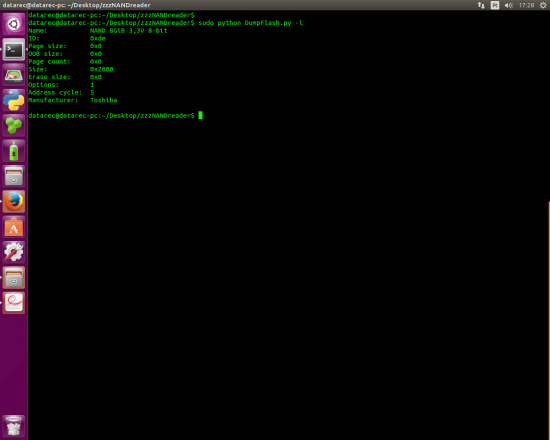

 Post subject: Re: Dumping nand flash memory
PostPosted: May 25th, 2015, 12:43
Posts: 413

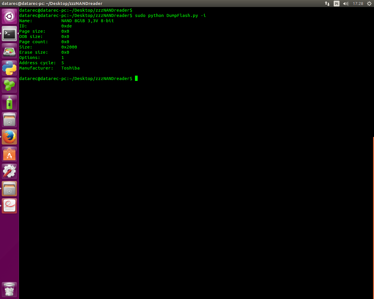

OK, this is weird.
The SanDisk ( SDTNQGAMA-008G ) i'm trying to read is known as Toshiba :|
I can't also find that specific datasheet :(
