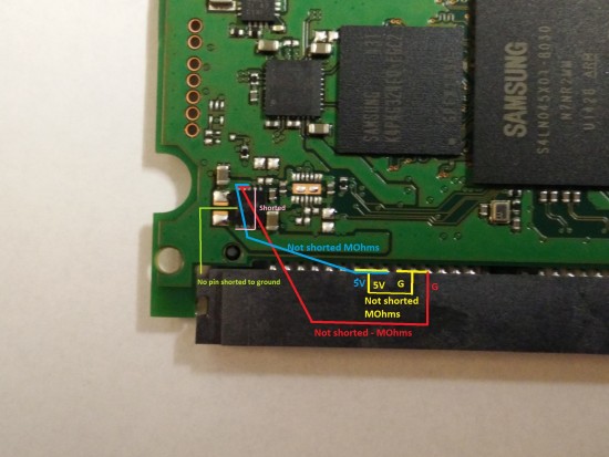

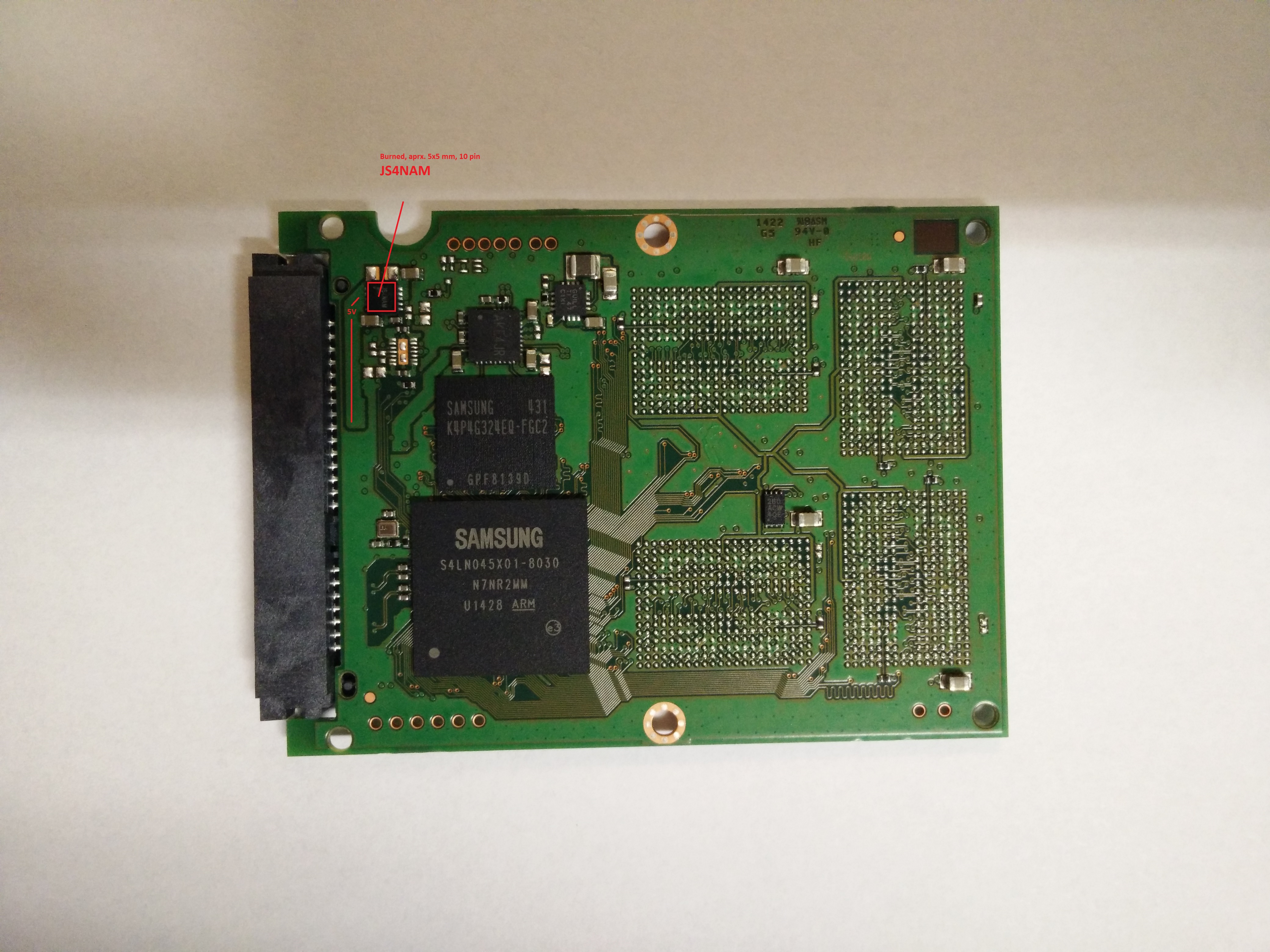

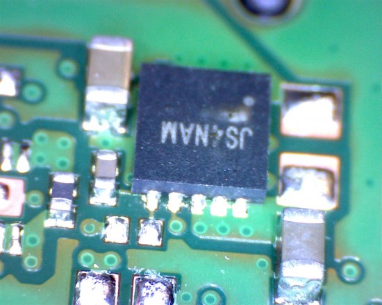

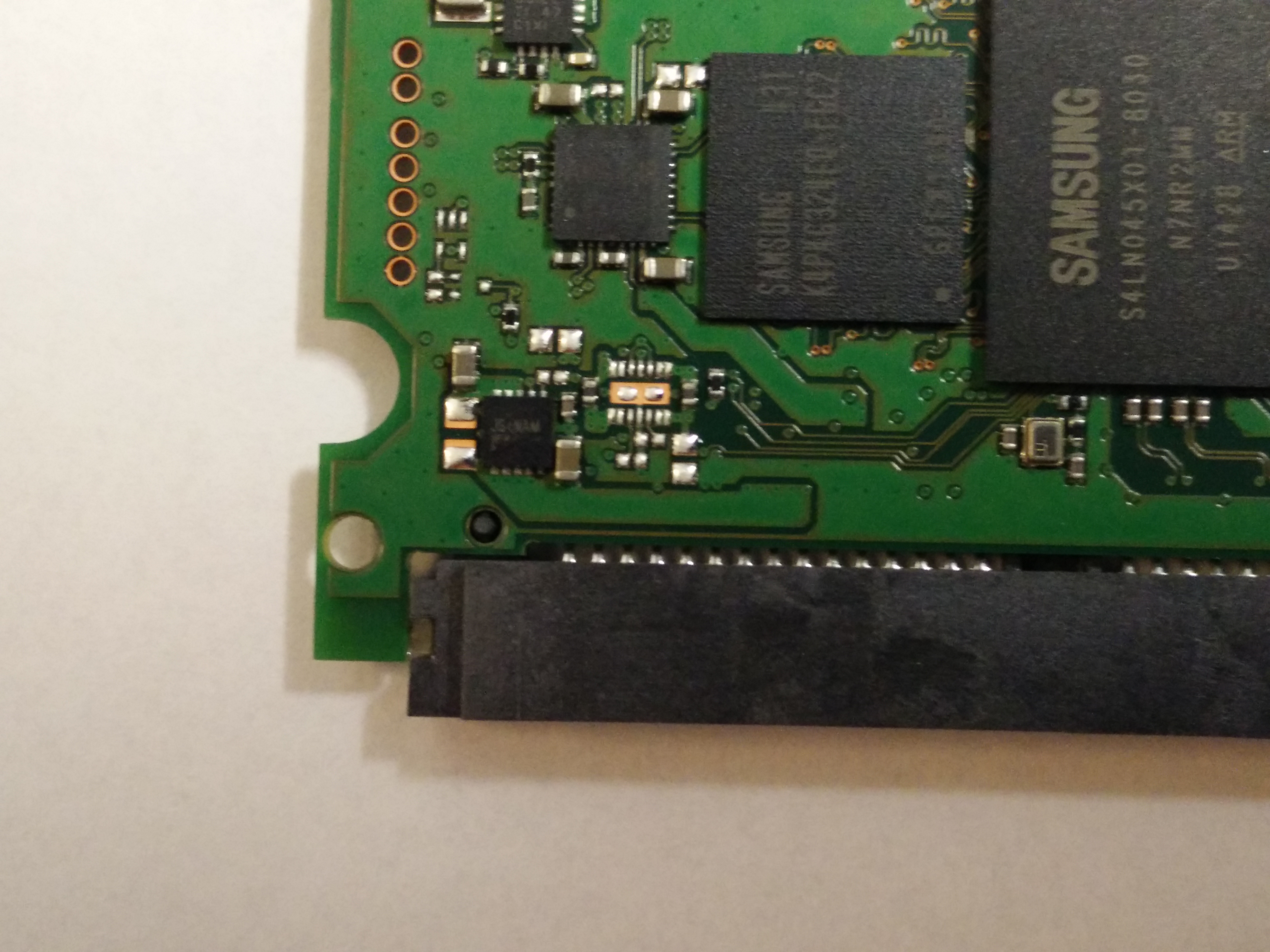

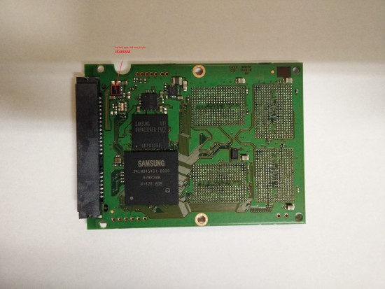

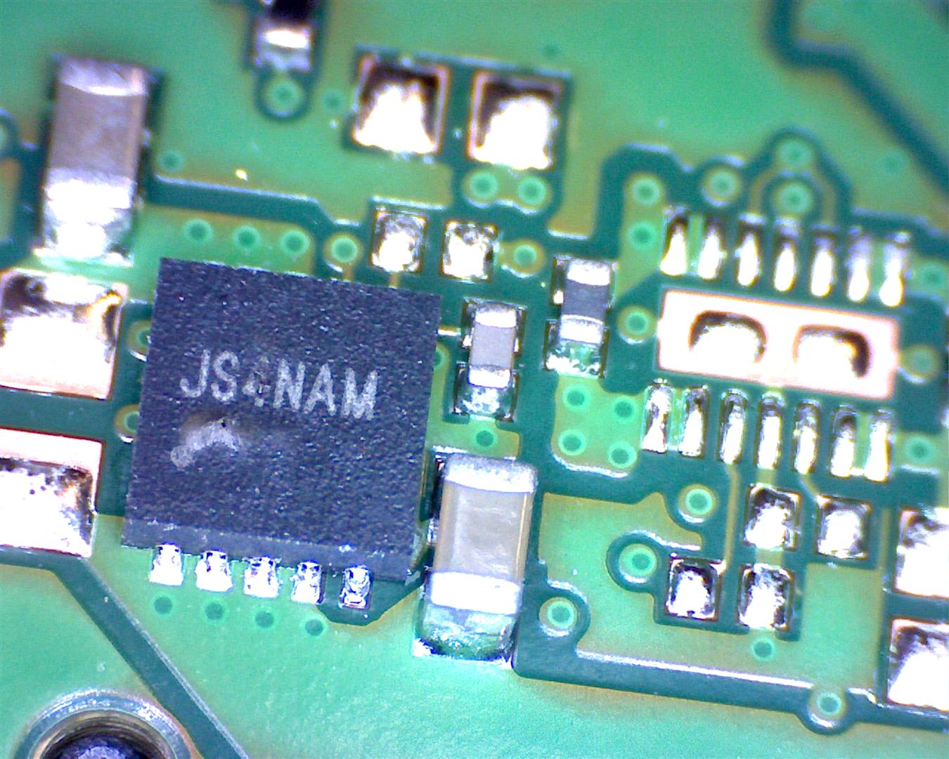

Hello to all, my 1st post.
Can you please help me with burned Samsung 840 EVO 512GB.
It has burned some 10 pin chip, first in 5V way. Marked JS4NAM, but can find nothing about it.
Its square, about 5mmx5mm, height about 1mm ... 5 pins on both side.
See photo.
Maybe some diode block?
Thx for info.
Daniel

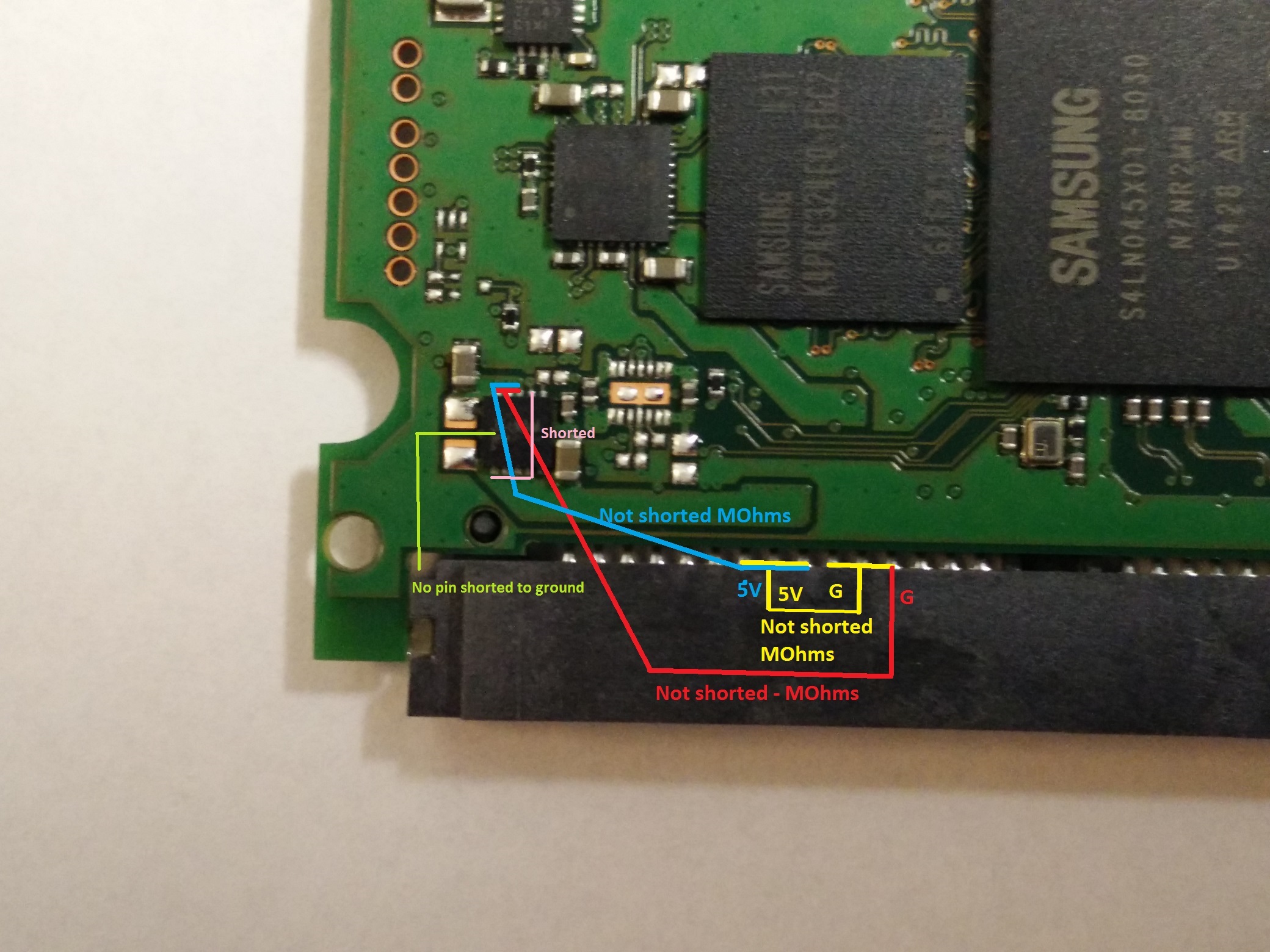

I suspect that the component could be bypassed with a wire link, but we need to take some measurements first.
What is the resistance between the 5V pins and ground?
What is the resistance between ground and the group of 3 pins on the other side of the IC?
What is the resistance between the group of 3 pins and the 5V pins?
Which of the IC's other pins are grounded?

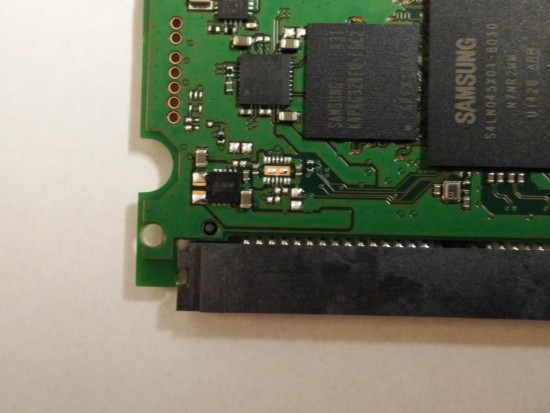

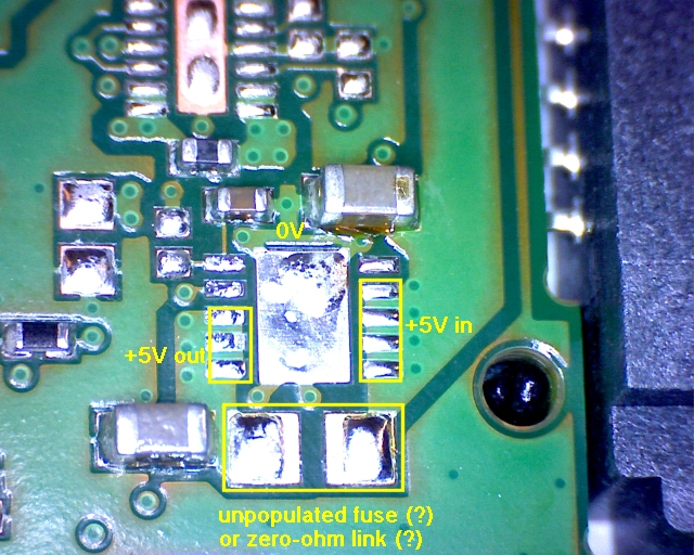

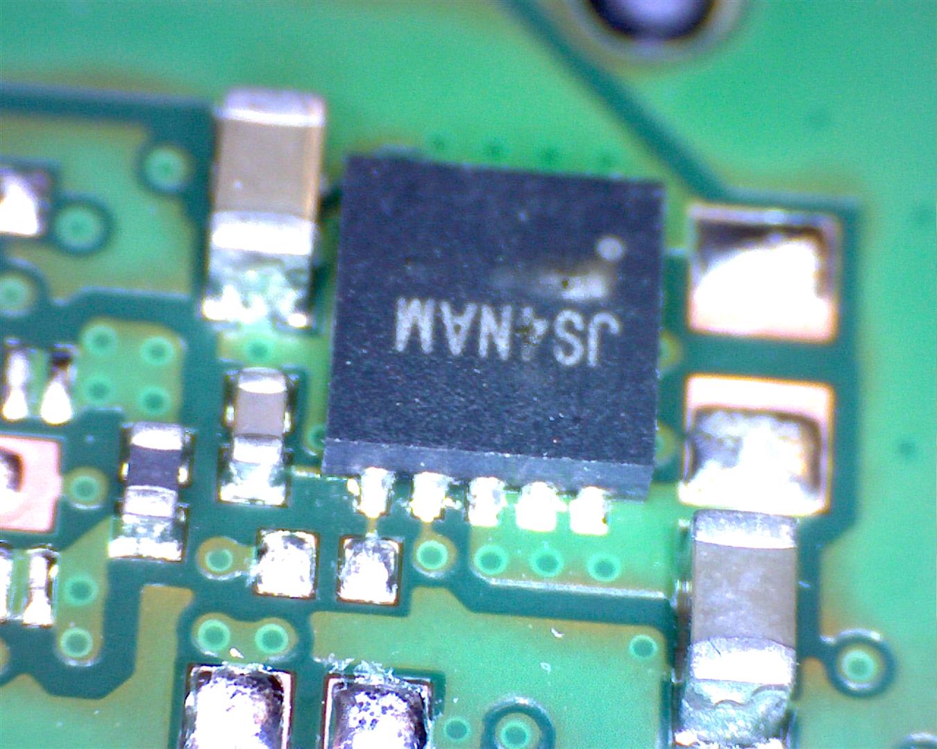

Thx for your help. I measure it - see photo diagram.
I add another 2 photos with IC, from USB microscope.
Have a nice day and thank you.
Daniel

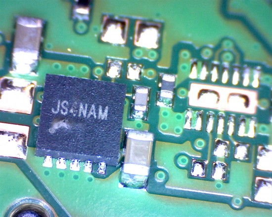

SSD from ebay are very expensive, even in "for parts" state.
If I cant find replacement part, I will try wire bridging.

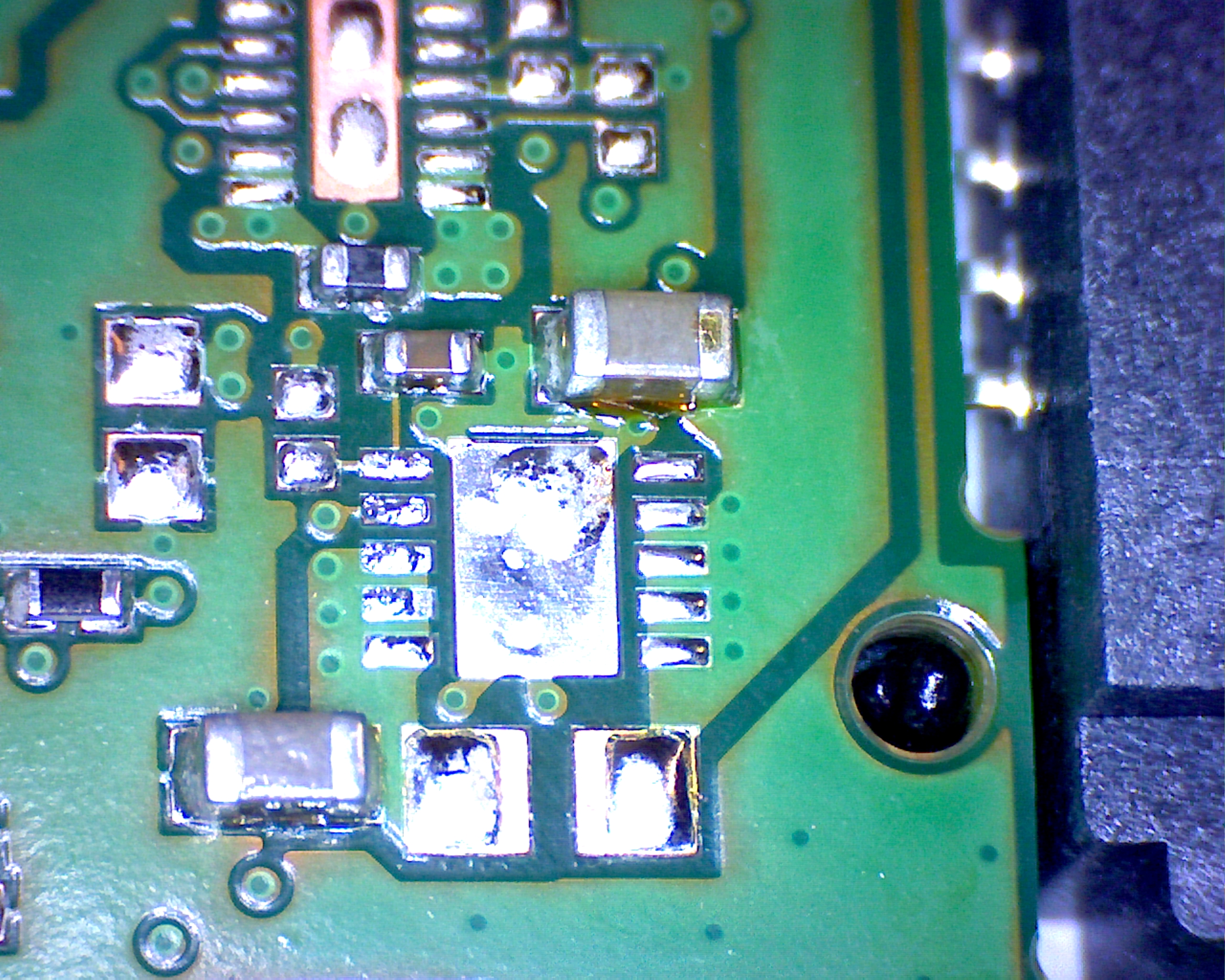

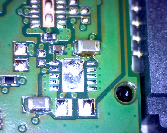

Pls see photos with unsoldered IC.
Can anyone advice which pins to wire? Ideal colour lines in Windows paint.

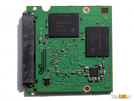

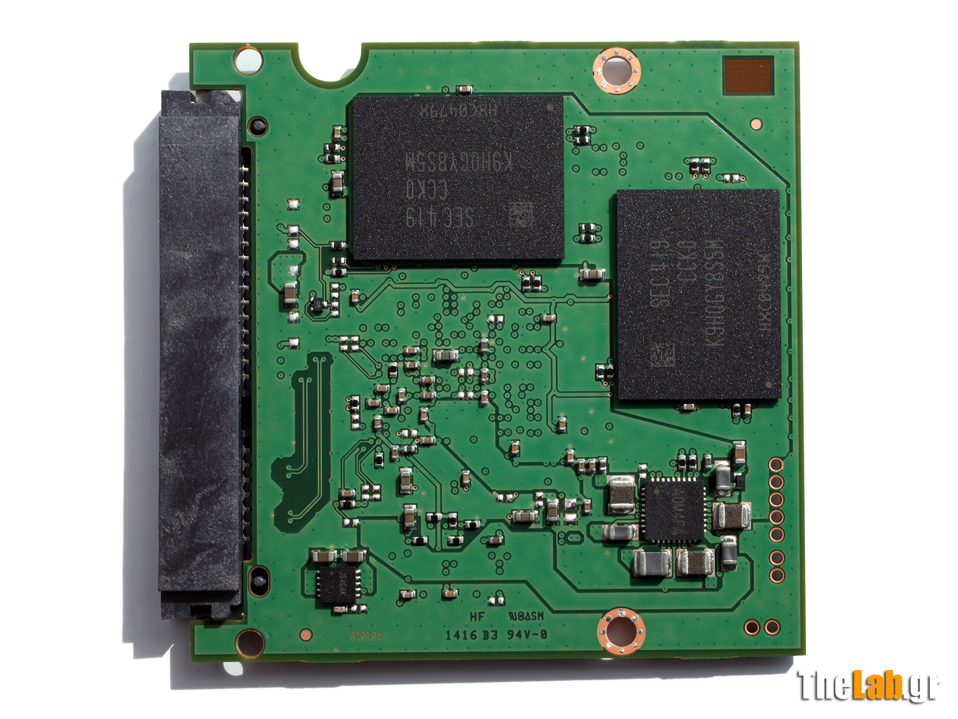

Next fot is from 850Pro ( from web ) - same part but only first 3 leters JS4 are same
Anyone any clue where to buy it? Or some replacement ?
Thx.
Daniel
PS: HaQue, happy ice cream run :) Thx for any info and advice.

Well,
Why did You Remove The Capacitor .Also The Bottom Of This Definately Has Voltage IMHO As There Are Capacitors Bridged To Ground From There .

"JS4" is probably the part number. The remaining characters are probably the date or batch code. FWIW I have seen "JS3F A" on other similar Samsung PCBs.

The chip on my EVO 128GB is FN4MAJ

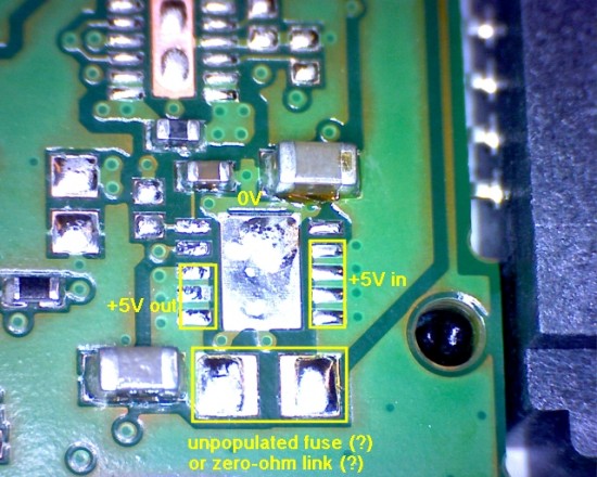

I'm guessing that the circuit could be bridged as follows:
A 1A polyswitch (resettable fuse) might be a good choice. These can be scavenged from around the USB ports of old motherboards. It would be a good idea to take some additional measurements around the two regulators (AKE4JR and GUILL). We would need to see the underside of the PCB, though.

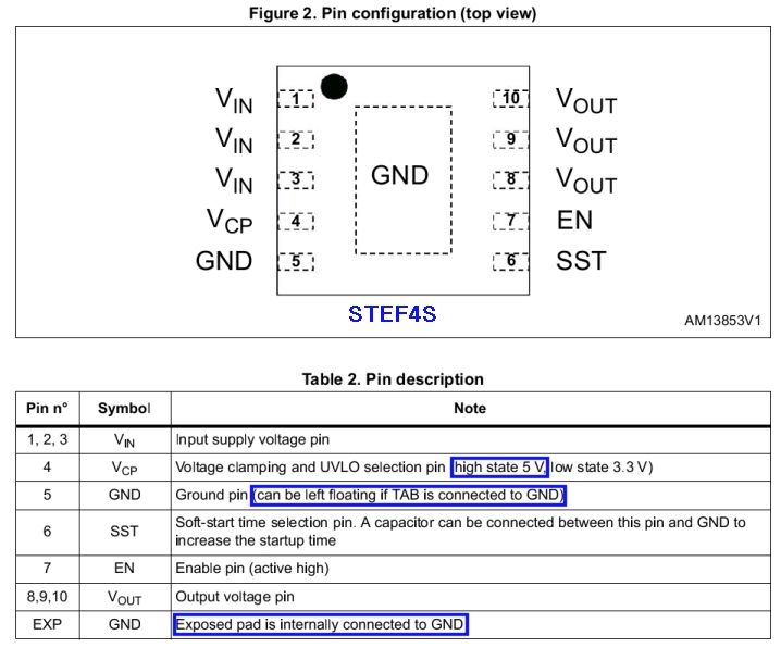

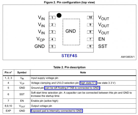

The mystery part looks very much like this electronic fuse, except for pin 5:
STEF4S, STMicroelectronics, Electronic fuse for 3.3 V and 5 V lines, Output clamp voltage 5.7V in 5V mode, Protection trip current 5A:
http://www.st.com/web/en/resource/techn ... 095426.pdf
The EN-able pin (7) is probably tied to VIN (5V) by the external circuit.
The trip current rating of 5A seems much too high for an SSD that would probably draw less than 0.5A.
