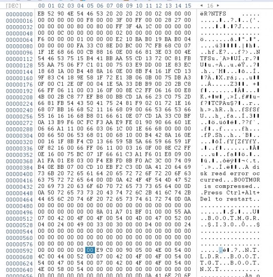

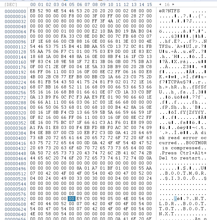

I have a Master Boot Record question. I have been trying to get a reference chart of the NTFS Master File Table and the Master Boot Record completed in Visio and I ran into an issue. I have posted a screen capture of a Master Boot Record and if you will notice, there is no partition table in it. Whenever I open a forensic image file made with Windows 7 or 8 I get something like this. Can anyone tell me why my Master Boot Record doesn't have the partition table in it?

You are looking at a Volume Boot Record aka "boot sector", not a "Master Boot Record". You appear to be confusing logical sector 0 with physical sector 0.
See http://thestarman.pcministry.com/asm/mbr/index.html

fzabkar, I go to physical offset 0 in WinHex (or a number of other forensic tools) and this is what I get. From my understanding, the Master Boot Record is supposed to be at physical offset 0 of the image. Am I, for whatever reason, looking in the wrong place? If this is the case, can you suggest how I can more easily get to the Master Boot record using a hex editor? Thanks.

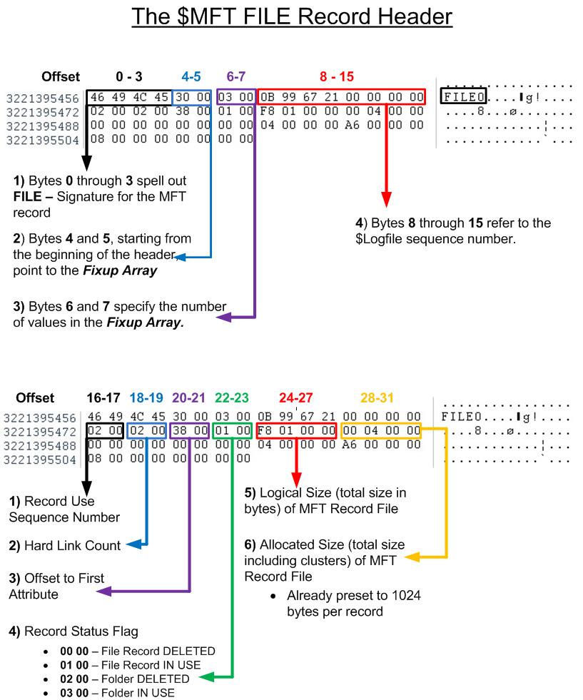

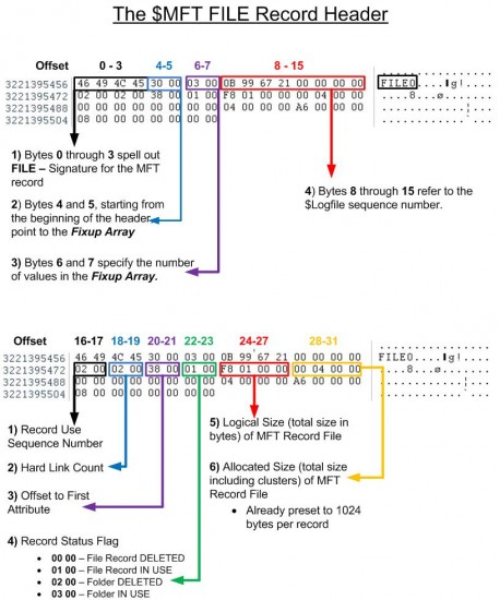

HaQue, this is a section of what I am working on. This project will expand as I go, but for right now, I wanted to get some of the primary aspects of NTFS. A few of the values in the FILE Record Header are difficult to define. There are only two textbooks that thoroughly cover this material. One of those is Brian Carrier's "File System Forensics" text and then one from 2007 called "Forensic Computing," by Sammes and Jenkinson. I have found a few discrepancies between these two texts when it came to the FILE record header. Also, some of the available resources on the web seem to either ignore a few of the values altogether or they lump some of them together. I found this to be especially true of the "fixup array" related values. There is no one "go-to" source for this information. You have to do a lot of cross referencing.

You have given your screenshoot the name "VBR2", so that would suggest that you understand the difference between a VBR and an MBR. :?
The following resources explain the structure of a Windows 8 boot record:
http://thestarman.pcministry.com/asm/mbr/W8VBR.htm
http://thestarman.pcministry.com/asm/mbr/NTFSBR.htm
The logical volume begins at physical sector 0x272800 and has a capacity of 0x1C4A3FFF sectors. That's 243GB (= 226GiB).
As for WinHex, I don't use it, so others would be better placed to advise you.

fzabkar, I do know the general difference between a Master Boot Record and a Volume Boot Record. My problem is locating the correct record type in a forensic image file using a hex editor. I just get the feeling that somehow I am looking in the wrong place. I know that the Master Boot Record starts at physical offset 0, has a size of 512 bytes, has a BIOS parameter block, and at the bottom there is a partition table. When I go to physical offset 0 in a number of hex editors, I am getting the snapshot of what you saw in the beginning of this thread. Obviously, I am missing a step somewhere so I am not getting to the MBR.

labtech, I just re-read your initial post and it occurred to me that when I used WinHex to take a snapshot of the C:\ drive, the viewer was only giving me access to the Volume Boot Record. Can you give me an idea as to how I can get to my hard disk's master boot record using a hex editor?

For any boot drive MBR is located at sector 0.
More than likely, the first sector you are looking at in your image is sector 63 on the person's physical drive.
 Post subject: Re: Windows 8 Master Boot Record question
PostPosted: July 30th, 2015, 15:31
Well, the topic is called Windows 8, so then I need to make a correction. It will likely be a GPT based partitioning scheme, so it will not be sector 63.

The BPB indicates that the physical sector is 0x272800, not 63 or 2048.

The start sector for MBR based drives was 63 for Windows XP and 2048 for later Windows versions.
