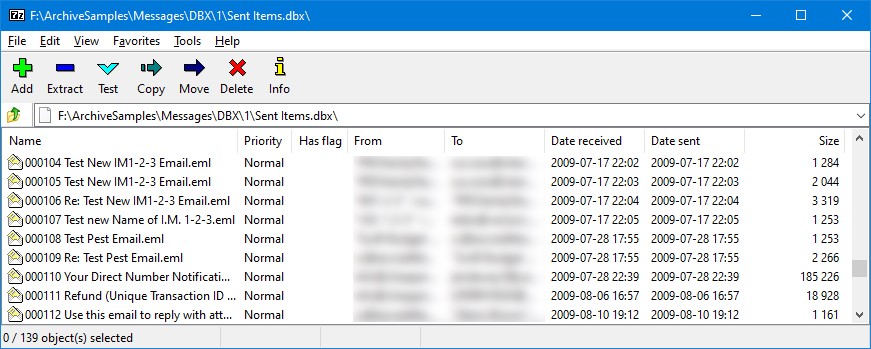

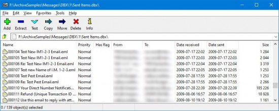

You can convert email from .dbx database into .eml files with 7-Zip + eDecoder plugin. When you open dbx file in 7-Zip you will see something like this:
