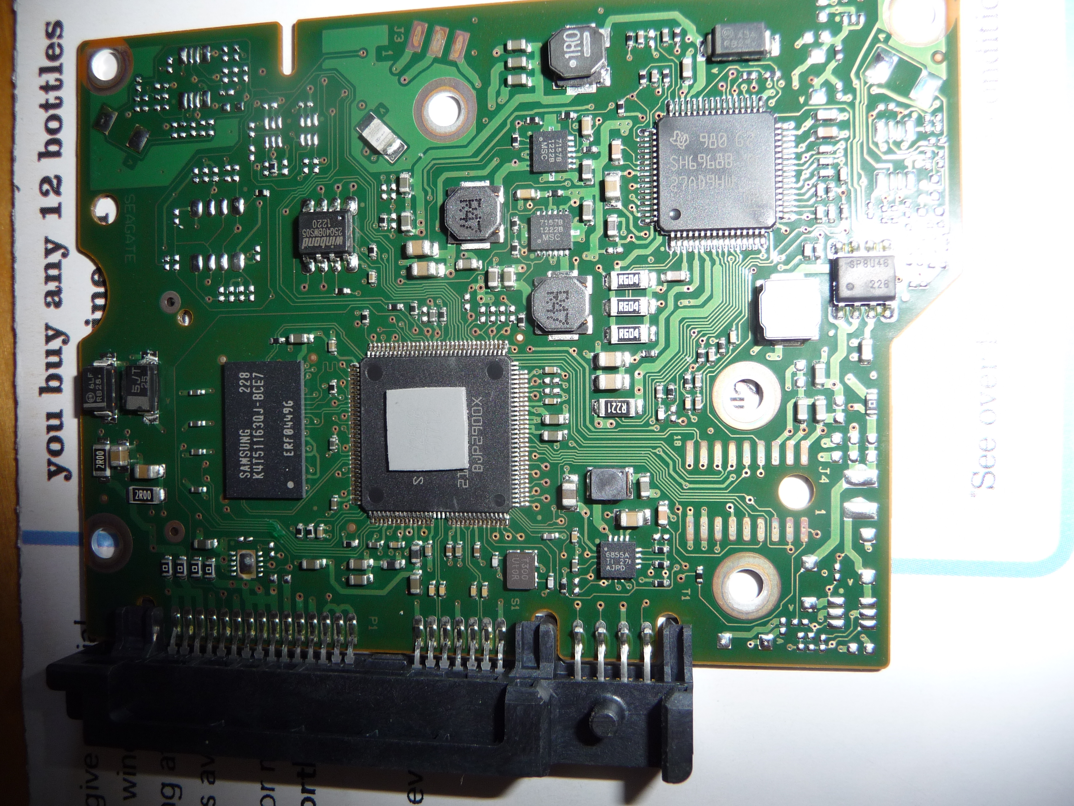

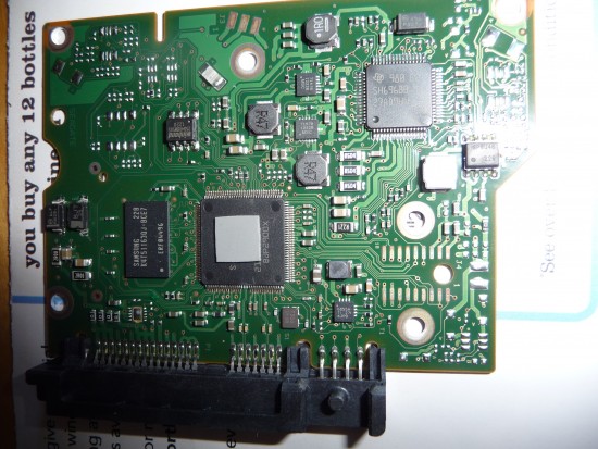

First, my PCB looks a little different (but similar) to your pic.
At the 2k resistance setting on my multimeter I get a reading of 0.715 in one direction and 1 in the other over the 12V TVS. But I get 0.030 in BOTH direction over the 5V TVS.
Both the 12V zero ohm resitors and both the 5V zero ohm resistors seem to be fine, all registering zero ohms.
Does that suggest that the 5V TVS is no good?
Andy.

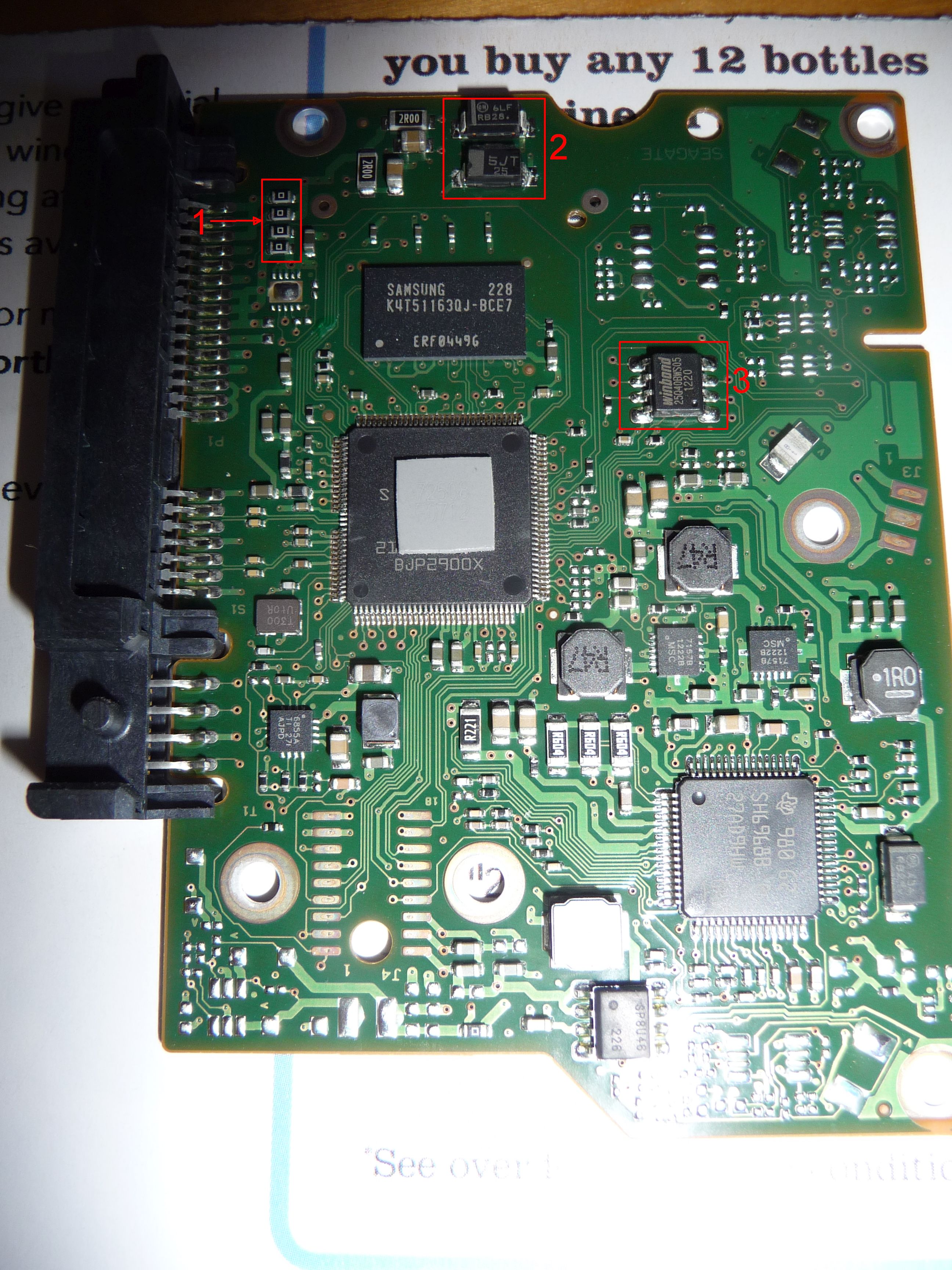

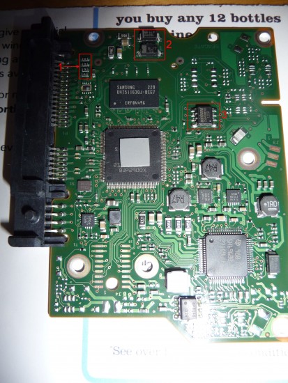

OK here's a picture of what to check:
#1: Check these which a multimeter. They should read 0 ohms (dead short). If they don't you can replace, or bypass with a piece of small wire.
#2: Your TVS Diodes. These will read very little resistance one direction but very high resistance the other direction when you switch your leads. If they are dead short both ways, simply remove.
#3: If you give up on fixing the PCB, simply move this chip over to a good PCB of the same PCB number (something like 100664987 REV A) which is printed into the board. It contains the adaptive ROM code and will make the new PCB compatible with the old one.
I'm giving this advice on the assumption that the drives don't spin at all. You said they "aren't making any noise", so that's what I'm assuming you mean. However I've had people describe that to me when they really just mean it's not making any bad noises. If it is spinning, then it's unlikely a PCB issue at all.

30 ohms is very low, so something is loading the 5V rail. Remove the 5V TVS diode and retest it out of circuit. Also test the resistance between the pads on the PCB after you have removed the diode.
Could we also see a photo of the NAS PCB? There should be a 5V regulator on this board. A damaged 5V TVS diode on your HDD would suggest that it was overvolted by the NAS PCB's 5V regulator circuit.
Do both HDD PCBs have the same problem?

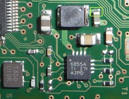

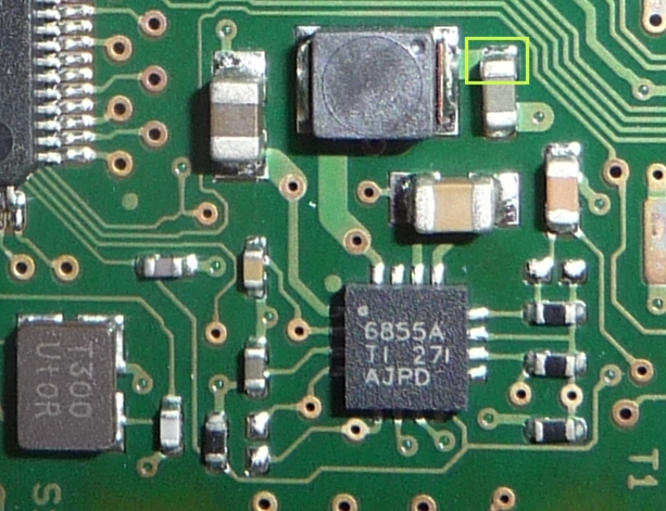

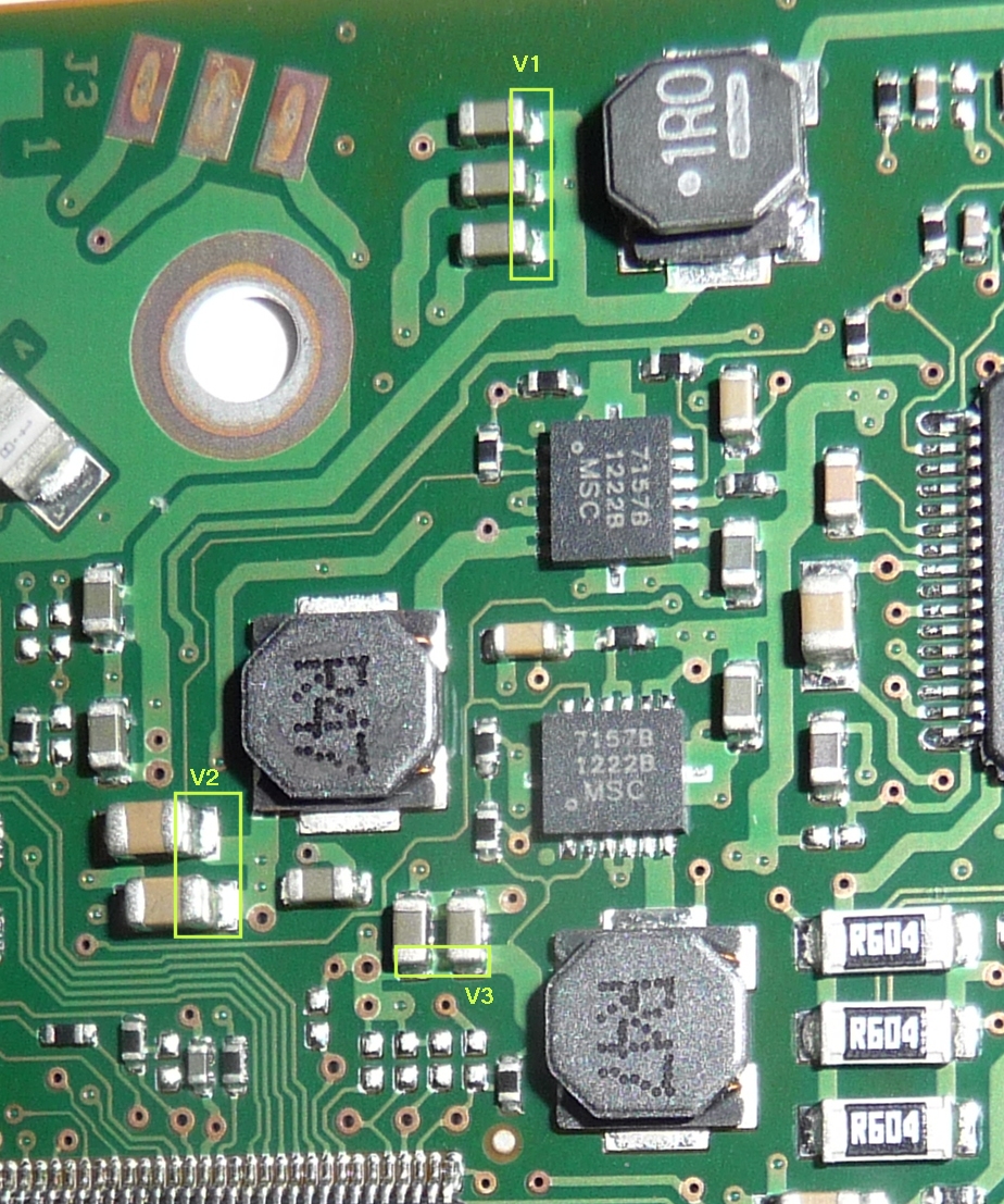

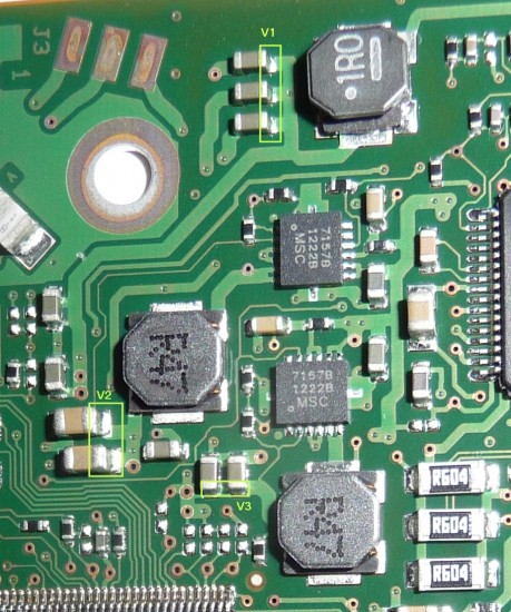

The 5V TVS diode is OK. The problem is most likely due to one or more of the LX7157B regulators near the motor controller. :-(
Measure the resistance between each of the V1, V2, and V3 test points and ground (eg a screw hole).

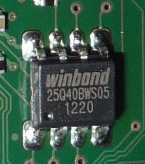

In the worst case you could replace the PCB and transfer the serial flash memory chip (W25Q40BWS05) for US$50:
http://store.yahoo.com/yhst-14437584971 ... 22209.html
If you choose to DIY, then be aware that you must not damage the chip, otherwise data recovery will become extremely expensive.
LX7157B, Microsemi (MSC), step-down PWM regulator IC with integrated high side P-Ch MOSFET and low side N-CH MOSFET, 2.2MHz, 3V to 5.5V:
http://www.microsemi.com/document-porta ... -lx7157bds
W25Q40BWS05, Winbond, 4Mbit serialflash memory, 1.8V, Dual/Quad SPI:
https://www.winbond.com/resource-files/ ... 101113.pdf
Edit: I would also measure the resistance between the 6855A coil and ground.

The various points you mention measure as follows (moving from top to bottom and left to right in your pic):
V1.1 = 64 Ohms
V1.2 = 64 Ohms
V1.3 = 64 Ohms
V2.1 = 0 Ohms
V2.2 = 0 Ohms
V3.1 = 323 Ohms
V3.2 = 323 Ohms
Resistance between the 6855A coil and ground = 30 Ohms

There is a short circuit at the V2 test point. Hopefully it is caused by the uppermost LX7157B regulator chip.
download/file.php?id=8581&mode=view
This fellow (a technician) managed to repair his PCB for 2 Euros:
viewtopic.php?f=1&t=29204&start=20
It wasn't a neat job, but he recovered his data.
If you are keen on doing your own soldering, then IMO it would be safer for you to replace the uppermost LX7157B chip rather than attempting a ROM transfer. You could practice on some dead PCBs, eg old computer motherboards. In my younger days I have used a regular temperature controlled iron for QFP chips, but I think it would be preferable for you to purchase a hot air rework station. A technician at badcaps.net recently recommended a "Gaoyue 858 found on eBay for US$36.00". He says "you will need flux and heat protection tape. Electronic aluminum or heat tape".
There is a chance that there is damage on the load side of the R47 coil, in which case one or more of the other chips may be faulty. You can determine whether this is the case by desoldering pins 5 and 6 of the LX7157B and retesting the resistance at V2. If the short goes away, then you can be certain that the LX7157B is the culprit.
