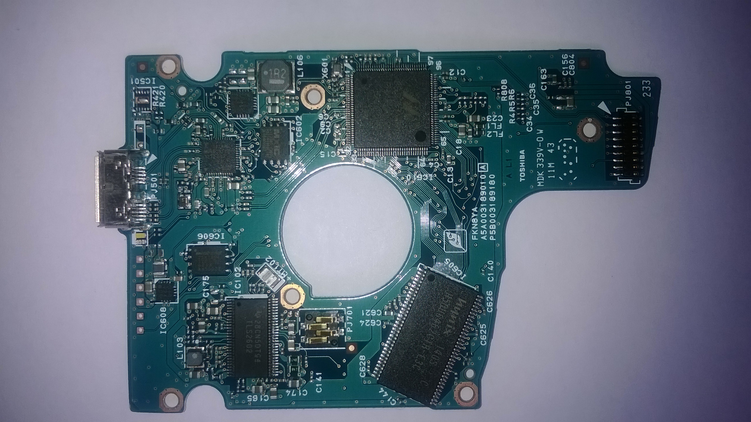

i need to convert PCB "G003189A" of this Toshiba MQ01UBD100.
Do you know how?
Someone can show me a shematic where to solder sata connector on this usb pcb ?

here the pic:

IC602 seem to not be the rom on my pcb.
ROM on this pcb should be IC606 (Winbond 25X20BL)

IC606 it's a flash rom, but you are also right, IC602 it's another flash ROM
http://www.alldatasheet.net/view.jsp?Searchword=25X20BL
http://www.macronix.com/Lists/DataSheet ... 20v1.5.pdf
IC602 code is:
Macronix MX25V4006EZNI
IC606 code is:
Winbond 25X20BL
So do you think that it's enough to swap IC602 or do i need to swap also IC606 ?

@michael chiklis, if you compare your PCB against the SATA version, then the "ROM" (IC602) and SATA Tx/Rx locations become obvious.
http://ep.yimg.com/ay/yhst-144375849714 ... 5271-7.gif
IC606 is associated with the bridge IC.
In the absence of a comparison PCB, you can determine the functions of the ROM chips by using a multimeter to trace their data pins back to the MCU and bridge ICs.
As for the SATA Tx/Rx pairs, the general rule is to locate two thin, parallel, capacitively coupled pairs of traces running between the MCU and the bridge, remove the capacitors, and then tap into the signal pairs on the MCU side. The signal order should match the order at the SATA data connector, either directly or in reverse.

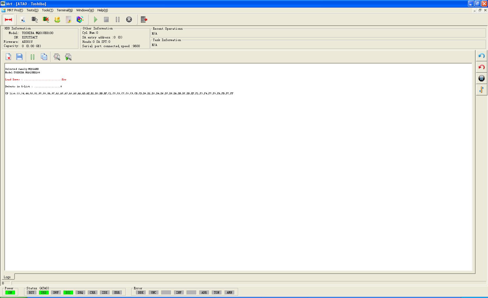

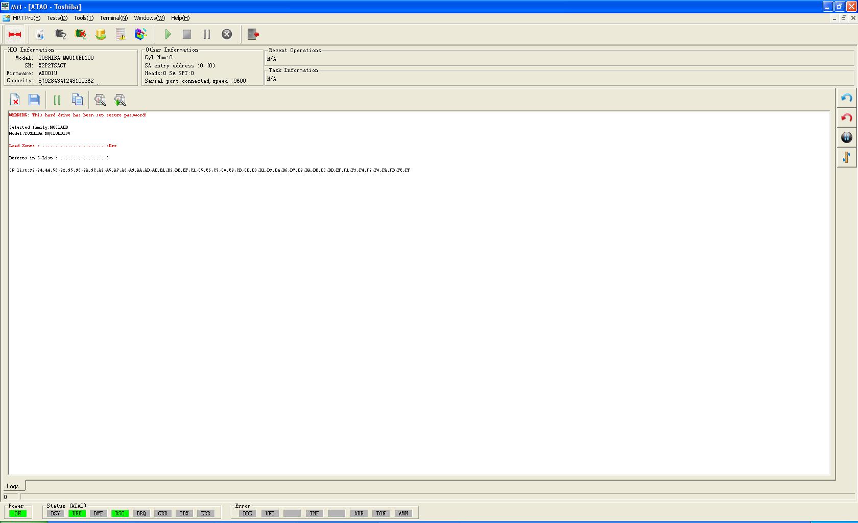

I converted native usb pcb to sata as you suggested me, now hdd is detect in MRT.
What is strange is that sometimes it does not show the correct capacity and seems to be locked by password, if i close and reopen MRT sometimes is detected with 0 bytes in size and not locked with password.
I closed and opened MRT few times without changing any paramenter until it shown me this:
it changes continuously at random, very unstable...
Maybe PCB is faulty, should i try changing directly pcb with a sata donor pcb?
