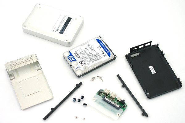

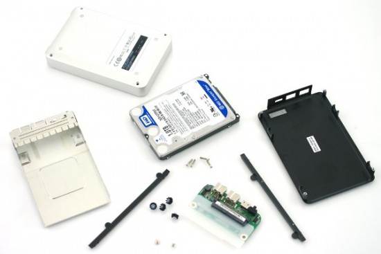

I have a Western Digital My Passport Studio firewire/usb external drive which stopped being recognized on my mac. I've had it for about 4 years and it's always worked great. It sits on my desk next to my mac and has never been dropped or suffered any power surges. A couple days ago it stopped being recognized. I removed the drive from the enclosure. It's a Western Digital Blue WD10JVPT-22A1YT0 1TB drive.

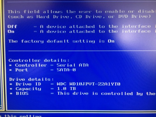

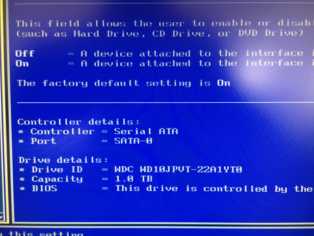

and powered directly through SATA cable/power, it IS seen in the BIOS (screenshot attached) never seen in disk management.
when disconnecting all drives except this one and booting MDHDD, the drive is recognized in BIOS, but MDHDD won't boot saying "Drive is not ready."
Thoughts? Next step(s)?

Hi ncalsurfer! HDD probably has bad sectors or slow responding problem. Does Crystal disk info (https://crystaldiskinfo.uptodown.com/windows) see the HDD?

Try to read the drive's firmware resources (ROM and SA modules) using the demo versions of WDR or WDMarvel or HDDSuperTool. If it's a slow responding problem, then there may be an easy DIY fix.

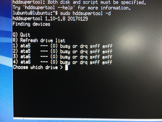

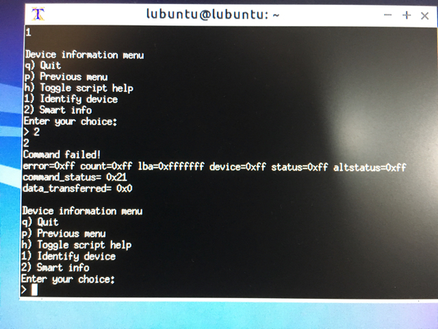

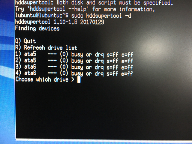

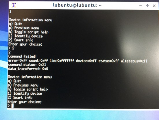

HDDSuperTool - I love command line, and this one can "see" the hard drive, but I get drive busy errors even after letting the drives seek for 15 minutes. (see screenshot).
The drive seems to be endlessly seeking and then every 3-5 minutes will "reset" with a click and start seeking again. Also, when booting into Linux for HDDSuperTool, it seems Linus is scanning the drive in the background and marking bad sectors. The first time I booted up, smart info showed 9 bad sectors. The second time after letting the drive spin for a while, smart info showed 45 bad sectors.
That screenshot indicates that no drives are seen connected in direct mode, as indicated by the s=ff e=ff results (all pins are floating high). Is your BIOS set to IDE mode? It won't work with AHCI mode. Make sure your BIOS is set to IDE. And if your BIOS does not support IDE mode, try running HDDSuperTool without the -d option and see if you can get any results.
Not that it will help much if it has a bad head and no sector access...

Along with requiring IDE set in BIOS, when using direct mode in HDDSuperTool, you will need to apply power to the drive after the computer boots up. That way Linux will leave the drive alone and you can work with it directly. Otherwise you will get an error that the drive is visible to the OS. But direct mode is the best way to work with a drive like this, so that the OS leaves the drive alone. If the drive is suffering from the slow issue, that is the best chance you have at any sort of DIY.
