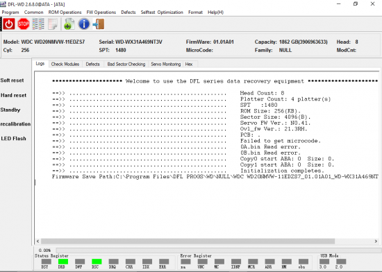

 Post subject: Firmware problem with ShrekLT
PostPosted: March 21st, 2017, 17:05
Joined: June 26th, 2011, 19:38
Posts: 56
I have a ShrekLT drive that is behaving very strangely. I can get the drive into safe mode, load mod 11 and mod 1 and read out all firmware, but cannot get the drive to identify correctly in normal mode. i am attaching a picture of the DFL screen once I have booted to safe mode and loaded the modules.
When I try to access the drive normally, the drive does not identify correctly, but I can get access to the ROM.
Anyone have any thoughts as to what is going on with the drive? Is the ROM possibly corrupted? I tried a fix for a similar problem with this drive series but it did not work: http://forum.dolphindatalab.com/thread-1616.html.
SafeModeMod11.PNG [ 48.52 KiB | Viewed 12126 times ]
 Post subject: Re: Firmware problem with ShrekLT
PostPosted: March 21st, 2017, 17:28
Posts: 17226
FWIW, I can check the ROM for you.
 Post subject: Re: Firmware problem with ShrekLT
PostPosted: March 21st, 2017, 17:43
Joined: June 26th, 2011, 19:38
Posts: 56
Here you go.
ROM.zip [238.32 KiB]
Downloaded 462 times
 Post subject: Re: Firmware problem with ShrekLT
PostPosted: March 21st, 2017, 17:43
Posts: 1898
Location: In your hard drive.
0A.bin Read error - Heads map
0B.bin Read error - Flash Rom
 Post subject: Re: Firmware problem with ShrekLT
PostPosted: March 21st, 2017, 17:49
Posts: 17226
Spildit wrote:
FWIW, I can check the ROM for you.
Those Shrek .... Remember the threads with tools having trouble reading ROM MODULES or correctly ID the active ROM module or whatever ?
Maybe it's something related ?
That's what I was thinking, although the error message isn't clear.
    0A.bin read error
    0B.bin read error
If it is reading the wrong copy of 0A, then it would encounter a bad checksum (for the heap map section). If 0B is in error, then why not look for 20B? Does "read error" mean that the module cannot be read at all, or can it mean that there is some problem with its content?
 Post subject: Re: Firmware problem with ShrekLT
PostPosted: March 21st, 2017, 17:58
Posts: 17226
ROM analysis attached. All seems OK. Module 20B is the active module, not 0B. That's a common bug/limitation in pro tools.
PeskyBit.rar [4.25 KiB]
Downloaded 459 times
 Post subject: Re: Firmware problem with ShrekLT
PostPosted: March 21st, 2017, 18:02
Posts: 17226
Sorry for the double post. BTW, the double line spacing is annoying, but I don't know how to prevent it.
 Post subject: Re: Firmware problem with ShrekLT
PostPosted: March 21st, 2017, 18:03
Posts: 1898
Location: In your hard drive.
0047 FFFF 00000800 01FFFE00 0003F4FE FFFFFE00 BAD
 Post subject: Re: Firmware problem with ShrekLT
PostPosted: March 21st, 2017, 18:25
Posts: 17226
Spildit wrote:
thatdellguy wrote:
0047 FFFF 00000800 01FFFE00 0003F4FE FFFFFE00 BAD
It's inactive (0B). Shouldn't be a problem.
Active in 20B is ok :
0047 OK 00000800 OK 0003E4FE 00000000 OK
Yes, that's how I see it. Some tools, including PC3K, incorrectly report that module 47 is bad. That's because they don't understand how to determine which of the two module directories (0B or 20B) is the active one.
 Post subject: Re: Firmware problem with ShrekLT
PostPosted: March 21st, 2017, 19:22
Posts: 17226
Spildit wrote:
Maybe OP should try to play with SED flag changing/unlocking and see what happens ?
Could we see module 02?
 Post subject: Re: Firmware problem with ShrekLT
PostPosted: March 21st, 2017, 19:35
Joined: June 26th, 2011, 19:38
Posts: 56
Here you go.
02.zip [1.22 KiB]
Downloaded 464 times
 Post subject: Re: Firmware problem with ShrekLT
PostPosted: March 21st, 2017, 19:49
Posts: 17226
The SED flag is set.
000007D0                                      00 00 00 00
000007E0  00 00 01
 Post subject: Re: Firmware problem with ShrekLT
PostPosted: March 21st, 2017, 21:45
Posts: 1898
Location: In your hard drive.
So, DFL doesn't tell you the drive is SED before working on it?
 Post subject: Re: Firmware problem with ShrekLT
PostPosted: March 21st, 2017, 22:48
thatdellguy wrote:
So, DFL doesn't tell you the drive is SED before working on it?
Well,
DFL solves the sed issue in a funny way .They call it firmware locked :D
Users browsing this forum: Google [Bot] and 214 guests
