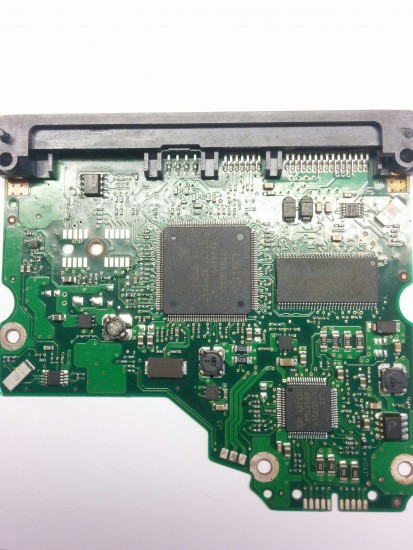

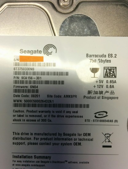

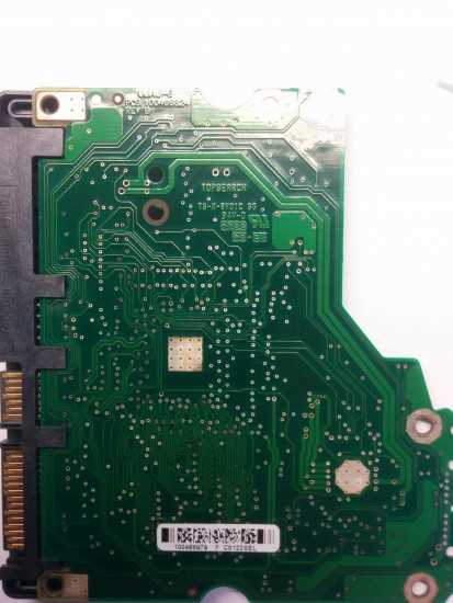

 Post subject: Strange situation on a seagate ST3750330NS
PostPosted: March 26th, 2017, 20:04
Joined: November 21st, 2009, 10:38
Posts: 72
Location: Europe
Just received a defective seagate ST3750330NS.
Connected on my PC3K drive will not spin and still on BSY (but not full green just only light green).
Supposing problem on faulty PCB I swap rom on a donor PCB but result is same
Most strange is reverse: moving donor ROM on patient PCB will have same result.
Rom damaged? .....I can read it with external programmer... so just corrupted?
PCB is: 100866424 REV B
Some suggestions?
 Post subject: Re: Strange situation on a seagate ST3750330NS
PostPosted: March 26th, 2017, 23:05
Posts: 1388
Location: isreal
Can you upload the patients ROM here ?
 Post subject: Re: Strange situation on a seagate ST3750330NS
PostPosted: March 27th, 2017, 5:09
Joined: November 21st, 2009, 10:38
Posts: 72
Location: Europe
This is patient rom
rom.zip [38.92 KiB]
Downloaded 564 times
 Post subject: Re: Strange situation on a seagate ST3750330NS
PostPosted: March 27th, 2017, 8:51
Posts: 17328
That ROM is from a TLITE1HD 7200.9 model, not a ST3750330NS.
 Post subject: Re: Strange situation on a seagate ST3750330NS
PostPosted: March 27th, 2017, 9:58
Joined: November 21st, 2009, 10:38
Posts: 72
Location: Europe
That ROM is from a TLITE1HD 7200.9 model, not a ST3750330NS.
I have wasted a lot of time ......stupid client :evil: :evil: :evil: :evil: :evil:
Sure the client have try to change PCB
Thanks .....mistery is solved
 Post subject: Re: Strange situation on a seagate ST3750330NS
PostPosted: March 28th, 2017, 15:55
Posts: 17328
I don't understand. :?
This is a 7200.9:
http://ep.yimg.com/ay/yhst-14437584971410/instruction-for-seagate-3-5-hard-drive-100404226-pcb-board-replacement-7.gif
... whereas this is an ES.2:
http://ep.yimg.com/ay/yhst-14437584971410/100468979-10.gif
 Post subject: Re: Strange situation on a seagate ST3750330NS
PostPosted: March 28th, 2017, 17:41
Posts: 17328
What is a "100866424 REV B" PCB?
 Post subject: Re: Strange situation on a seagate ST3750330NS
PostPosted: March 28th, 2017, 18:02
Joined: November 21st, 2009, 10:38
Posts: 72
Location: Europe
In dont know ....
Client said other company have try to recover this disk before of me (I guess he have try some DIY solutions like swap other disk PCB).
But 7200.9 disk have different shape of PCB so probably client/other company have rewrite ROM of this PCB .............It is just a guess :?
 Post subject: Re: Strange situation on a seagate ST3750330NS
PostPosted: March 29th, 2017, 3:06
Posts: 3551
Can you provide pictures of both the PCB and the drive?
I've never seen this before.
 Post subject: Re: Strange situation on a seagate ST3750330NS
PostPosted: March 29th, 2017, 11:10
Joined: November 21st, 2009, 10:38
Posts: 72
Location: Europe
northwind wrote:
Can you provide pictures of both the PCB and the drive?
I've never seen this before.
IMG_20170329_113750~2.jpg [ 1.28 MiB | Viewed 10402 times ]
IMG_20170329_113639.jpg [ 1.82 MiB | Viewed 10402 times ]
IMG_20170329_113447.jpg [ 2.13 MiB | Viewed 10402 times ]
Users browsing this forum: Google [Bot], Majestic-12 [Bot] and 77 guests
