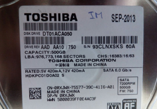

 Post subject: TOSHIBA 3.5" HDD Password unlock.
PostPosted: August 20th, 2017, 1:03
Joined: July 7th, 2012, 1:28
Posts: 92
Location: srilanka
i have this HDD ,password lock.
how to remove password ? i have MRT and Sediv tool's.
toshiba-password-disk.png [ 1.36 MiB | Viewed 6280 times ]
 Post subject: Re: TOSHIBA 3.5" HDD Password unlock.
PostPosted: August 23rd, 2017, 1:12
Posts: 242
Spildit, agree 1+
 Post subject: Re: TOSHIBA 3.5" HDD Password unlock.
PostPosted: August 23rd, 2017, 1:21
Joined: July 7th, 2012, 1:28
Posts: 92
Location: srilanka
Yes, it's HITACHI ARM HDD.
Users browsing this forum: Google [Bot] and 59 guests
