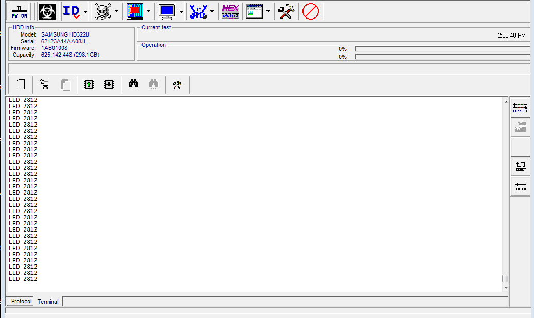

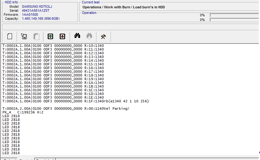

 Post subject: Samsung error LED when burn in
PostPosted: August 23rd, 2017, 14:36
Joined: August 23rd, 2017, 14:27
Posts: 8
Location: jakarta indonesia
hello guys....
i try to burn in samsung F3 model
but im always get LEDxxxx error...
what we have check and test before burn....?
how to get smooth burn till the end...?
please give advice and share kindly...
thanks
LED 1607.PNG
LED 1607.PNG [ 27.46 KiB | Viewed 4458 times ]
led2812.PNG [ 39.57 KiB | Viewed 4458 times ]
LED 2818.PNG
LED 2818.PNG [ 36.33 KiB | Viewed 4458 times ]
ERRRO 1A04.PNG
ERRRO 1A04.PNG [ 46.31 KiB | Viewed 4458 times ]
ERROR 2308 2818.PNG
ERROR 2308 2818.PNG [ 24.51 KiB | Viewed 4458 times ]
 Post subject: Re: Samsung error LED when burn in
PostPosted: August 28th, 2017, 11:23
Joined: August 23rd, 2017, 14:27
Posts: 8
Location: jakarta indonesia
any one help...?
 Post subject: Re: Samsung error LED when burn in
PostPosted: September 18th, 2017, 20:21
Joined: August 23rd, 2017, 14:27
Posts: 8
Location: jakarta indonesia
hello any body can help this problem...?
thanks
Users browsing this forum: Google [Bot] and 58 guests
