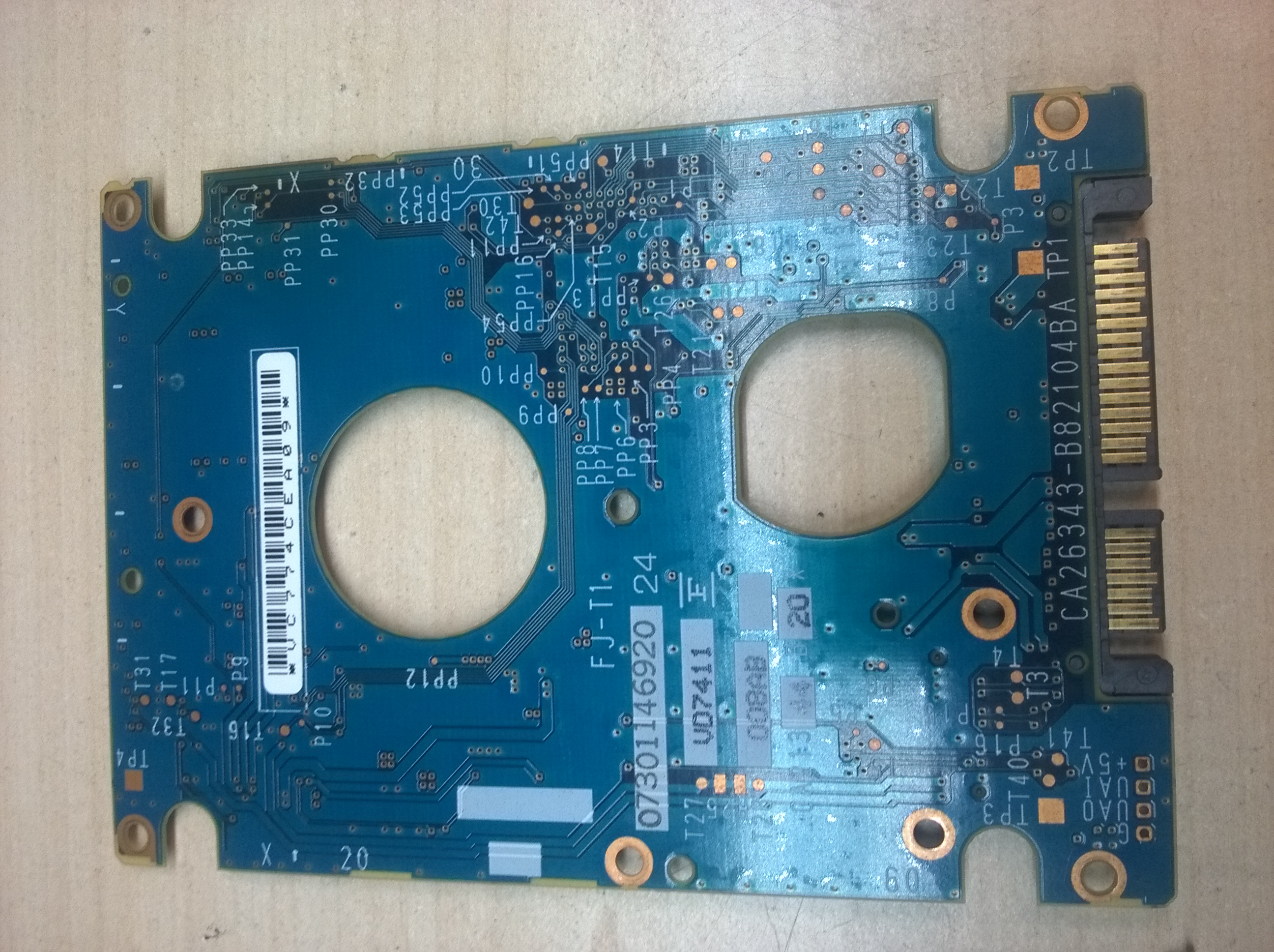

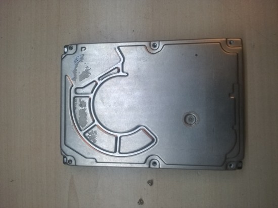

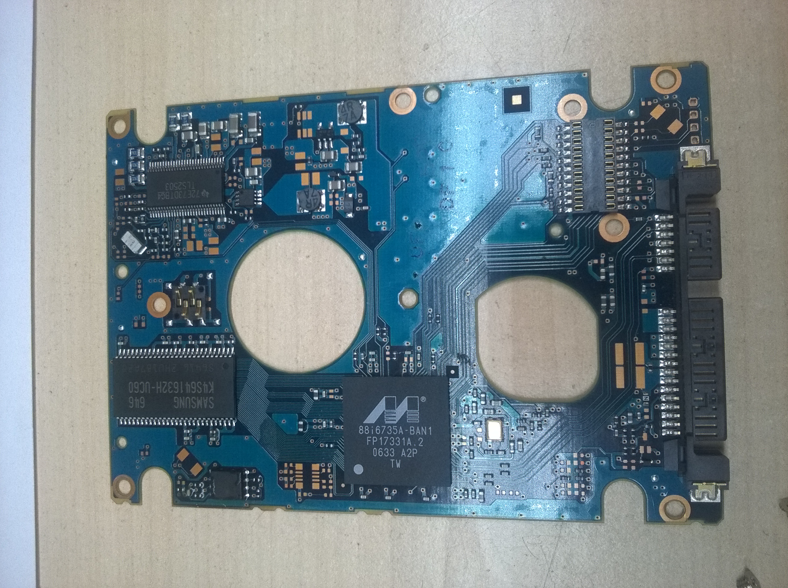

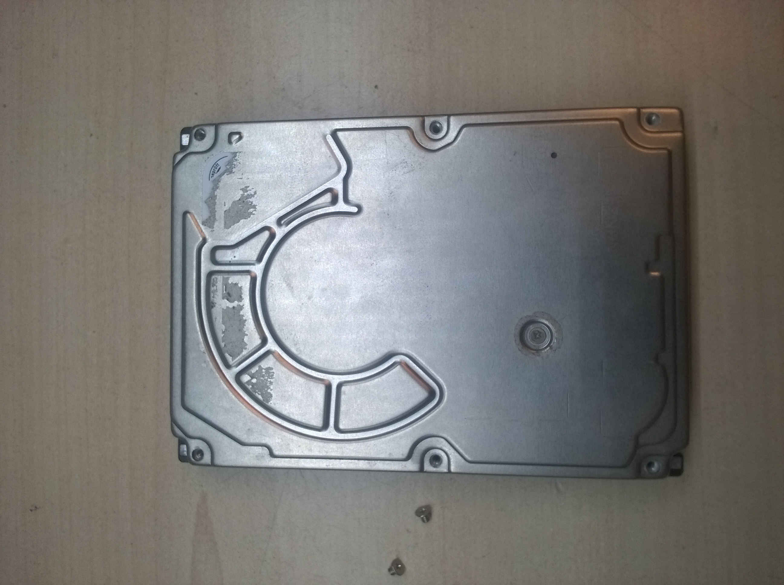

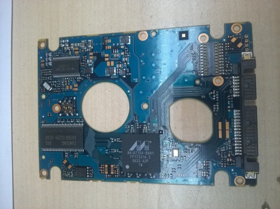

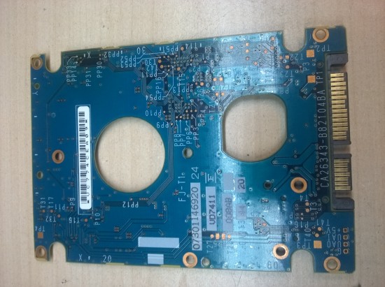

I have a Fujitsu hdd that has come to me in a very bad shape: opened, no front sticker at all and clicking. Of course , some data has to be recovered from him.The big problem is that I don't know what hdd is exactly.
Here are some photos of the hdd:
Now, what I did:
The hdd is clicking softly for some time that it gives RDY but every command returns ABRT.
I have copied the ROM in the programmer , but it looks too empty for me ( maybe I'm wrong).
Fijutsu.rar [8.85 KiB]
Downloaded 424 times
The data inside the ROM is in BigEndian (if I'm not mistaken) but it still looks too empty.
From the PCB number it look like an MHV2160BT hdd but I'm not really sure.The problem is that I have to buy an identical one to exchange heads so I need to know exactly what model of fujitsu is.
What do you think?
Can anyone give me a hint?

A little detail: it's a 12mm height case and a 4200rpm motor (is really quiet).

Your ROM dump shows ...
    BlackHook-A 0604(C) FUJITSU
Google suggests that the 88i6735A-BAN1 MCU was used in the CA26343-B82104BA and B84204BA PCBs. Yours is the former.
Google also suggests that the CA26343-B82104BA PCB was used in the MHV2200BT and MHV2160BT models (4200 RPM).
The 5400 RPM models (MHW2120BH/MHW2100BH/MHW2080BH/MHW2060BH/MHW2040BH) appear to be associated with the CA26343-B84204BA PCB.
The part number on the spindle motor (CA06596-3762) appears to be associated with the MHV2200BT and MHV2160BT models.
CA06820 appears to be a BH part number.
ISTM that your drive is either an MHV2200BT or MHV2160BT.

When I first saw this drive I was also thinking is a MHX model. But, after searching on Google, I saw that MHX is using another PCB version number.So this is not a MHX probably.
@fzabkar
After intensive searching on Google I have come to the same conclusion, that could be a MHV2xxxBT drive, but I still need a backup ROM from someone to compare with mine.

FWIW (maybe nothing?), the ~0105FI.rpm file in the MHX2300BT resource dump contains the text string "0041000BC024". This appears to correlate with the ROM header as follows:
Offset(h) 00   02   04   06   08   0A   0C   0E
00000000  2843 2920 4655 4A49 5453 5520 2E2E 2E2E  (C) FUJITSU ....
00000010  FFFF F4FF DB3F 0201 4100 0B00 0000 0000  ÿÿôÿÛ?..A.......
00000020  2008 0107 0000 24C0 00B5 0000 B802 3B2D   .....$À.µ..¸.;-
The corresponding string for the patient would be "0000004F2009".

After comparing the 2 ROM's it looks like this:
Yes, they contains some code and 4 little modules for start-up.
Also, it looks like Fujitsu has changed the offset location for Firmware version, Firmware date, etc in ROM header compared to old models.
So, the MHX ROM has 0041000B firmware version and mine has 0000004f firmware version. Looking here
http://www.donordrives.com/catalogsearc ... =MHV2160BT
it looks like my hdd is indeed a MHV2160BT drive.
So I think that we have enough info to conclude that the drive in a MHV2160BT.
What do you think guys?

btw, have you checked if heads are dirty or what's inside?
 Post subject: Re: Fujitsu BlackHook
PostPosted: August 25th, 2017, 2:31
Posts: 411
Location: Romania
Yes
That was the first thing I've done when it come to me as it was already opened by the client.
It looks ok inside, no dust and the heads are clean.
Rgds
