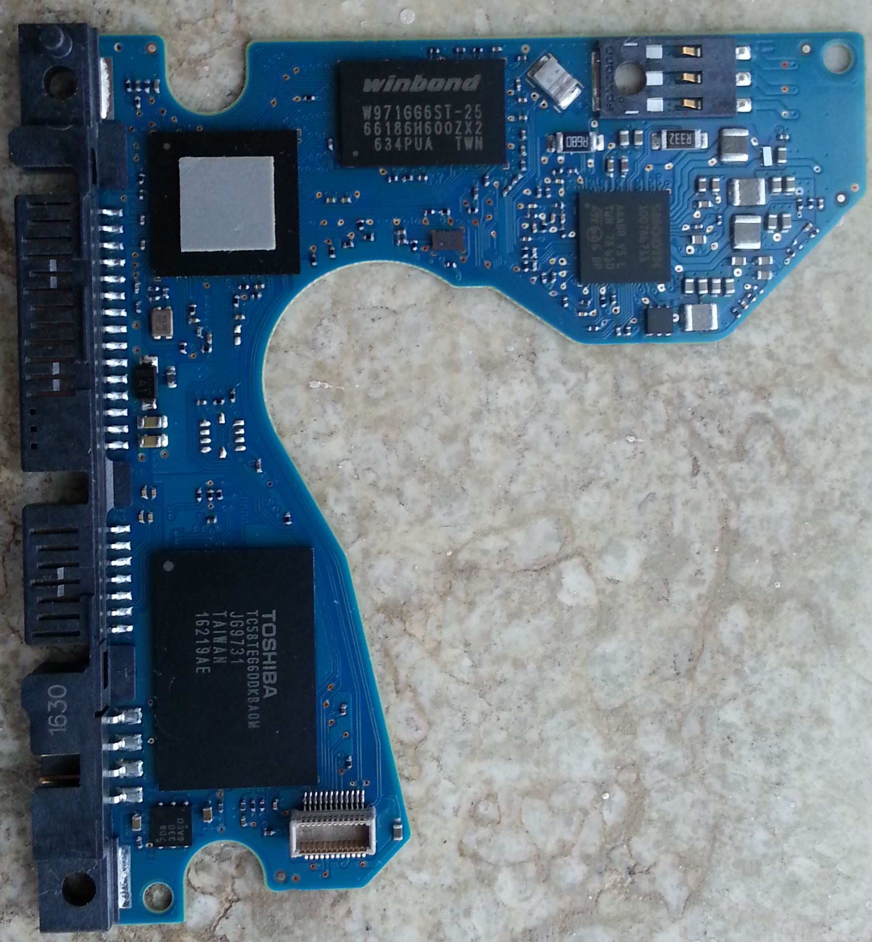

Can you upload a detailed photo of the PCB?

PCB.
I suspect the EEprom is near the connector for the terminal, but with 6 pins instead of the usual 8
I'm also going to disable the CE line for the nand, this might cause the PCB to think the nand is not fitted , since it cannot read the chip ID nd this might bypass the code and put it into an init mode

looks same as
viewtopic.php?f=1&t=35857
that pcb is serial eprom 25S81
MyPCB is 3A6K, is it the same serial eprom part or is there another supplier ?
ok looks like pogo pin time and a readup of the datasheets to see if I have a suitable emulator in my stable
and a big thanks for the amount of time you guys have saved me...fzabkar
Also the component marked "A1" is a TVS diode , not a fuse, it is clearly banded at one end (same as my pcb) and reads as a diode on a multitester.

3A6K is W25Q80BWBYIG.
    3A = W25Q80BWBYIG
    6 = year (2016)
    K = work week
W25Q80BWBYIG, Winbond, marking 3Axx, 8M-bit, 1.8V, serial flash memory, package WLBGA-8:

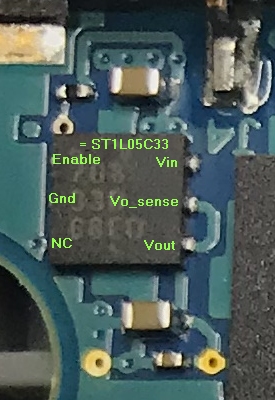

Are you able to find a firmware update at Seagate's Download Finder? It won't help you fix your problem, but the firmware modules may have some useful information. For example, it may tell us if the ROM architecture differs from regular F3 ROMs.
If you are so inclined, we could measure the onboard voltages for the benefit of others. I suspect that the 6-pin IC may be an LDO regulator. Perhaps disabling the NAND supply would achieve the same end as disabling CE?

Other Seagate SSHDs use an ST1L05CPU33R 3.3V LDO regulator to power the NAND flash. Its pinout looks very similar. Perhaps the NAND could be disabled by driving the regulator's EN pin low.
ST1L05CPU33R, ST Microelectronics, LDO regulator, 3.3V, 1.3A, marking 1L05C33, DFN6:
http://www.st.com/web/en/resource/techn ... 186925.pdf
Are you joking?
Take Kahuna drives for example (drives which are much more simple than Rosewood ones). If you know the field well, you might remember that the solution is far from hardware modifications. Why do you advice to do the things which 100% will not help? To make people spoil their drives?
 Post subject: Re: st1000lx015
PostPosted: January 12th, 2018, 8:43
Posts: 17323
How will disabling the NAND "spoil" the drive?
