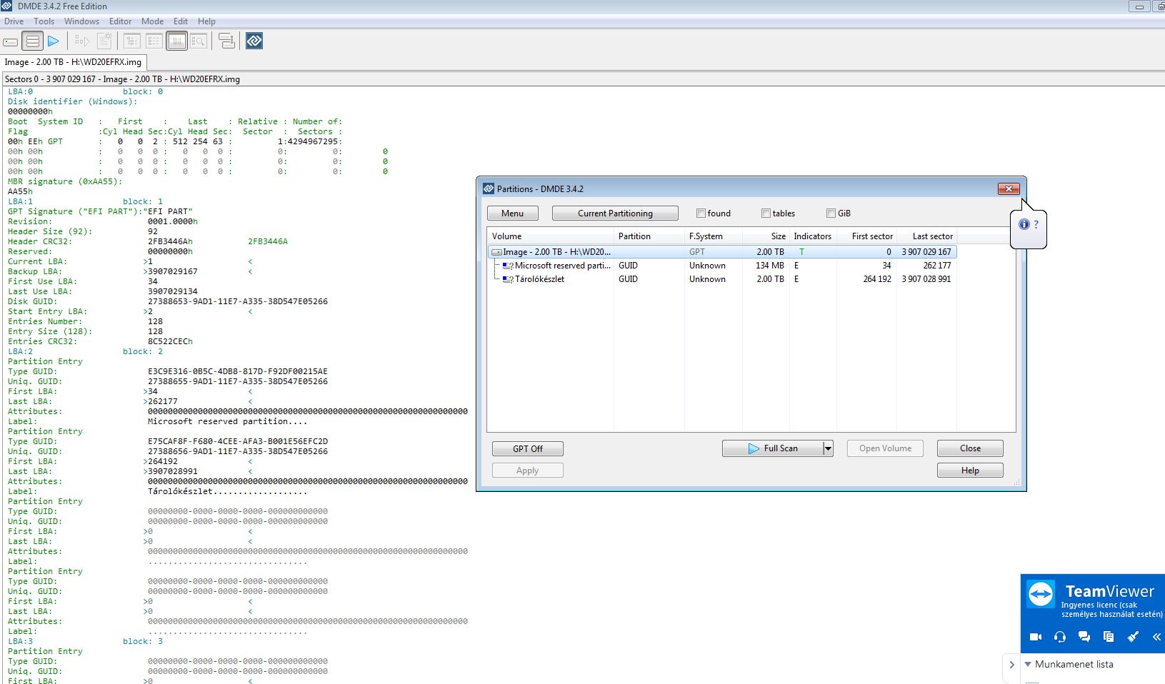

 Post subject: Accidentally formatted GPT protective partition!
PostPosted: February 3rd, 2018, 6:24
Posts: 331
Hi there!
I have a case that is faced me to a new problem.
The drive has a GPT Protective Partition. The user is accidentally formatted it.
I have imaged the drive, and scanned the whole drive with R-Studio, but it cannot found folder structure, but recognized the files by file type. The recognized partitions offset points are not correct. Get Data Back and ReclaiMe also did a same results.
When i scan only the formatted GUID GPT partition, then i see the root folders, but under these folders there are no subfolders or files, and the RAW recovery does not found any files.
Uhh...i need some help!
Thanks for any help!
 Post subject: Re: Accidentally formatted GPT protective partition!
PostPosted: February 3rd, 2018, 16:32
Posts: 17323
Could we see the Partitions window in DMDE?
https://dmde.com/
 Post subject: Re: Accidentally formatted GPT protective partition!
PostPosted: February 3rd, 2018, 17:22
Posts: 331
Could we see the Partitions window in DMDE?
https://dmde.com/
Ohh yes! Here it is!
Clipboard02.jpg [ 178.33 KiB | Viewed 6631 times ]
 Post subject: Re: Accidentally formatted GPT protective partition!
PostPosted: February 3rd, 2018, 18:47
Posts: 17323
DMDE doesn't find any remnants of the old partitions. :-(
 Post subject: Re: Accidentally formatted GPT protective partition!
PostPosted: February 4th, 2018, 12:03
Posts: 331
It looks like i can solve this case with DMDE......
