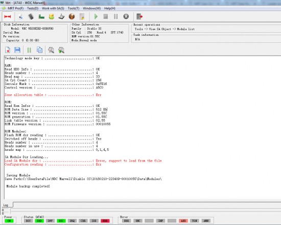

 Post subject: 2Tb WD HDD
PostPosted: February 10th, 2018, 13:29
Joined: August 20th, 2015, 9:00
Posts: 58
Technology mode key : ..........................: OK
RAM:
Read HDD Info : ................................: OK
Heads number : .................................: 4
Head map : .....................................: 33
SA Cyl Count : .................................: 256
Serials Mark : .................................: 0xFE16
Control version : ..............................: A5C0
Zone allocation table : ........................: Err
ROM:
Read Rom Infos : ...............................: OK
ROM Data Size : ................................: 512 Kb
ROM version : ..................................: 01.55C
ROM generation : ...............................: 01.55C
Link table version : ...........................: 02.55
ROM Firmware version : .........................: 00010055
ROM Modules:
Flash ROM dir reading : ........................: OK
Switched off heads : ...........................: Yes
Heads number : .................................: 4
Heads number in use : ..........................: 4
heads map : ....................................: 0,1,4,5
SA Module Dir Loading...
Load SA Module dir : ...........................: Error, suggest to load from the file
Configuration reading : ........................: Err
I need Data , please suggest next steps for recover data
mrta.jpg [ 363.7 KiB | Viewed 10589 times ]
 Post subject: Re: 2Tb WD HDD
PostPosted: February 11th, 2018, 2:39
Joined: August 20th, 2015, 9:00
Posts: 58
The Drive is keep Spinning
Users browsing this forum: No registered users and 79 guests
