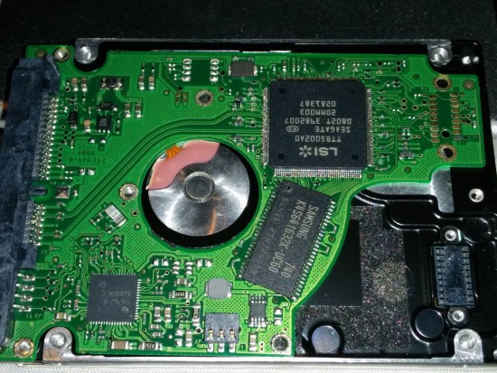

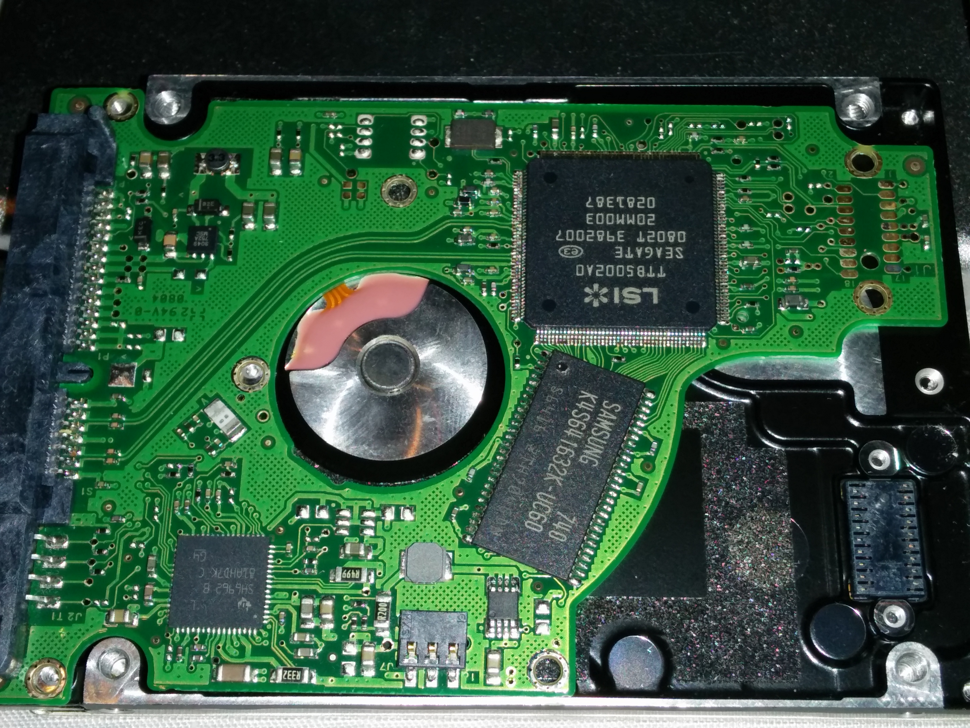

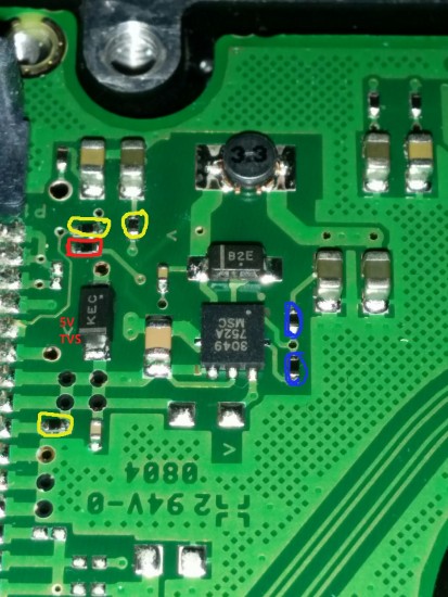

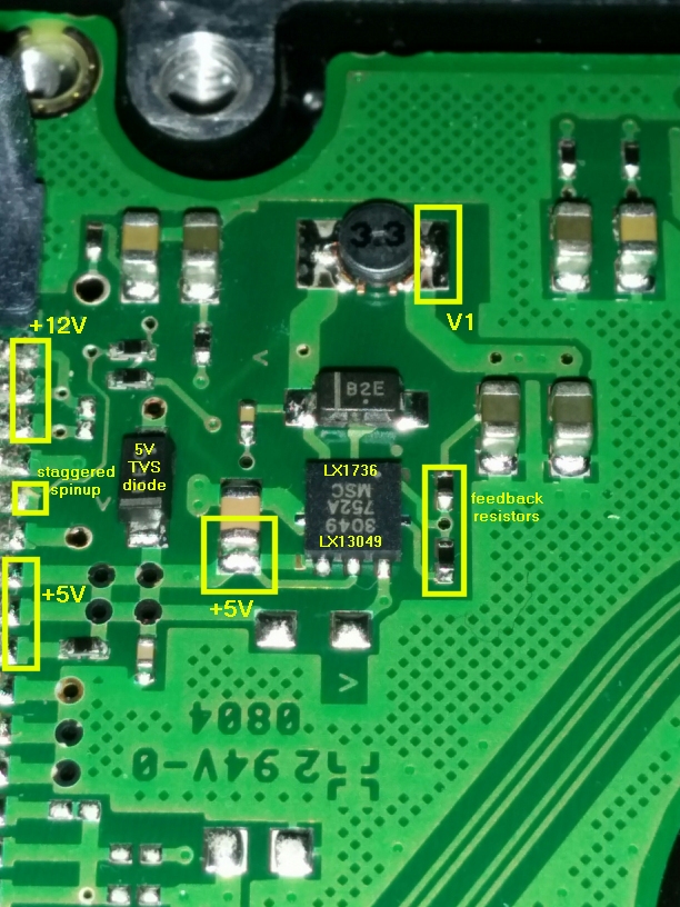

This is the a sata hard drive that have come into my workshop this week and presents as "DEAD/no signs of life".
I need help in fixing the PCB of this hard drive. I will try to explain as much as I know and what I am trying to find out.
First..... The Backstory:
The customer is not sure what happened to this drive exactly, but when he went to use it, the drive was DEAD. It came to me in a usb caddy. When the caddy is plugged in the led lights but no sounds can be heard from the hard drive. I removed the drive from the caddy and plugged it in to a PC PSU, but still no sounds/signs of life could be heard. That's all I know / don't know:
Seagate st9160821as (160GB 2.5" HHD)
[Picture A]
PCB serial #: 100398689 REV C
Components Tested:
none yet
This PCB has very few reference designators.
Any ideas where I should start testing? I think I should definitely test components on the 5V circuit, as this drive has only been used in an usb caddy.
Should I be testing components on the 12v circuit too?
Thanks for any help you might give.

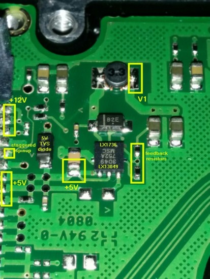

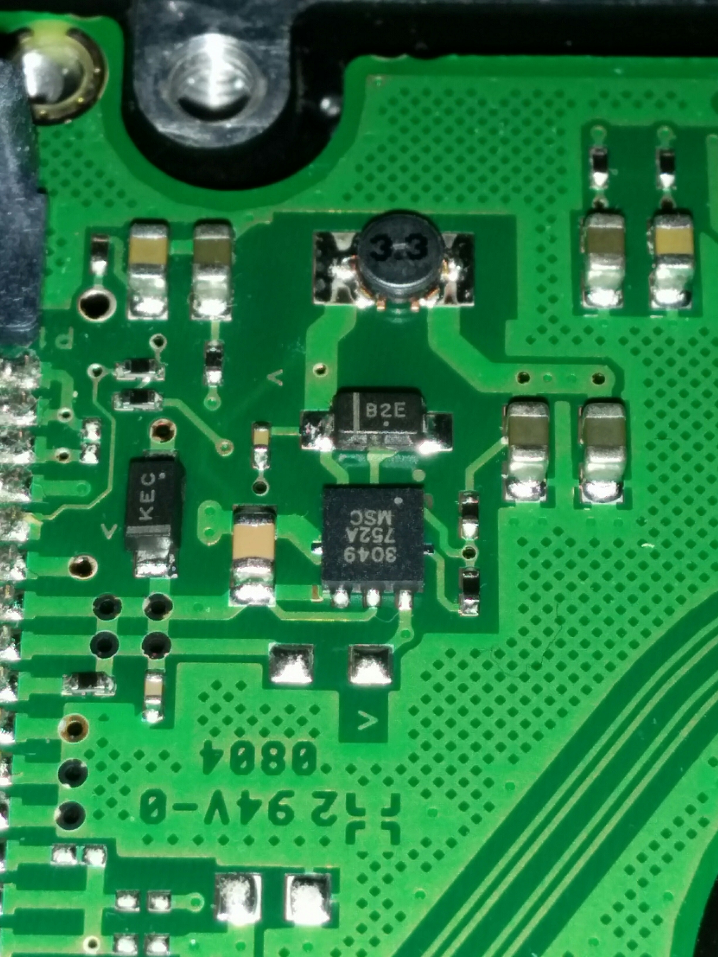

The drive is a 2.5" model, so it would have no 12V circuit. (The power specs should be on the label.)
The "KEC" part would be a 5V TVS diode. I expect that yours would be OK. If it were shorted, then your PSU would shut down.
Does the drive make a faint noise as if it is trying to spin up?
If you could upload a full photo of the PCB, I could help you locate the voltage test points.

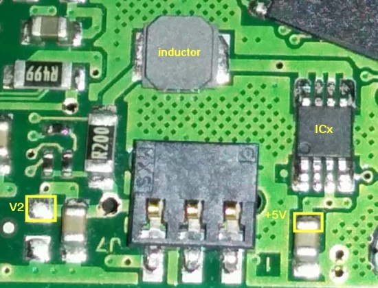

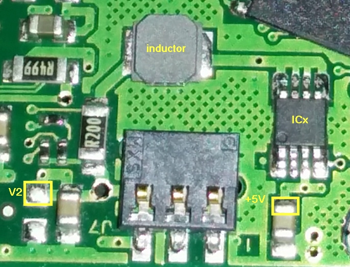

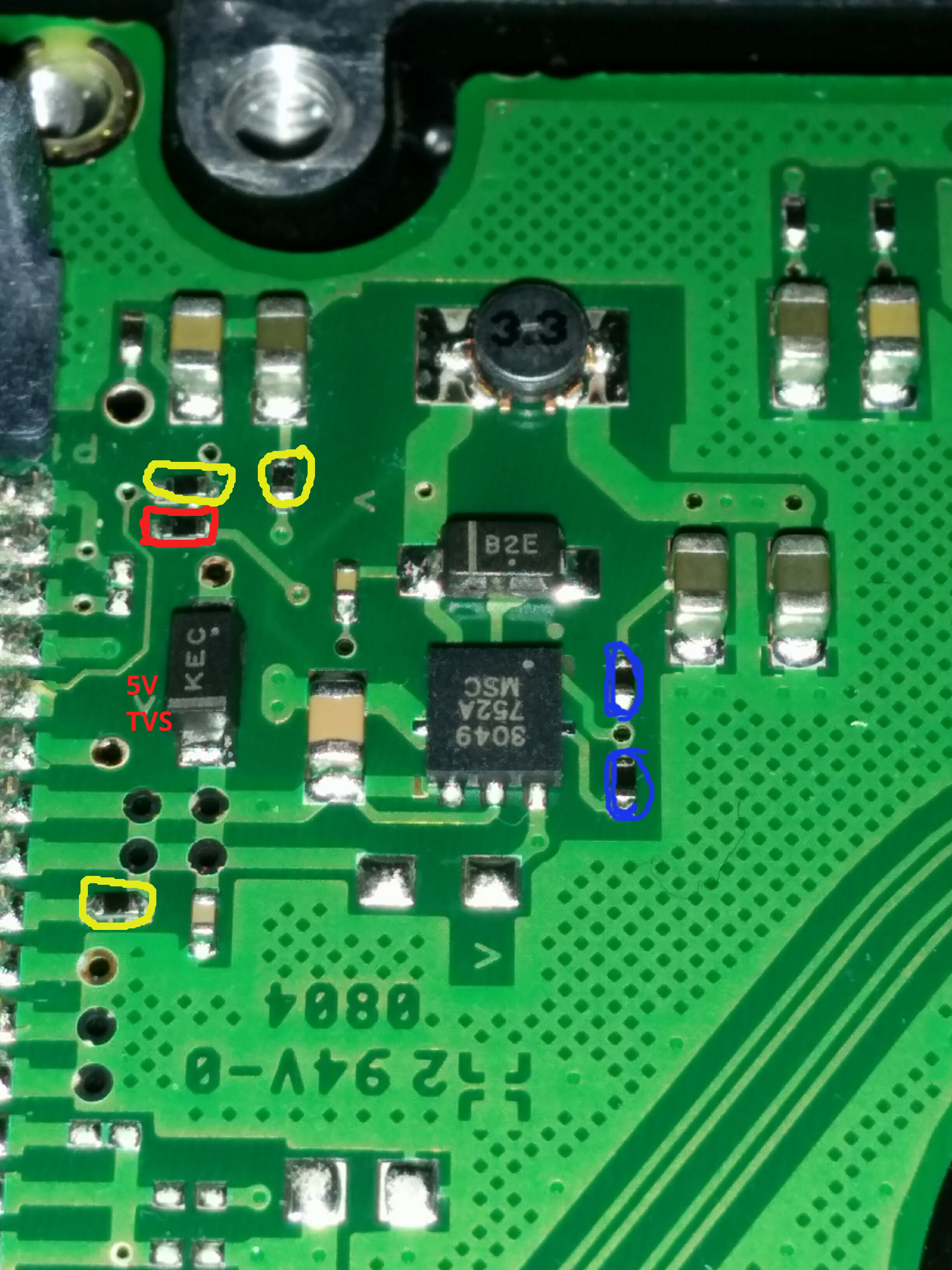

I have attached a photo showing the full pcb. also I have attached an annotated photo of part of the pcb.
I have done a little testing. I have tested the components circled in red, yellow and blue; which I believe are all 0 ohm resistors. Am I correct?
The 3 yellow components have continuity, but the red one doesn't. Is the red one faulty?
The blue components tested for continuity, but only if you put one of the probes on one side of the component and the other at a point further along the circuit.
In answer to the question of if feint noise can be heard, the answer is absolutely no noise can be heard.

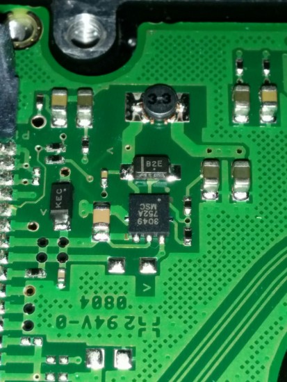

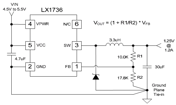

Can you measure the voltages at V1 and V2? Can you tell us the markings on ICx?
BTW, Microsemi uses the same marking for two different part numbers, but the ICs are functionally identical.
LX1736, Microsemi, marking 3049, 5V, 1.25A, 1.0MHz, PWM/PFM STEP DOWN REGULATOR, 4.5V - 5.5V in, 6-pin:
https://www.microsemi.com/document-portal/doc_download/9056-lx1736-datasheet
LX13049, Microsemi, PWM Buck regulator, 1.25A, 6-pin, marking 3049:
http://www.microsemi.com/document-portal/doc_download/125237-lx13049-datasheet
https://www.microsemi.com/document-portal/doc_view/125237-lx13049-datasheet

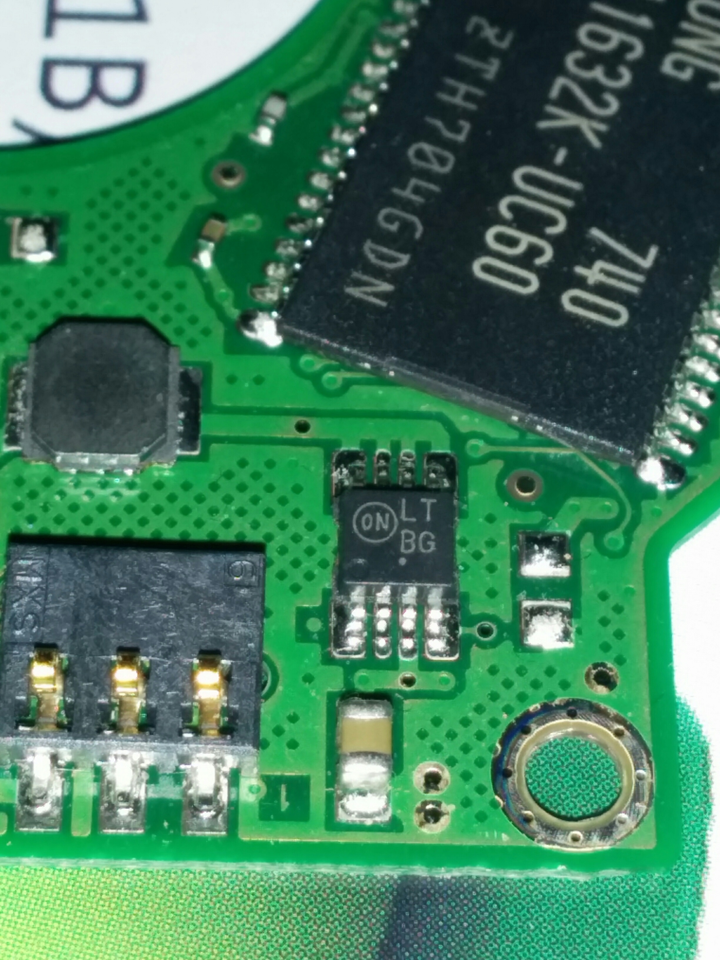

Hi
Thanks for the help.
I have tested the drive and here are the results:
Voltage readings:
V1 = 3.383
Large CAP to left of LX1736 chip = 4.773
V2 = 1.250
Large CAP below ICx chip = 4.777
The markings ICx are: ON LT BG
I have attached a photo of the ICx chip.

Vcore (1.2V) and Vio (3.3V) are OK.
Try to obtain a terminal log from the drive's serial port. You will need a USB-to-TTL adapter.
NTTD4401F, ON Semiconductor, FETKY P-Channel MOSFET & Schottky Diode, -20V, -3.3A, marking BG:
https://www.onsemi.com/pub/Collateral/NTTD4401F-D.PDF
