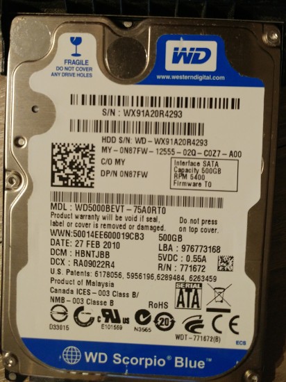

First time poster (please have mercy), just looking for some help.
So I was sent a Western Digital Scorpio Blue WD5000BEVT 500GB HDD that is no longer operable in hopes of possible data recovery. This thing is probably 6-8 years old, was in a 20-year-old's Dell laptop during that time, and rarely backed up. The circumstances of the failure are unknown (I believe "it just stopped working" is the best we're going to get).
Here's what I do know: it does not have any of the tell-tale signs of a head-crash or major physical damage. That's literally all I can tell you.
I am using a SATA to USB adapter to connect this to a few laptops I have lying around to poke around the drive (I know, probably a bad idea).
Every time I have plugged this thing in, it is unable to interact with host system. Windows Explorer crashes, anything attempting to read hard drives (Acronis, EaseUS, OnTrack, about a dozen others) all hang and crash when this drive is plugged in, or they do not start at all if I attempt to launch the utilities with the drive connected.
I have a bootable USB drive with linux, DOS, and Windows-based utilities and for these types of occasions, and it has been equally stumped. Nothing can interact with this drive; I can't clone it, I can't scan it, I can't check it. Again, it spools up just fine and seems to be humming along the whole time, but my bag of tricks has come up short.
Some things I tried:
- Disabled automount in Windows to see if that was interfering (it wasn't; diskpart still froze)
- Every disk and data utility I could get my hands on, in Windows, DOS, and linux
Things I still want to try:
- Connecting it to another laptop to replicate the results.
- Connecting it via SATA to compare performance.
If anyone has ideas on where I could start with this, I would greatly appreciate the insight. I'd at least like to be sure that there's no hope before throwing in the towel. Thank you for any help!

Most likely weak head/s and/or slow response.
Unfortunately, in both cases the drive will not working again. If data is important seek for the nearest DR firm near you.
good luck

Spildit wrote:
ADHDD wrote:
I am the hard drive owner's friend. She sent it to me because I like to troubleshoot things.
You need tools. Start with something like MHDD and check if the drice can be picked up (ID) by MHDD or if it's stuck on BSY.
Does it spin at all ? I guess so.
Does it make clicking sound ? I hope not ....
If MHDD can pick up the drive and it's not stuck on BSY try "smart att" and check if you have pending sectors and re-located sectors. If the drive is stuck on BSY and you can't ID then just guive up. You will need to block SA access to go any further and it will not be a simple mission.
If MHDD can still ID the drive and "scan" it (verify) you might be able to apply a slow fix with something like WDMarvel or HDDSuperTool and clone the drive with HDDSuperClone ...
Great! Thank you so much for this!
Yes, it spins up just fine, no clicking, no "attempts" (spooling up, then spooling down, then back up in a loop). It spools up and hums along like any other drive.
I will look into MHDD and get back to you.
