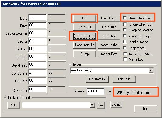

 Post subject: HRT DEMO only 512 bytes buffer
PostPosted: May 17th, 2018, 15:27
Joined: May 12th, 2018, 21:58
Location: Argentina
Hi, how can i make HRT DEMO to receive more than 512 bytes buffer when i click on get buffer button in ATA Terminal with more than 1 sector count register.
Besides when i run a script i only get the first 512 bytes per module.
Should i configure a .INI file for my HDD to recognize the buffer size? Which file?. It is for an OLD WDC WD400LB.
Thank u.
 Post subject: Re: HRT DEMO only 512 bytes buffer
PostPosted: May 17th, 2018, 18:16
Joined: May 12th, 2018, 21:58
Location: Argentina
Hey Spildit, i have learned a lot because ur posts in HDDOracle since weeks before posting something, but i can't register ur site because that question on bottom :(
About my HDD, it is a WDC Cyl 32 Xenon WD400LB 00DNA0 that i would like to "play" and learn with.
My HRT DEMO is version 2.10 (i downloaded it from hddoracle) and im using allowio portalk in windows xp sp3 (windows98 compatibility). The program runs good.
This is what i get when i want to retrieve any module bigger than 512b ( GO! then get buffer or GO -> Buff):
hrtbuffer.JPG [ 42.9 KiB | Viewed 21564 times ]
btw, i already retrieved all the modules and tracks with MHDD 4.5 and WDC Scripts Generation but i prefer HRT cause is more comfly i guess.
Can u tell me whats wrong and what should i edit in .INI file to change (INI Section: BAD) in the Universal window?
Later, i would like to post my "experiments" with this drive too.
Thank u.
 Post subject: Re: HRT DEMO only 512 bytes buffer
PostPosted: May 17th, 2018, 21:48
Joined: May 12th, 2018, 21:58
Location: Argentina
Hi, yea i used WDC super on before reading but still with Standard ATA Command read w/o retry is the same.
BTW i can retrieve the entire sector count buffer but 1 sector at time (512 bytes). In this example 8 clicks x get buffer button.
Now this happens if "Read Data Reg" box is unchecked:
File comment: FIRST CLICK ON GET BUFFER BUTTON
hrt1click.JPG [ 75.11 KiB | Viewed 21511 times ]
File comment: SECOND CLICK ON GET BUFFER BUTTON
hrt2click.JPG [ 74.72 KiB | Viewed 21511 times ]
With the second click i get the rest of the buffer. ?????
 Post subject: Re: HRT DEMO only 512 bytes buffer
PostPosted: May 18th, 2018, 16:33
Joined: May 12th, 2018, 21:58
Location: Argentina
Hi, is fixed. I just disabled "IDE Prefetch Mode" in BIOS and now HRT works good. Thank u very much Spildit for ur help. :)
Time to test and "play" with this drive.
Users browsing this forum: Google [Bot] and 26 guests
cron
