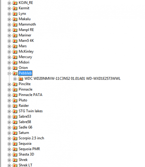

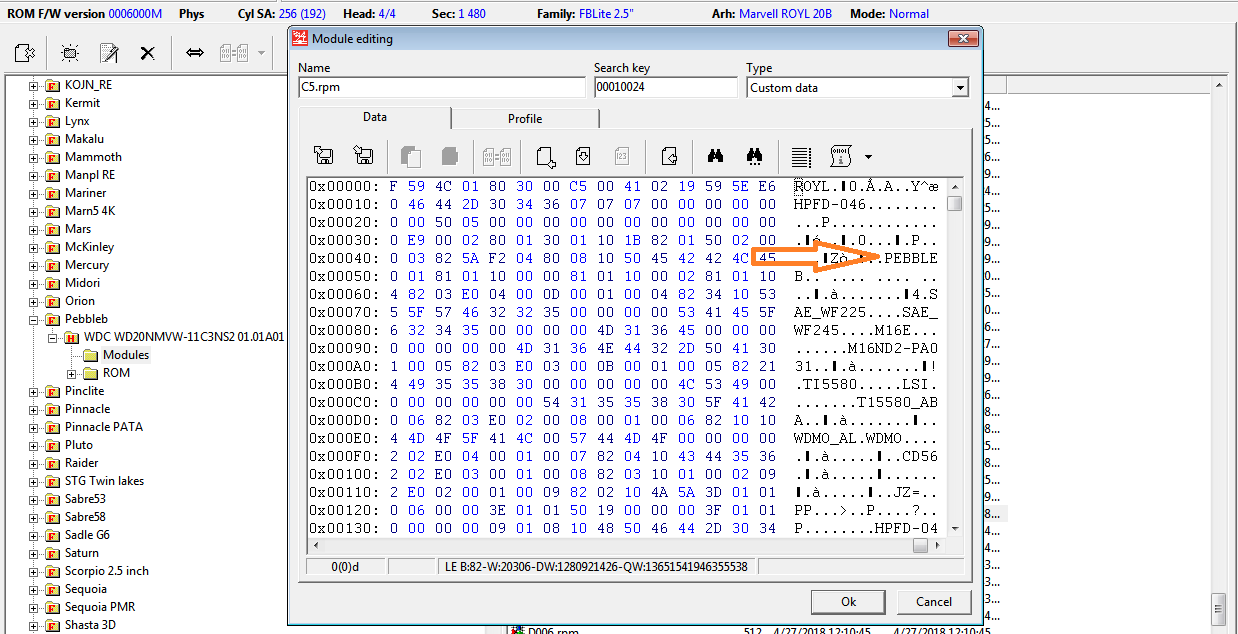

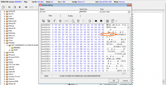

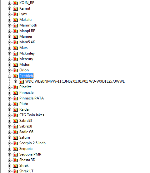

strange why pc3k detect it as Pebbleb ?

I'm confused. These excerpts are from a WD30NMVW-11C3NS2.
C5.rpm
00000000  52 4F 59 4C 01 80 30 00 C5 00 5F 02 91 44 EE C5  ROYL.€0.Å._.‘DîÅ
00000010  48 50 46 44 65 30 34 37 07 07 07 00 00 00 00 00  HPFDe047........
00000020  00 00 00 E0 05 00 00 00 00 00 00 00 00 00 00 00  ...à............
00000030  00 80 E9 00 02 80 01 30 01 10 1B 82 01 50 02 00  .€é..€.0...‚.P..
00000040  01 00 03 82 5A F2 04 80 08 10 50 45 42 42 4C 45  ...‚Zò.€..PEBBLE
00000050  42 00 01 81 01 10 00 00 81 01 10 00 02 81 01 10  B...............
11.rpm
000A12F0  00 01 00 00 00 00 00 00 00 01 57 44 43 20 52 4F  ..........WDC RO
000A1300  4D 20 4D 4F 44 45 4C 2D 50 45 42 42 4C 45 42 2D  M MODEL-PEBBLEB-
000A1310  00 00 20 20 20 20 20 20 20 20 20 20 20 20 20 20
000A1320  20 20 20 20 20 20 20 20 20 20 20 20 20 20 20 20
000A1330  20 20 20 20 20 20 20 20 20 20 00 01 20 20 20 20
000A1340  20 20 20 20 00 01 00 00 00 00 00 00 00 00 00 00
02.rpm
000000F0  06 00 60 0B 3B 00 9B 0B 2B 00 00 01 57 44 2D 57  ..`.;.›.+...WD-W

mrtpro wrote:
MindMergepk wrote:
can it decrypt PeblleB family drives ?
Hi, PeblleB family is SATA HDD.
Email: sales@mrtlab.com
Skype: sales@mrtlab.com
QQ:3292109557
It is strange that MRT guys said Pebbleb is a Sata Drive.
