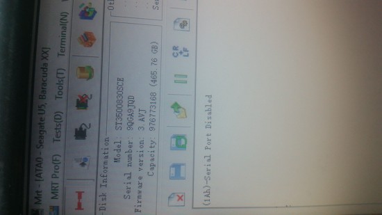

Hi I have seagate 3.5" classic series 500gb hard drive. Puis enabled on it. Tried MRT and HDAT2 for disabling. While trying to disable PUIS by MRT it gives error and do nothing. And after power off on the drive still goes to same condition i.e does not spin.

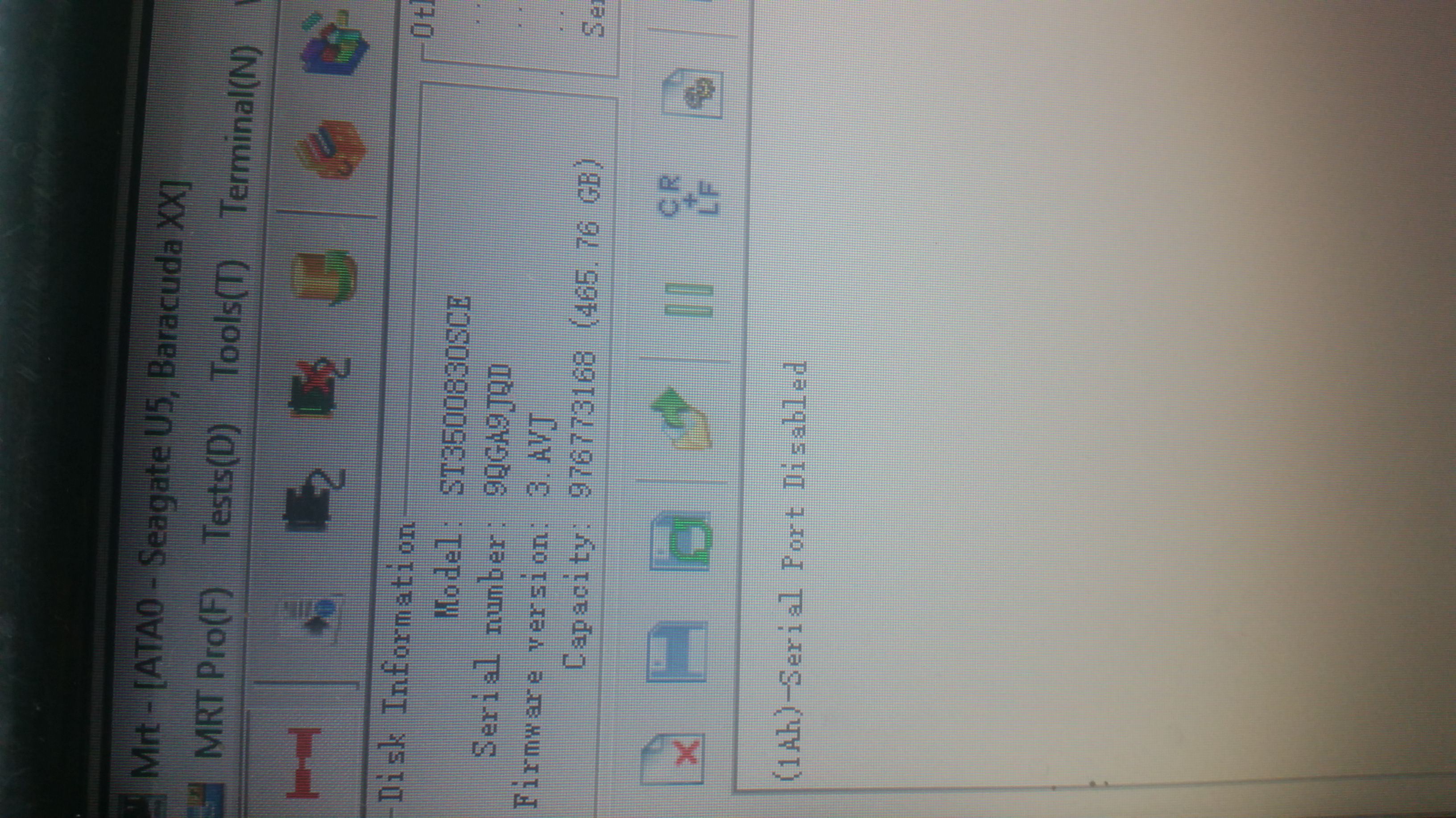

Patient drive serial port disabled.not working with terminal.

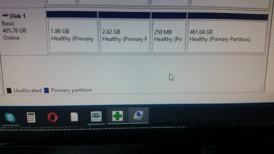

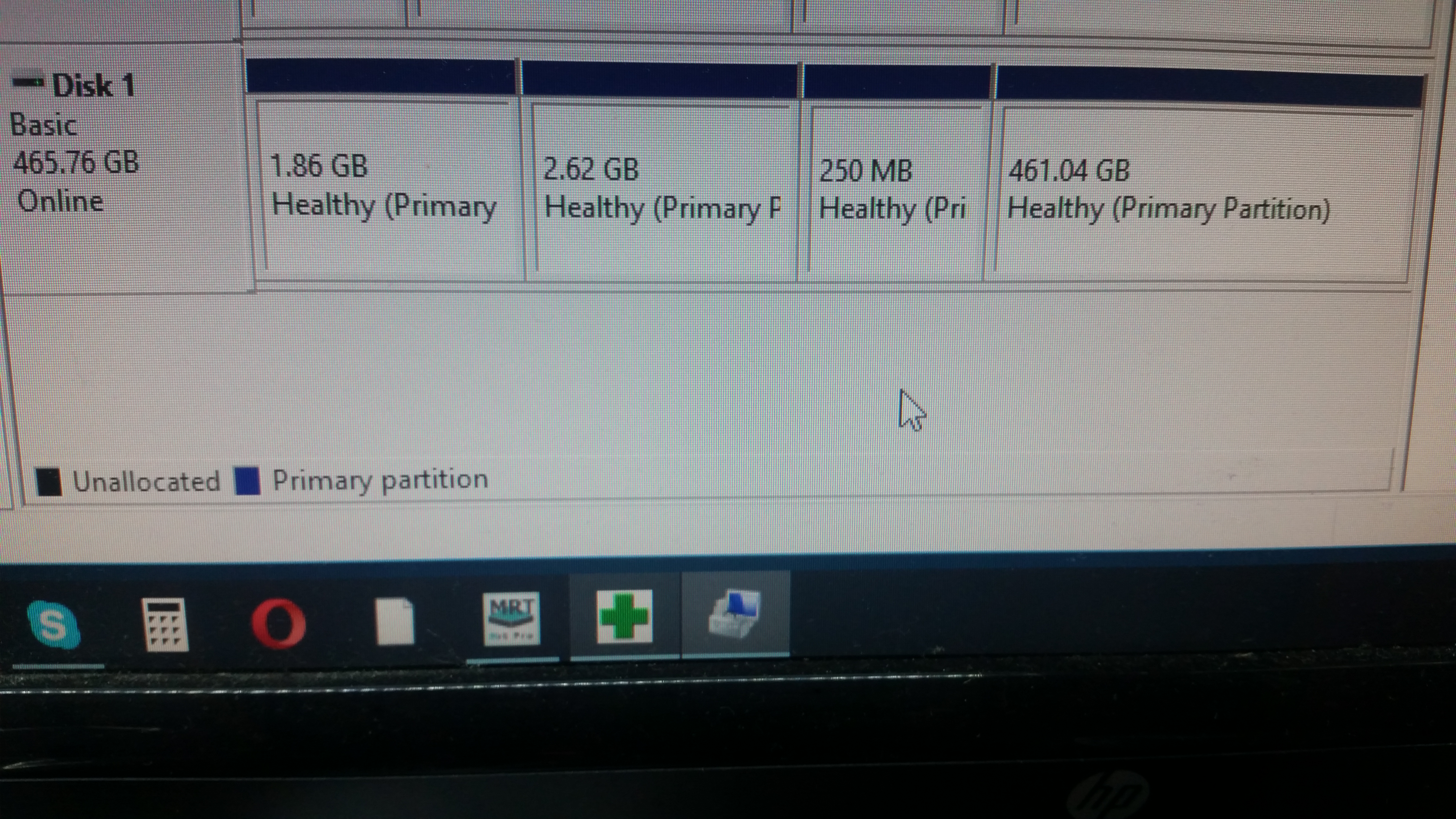

Yes you are right fzabkar. Its not SED. Seems that its full disk encryption with seagate drive trust technology. Below is the partition detail in image.
But the drive can be repair if we change the fw. Will pay the fee if anyone can help me in this regard.

Sorry, I was confused. I thought that your were unable to get your drive to spin up. Now it appears that standard ATA commands (Set Features or Read/Write Sector) will spin up the drive, it's just that you cannot disable PUIS using standard ATA methods.
Your latest screenshot suggests that you have no problem with data access once your drive spins up, so it is not "locked" in that sense. Therefore ISTM that you need to locate the PUIS flag bit/byte in your ROM and flip it. To this end I would obtain an "unlocked" DB35.3 drive and compare its ROM images before and after enabling PUIS.
