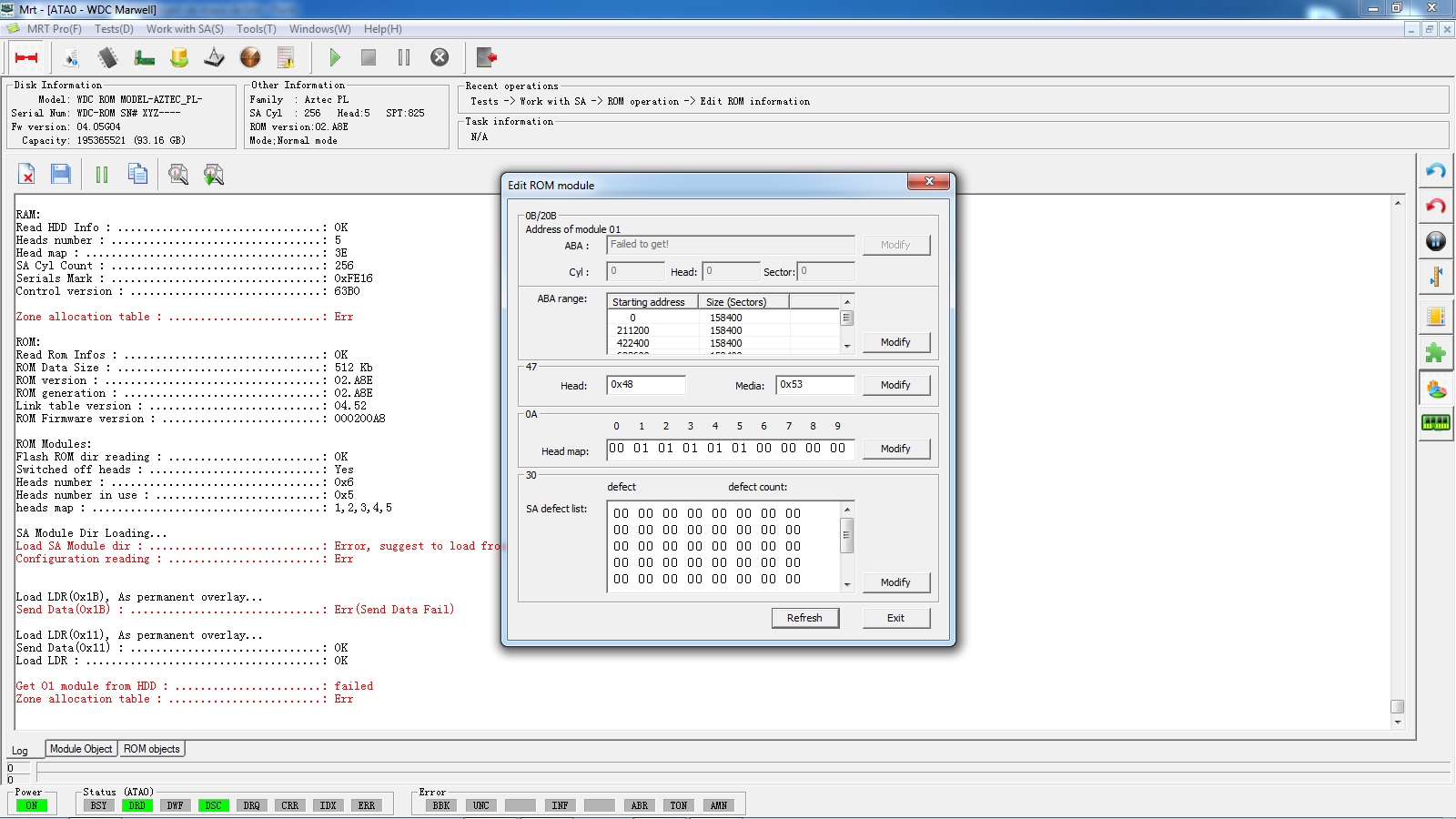

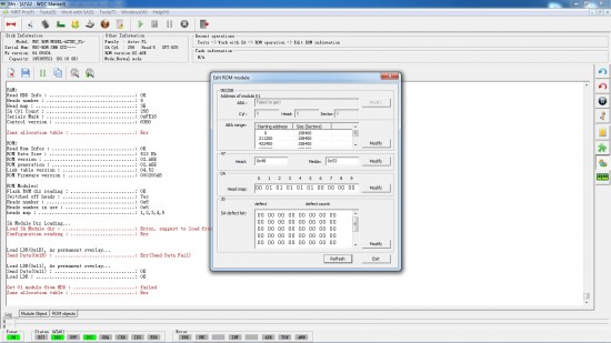

Hi.
I have an HDD that I have formatted the SA.
In order to write the SA again I have loaded the LDR and I have written it by track.
Now the problem is that it does not find the 0x01 module when the disk is booted, but if I load it manually and the LDR, I have access by ID, ABA and TRACK.
What I want is to edit the address of module 0x01, in the ROM, but it does not leave me the option to edit the address.
Greetings.

Can you upload the ROM and module 01?

By ID I do not read the modules, just by track and ABA
 Post subject: Re: EDIT 0B/2B DISABLE
PostPosted: August 17th, 2018, 18:24
Posts: 17215
ROM module 0B is the active directory. It points to ABA 0x1171F as the location of module 01.
Module 01 points to the same ABA:
12 02 01 00 18 00 03 18 90 00 1F 17 01 00 1F 17 01 00
What do you see at ABA 0x1171F?
PostPosted: August 17th, 2018, 18:47
Posts: 474
Location: spain
I pass you the track -170.
Right now I do not clarify but it seems to be this:
ABA 0x1171F : -170 HEAD 0 OFFSET 0x1FA -> seems to point to the module 0x01
OFFSET FILE -170 IS 3F200
Sorry if I was wrong in something.

better give a screenshot about ROM module 0B 20B where the address of module 01 is stored, or I can help you directly via remote

The address recorded in 0B 20B contradicts against each other , we can fix this issue by modifying its address. Perhaps the module recording the addresses malfunctions or something else, but no big an issue

Rectification :
ABA 0x1171F : -170 HEAD 0 OFFSET 0x1F9 -> seems to point to the module 0x01
The sectors are numbered from 0.
I'll study the case a little more and I'll tell you.
I return to comment what I did:
             Format the SA
             I write SA by track.
and the problem in question arises.

It may be that the problem that I have committed is to format the SA, without having synchronized the SA translator, for that reason I believe that it does not find the modules by ID, and when loading the module 0x11 I can operate by track and by ABA.
I'm trying to format the SA synchronizing the translator but I get an error.

I have now formatted all the tracks of the SA and recorded the tracks but it remains the same.
Could it be the translator of the SA?
PostPosted: August 18th, 2018, 17:14
Posts: 17215
IIUC, module 0x35 is the defect list for the SA. Module 0x30 in the ROM is the translator for the SA.
ISTM that an SA format would identify any defects, and these would then need to be written to mod 0x35. Regenerating the SA translator should then update mod 0x30. ???
You could try to edit mod 0x20B (and recalculate its checksum), as suggested by @reco, but I would be surprised if this made any difference. I'm prepared to be proven wrong, though.
PostPosted: August 18th, 2018, 17:28
Posts: 474
Location: spain
Then if I'm not wrong:
ABA = (HEAD * SPT * MAX_CYL) + [SPT * (MAX_CYL + TRACK)] + OFFSET
Being the negative track
HEAD = ABA MOD ( SPT * MAX_CYL )
TRACK = [ABA - (HEAD * SPT * MAX_CYL) ] MOD SPT - MAX_CYL
OFFSET = ABA - (HEAD * SPT * MAX_CYL) - [SPT * (MAX_CYL + TRACK)]
If I'm not mistaken
Also, until module 0x11 is loaded, it can not read by track or ABA, as it happens in my case.
